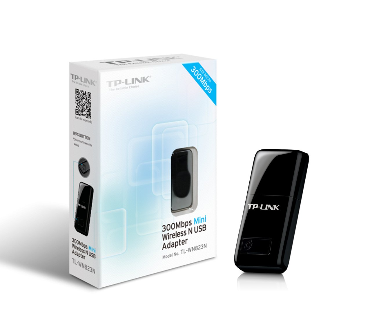

USB WIFI - Adapters
I used one of those on an old laptop when the built in WiFi failed. It worked better than the built in one ever did.

It really depends on how good the signal from the BT box is at the location you intend to have the new PC. I have a similar one I bought as an emergency replacement, which gave me barely 36Mbps throughput on a router capable of 300Mbps; the problem is that there is no room for a decent antenna.
For less money (but much longer delivery - from AliExpress), I got an "EDUP" USB dongle, 2 x ~8" antenna and a 1m extension cable; in exactly the same position as the tiny TLPlink, it gets 224Mbps throughput. If you go down this route, DO NOT use the supplied software driver - it is carp, let Windows detect and install a generic one.
Dont get me wrong, I love TPL stuff, my Fibre router is a TPL, but all of those tiny dongles have the same problem, no antenna.
Neither are as good as the old TPL PCI card though, before it died it ran at the full 300Mbps (with 12" antenna added to replace the originals).
I've that USB adapter -it's OK but needs a strong WiFi signal. I would go for a powerline adapters as well.

Get an app on your phone that shows wifi signal info and put your phone where the PC is going to go. It will give you a rough idea of how strong the signal is there.
If it's pretty strong then that adapter will be fine. If it's on the weak side you can get other USB adapters with external antennas on that may be better.
