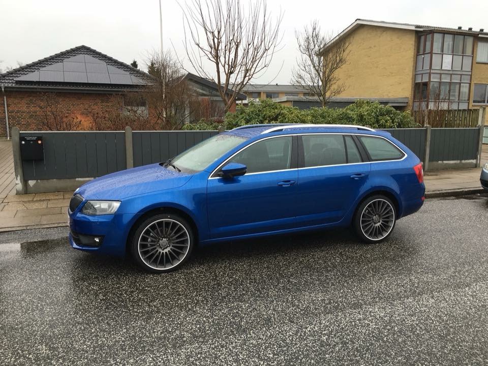

Could this rims/tires fit on my Vrs.
8.5x19 ET 45 with 245/35/19 tires?

8.5x19 ET45 with 225/35/19 is a perfekt fit.

Just about to order a set of these in 8.5x19 ET45.  They only weigh 9kgs!
