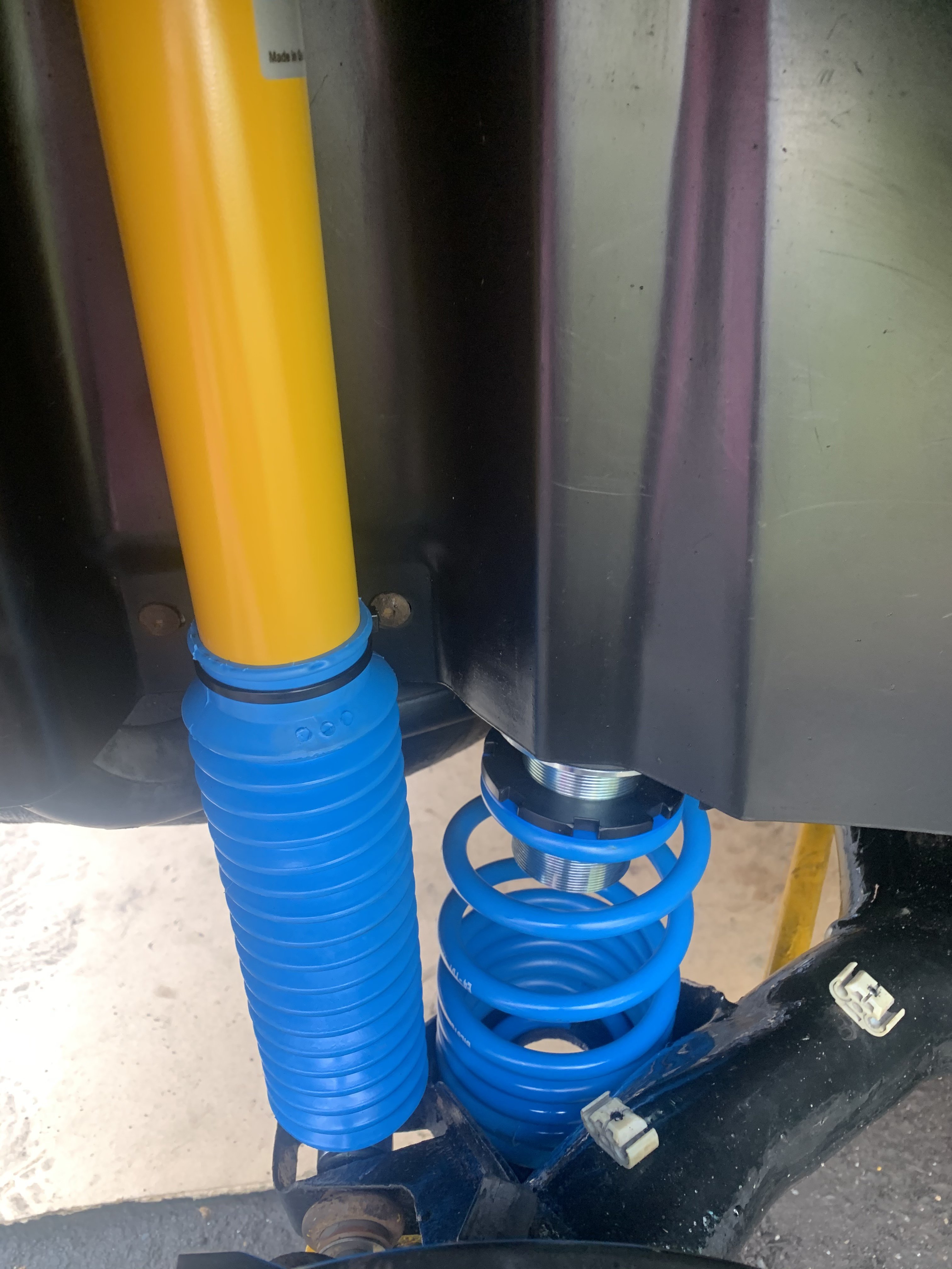

The yellow vRS is fitted with the Bilstein B14 coilover kit which for those of you who have seen it, has the height adjusters on TOP of the rear spring, between the spring and the body. Ever since I fitted the kit, and despite the adjusters being wound all the way to their lowest setting, it looked a little high on the back.
I ordered from TPS a pair of new rear spring rubbers, and set to work the other evening. I lowered the rear beam down and removed the Bilstein rear springs and height adjusters, replacing them with the new OE rubber mounts. Fitted like a glove and has now lowered the car by about 25mm. The springs are still held in tight between the rear beam and the body, so no danger of being too low.
I still have a access to the Black vRS which I sold to a friend so I was able to ask him to measure up the height of the top of the rear arch from the ground, and now the yellow one is EXACTLY the same as that. That car was lowered on some cheap Stance + coilovers and the height was always bang on in my mind.

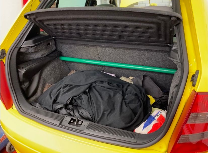

In the meantime I have sourced a bolt in rear strut brace (purely because I like the cosmetic look of it....) and had it powdercoated in RAL 6029 (mint green) This matches the calipers perfectly, so that has been fitted.
Excuse the pile of corruption in the boot... :blink:

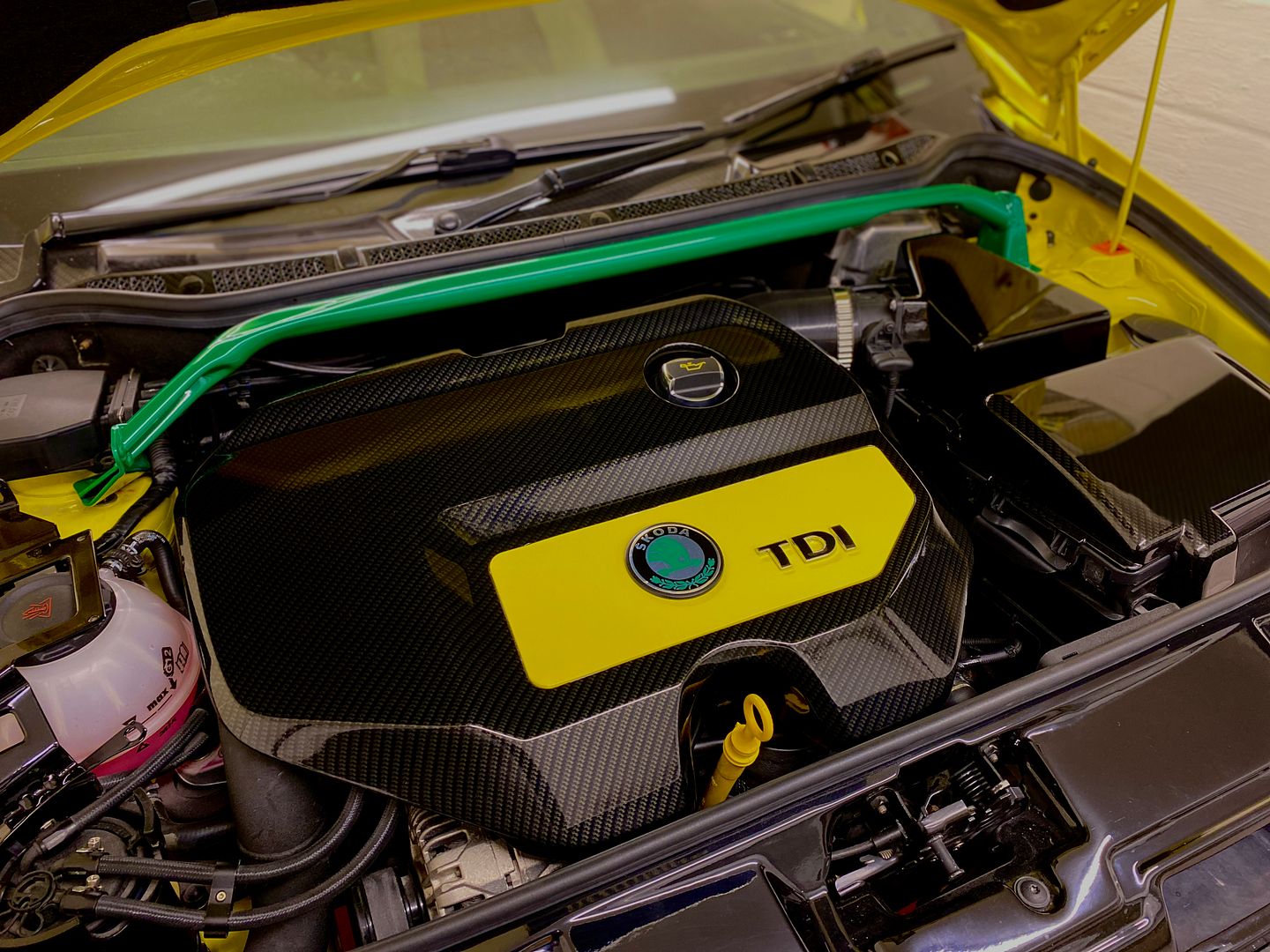

Whilst at the mercy of the powdercoaters, I decided to have the front strutbrace done to match as it will provide a splash of colour in the engine bay.
Please note the front brace isn't fitted properly, just popped roughly in place to take a pic, as I've got to strip a bit of the engine bay back out it made little sense bolting it down fully.

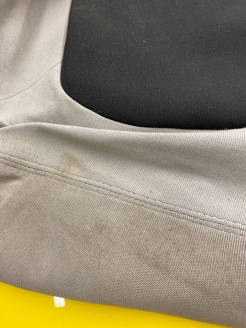

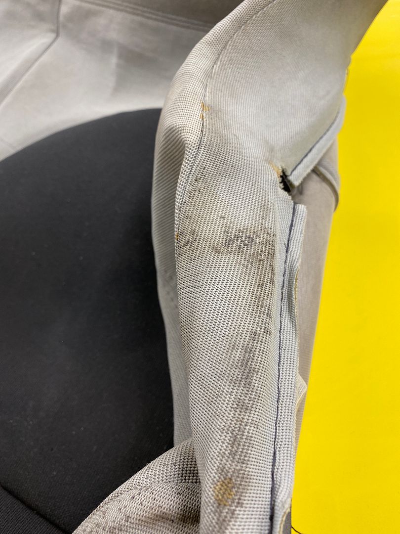

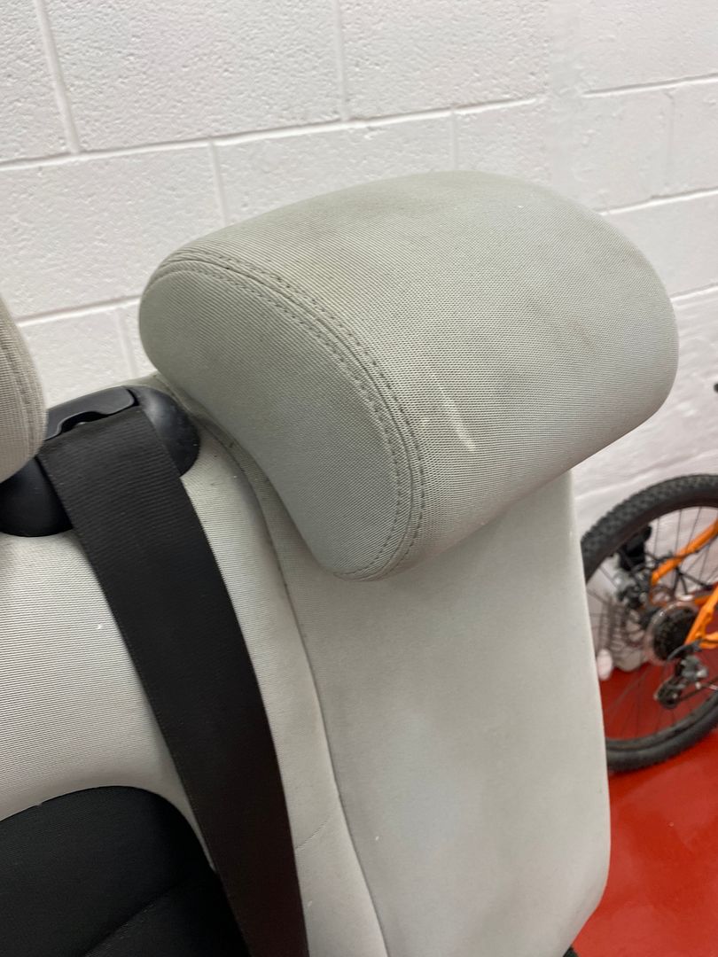

A while ago, prob 2 years tbh, I found a seller on facebook with the rare rear seat with the middle rear headrest option. Middle of nowhere in wet wales I picked it up for not a lot of money (£30 from memory) and stored it in the loft, I knew it was grubby and would need a deep clean so that's what else I've been doing.
Before...
Grubby but not holed or damaged thankfully. I did toy with the idea of stripping the material off the seat and washing it but the backrest looked possibly the hardest to do so I cleaned it in one piece. Using my trusted Autosmart Bio-Brisk interior shampoo, a splash of Bilt Hamber surfex in with it, I set to scrubbing the seat then extracting using very hot water in the extraction machine.
After one pass...
In all it has taken four sessions of scrubbing, extracting and drying to get it clean...
Nearly 100% dry now so can be fitted into the car this week.

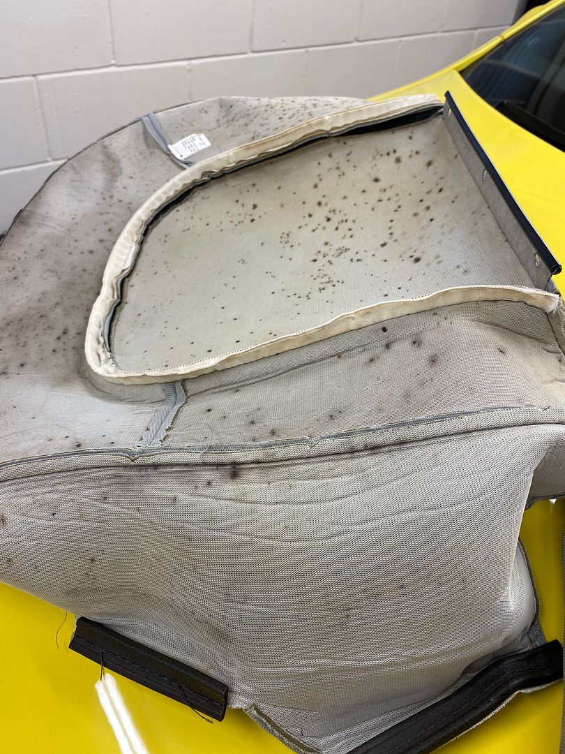

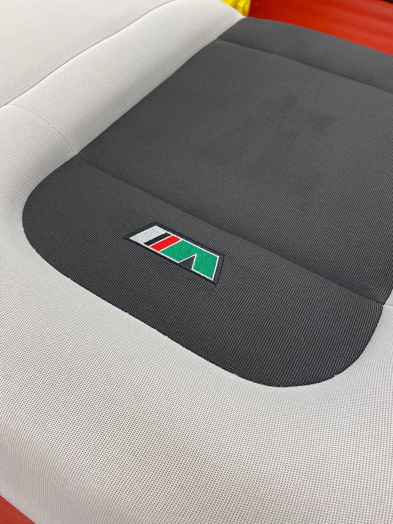

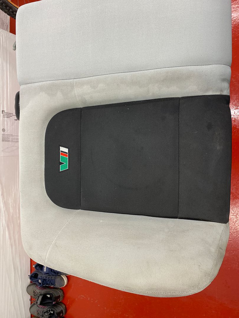

Now I was left with the rear seat squab and other back rest of the used manky seat I bought, so I have stripped the upholstery off the seat bases just now in readiness to machine wash. Not a pretty sight...
These are currently having a good session in the washing machine at 40c so i'll see what they come out like. I suspect they will need to be washed again to get all the filth off. The water and suds in the machine was brown. And the missus noticed....
Once they are clean and dry i'll put them away somewhere safe for a little side project I have planned..... (watch this space)
