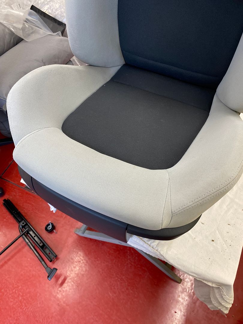

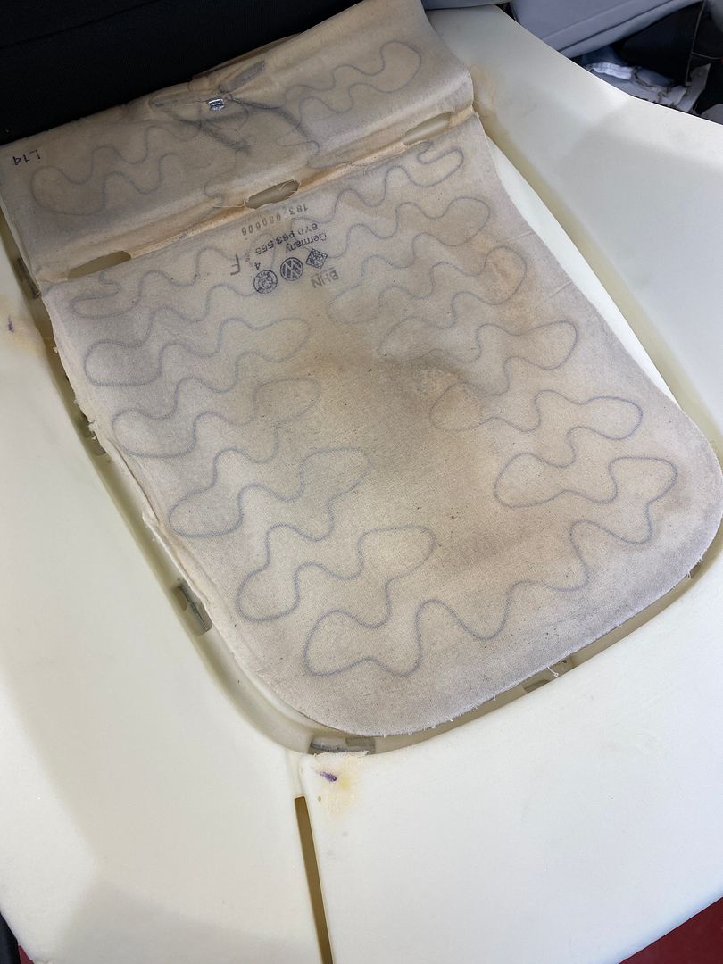

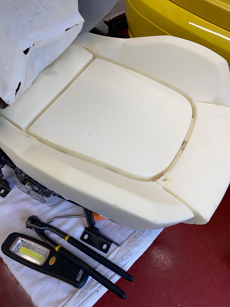

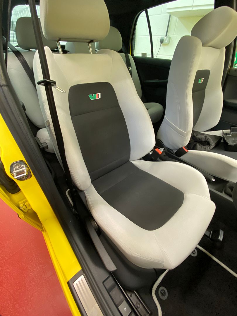

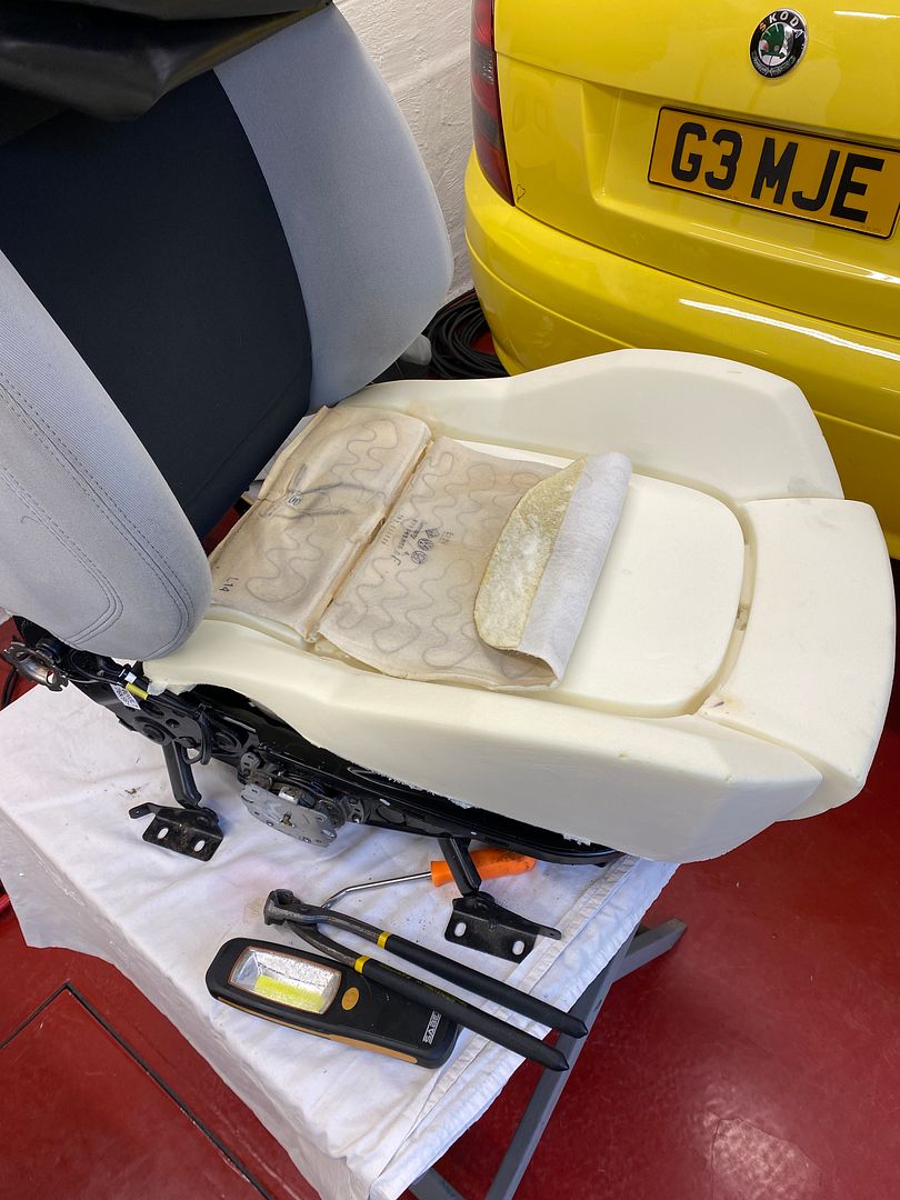

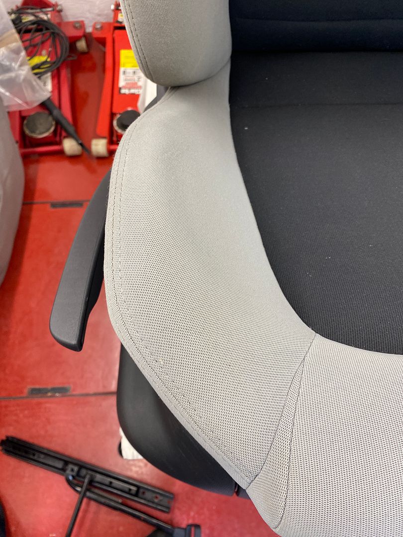

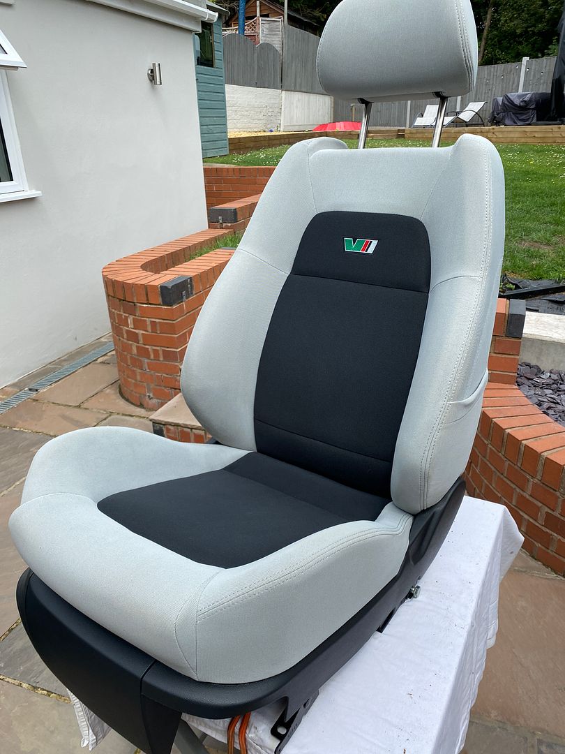

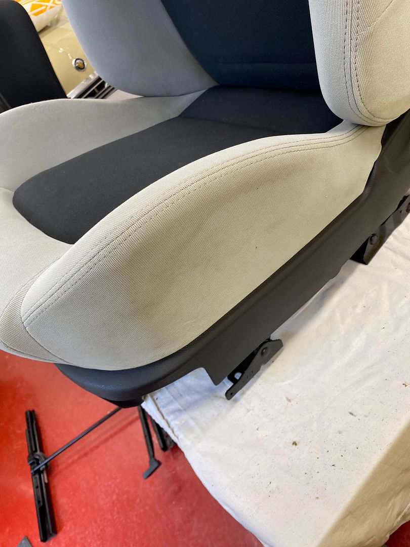

I've now been over the seat twice with the following.
Light spray of 1:10 dilution Bilt Hamber Surfex
Good scrub with a strong mix of Autosmart Bio Brisk
Then extracted with hot water in the Bissell Spot Clean Pro.
Currently on my patented Drying Max 2000 Drying table on the patio..

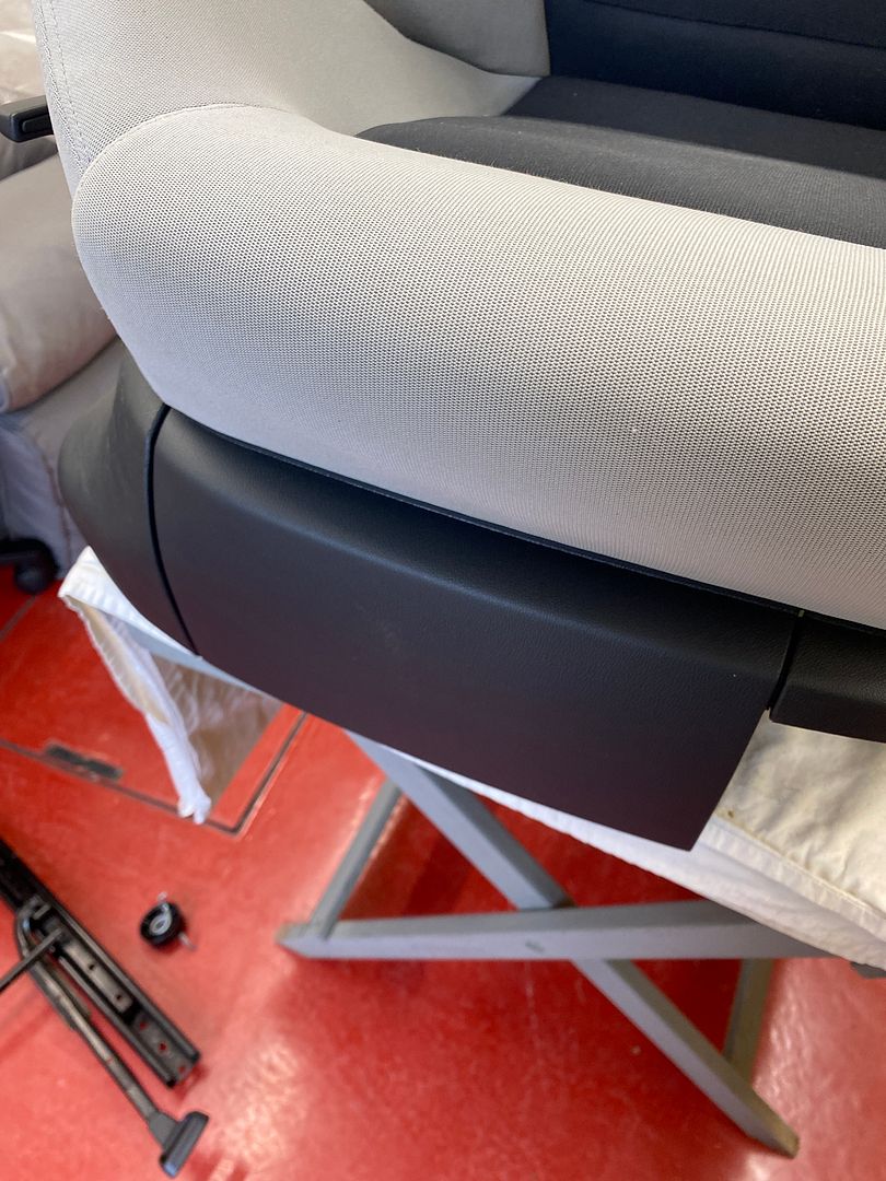

It "should" be ok to go back in the car now, just waiting for a new seat belt buckle/stalk to come from TPS as the old one was scratched up badly.
Seat runners are all painted up now and waiting to be fitted back on the seat.
Plan is to get the driver seat back in, then the fully valeted rear seats and then finally we can get back onto the engine bay. I have the old engine loom removed and the new Genuine one ready to go back in, I'll do that, then change the cam sensor for a new one and go for another fire up.
11 minutes ago, Lofty said:
TPS have been in touch, the remaining piece of seat plastic side trim has now come into stock having been on back order for weeks and weeks - I can't imagine there is much call for people buying obscure bits of plastic trim for 15 yr old Fabias nowadays, so i'm collecting that over the weekend.
I've decided to give the seat another going over with the upholstery cleaner and getting it as mint as possible, then it will be going back in the car next week - carefully as I don't want to scratch up the new plastics in the car and on the seat.

Small update (make the most of it fellas!)

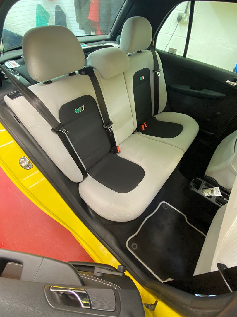

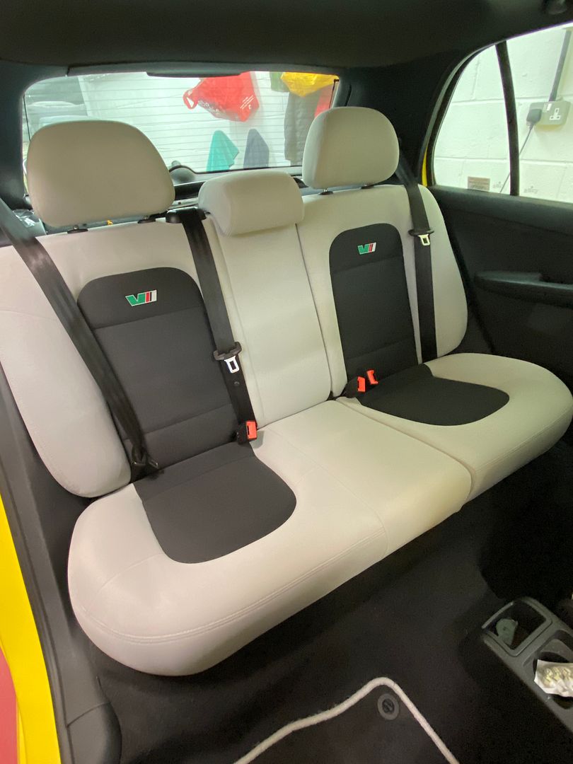

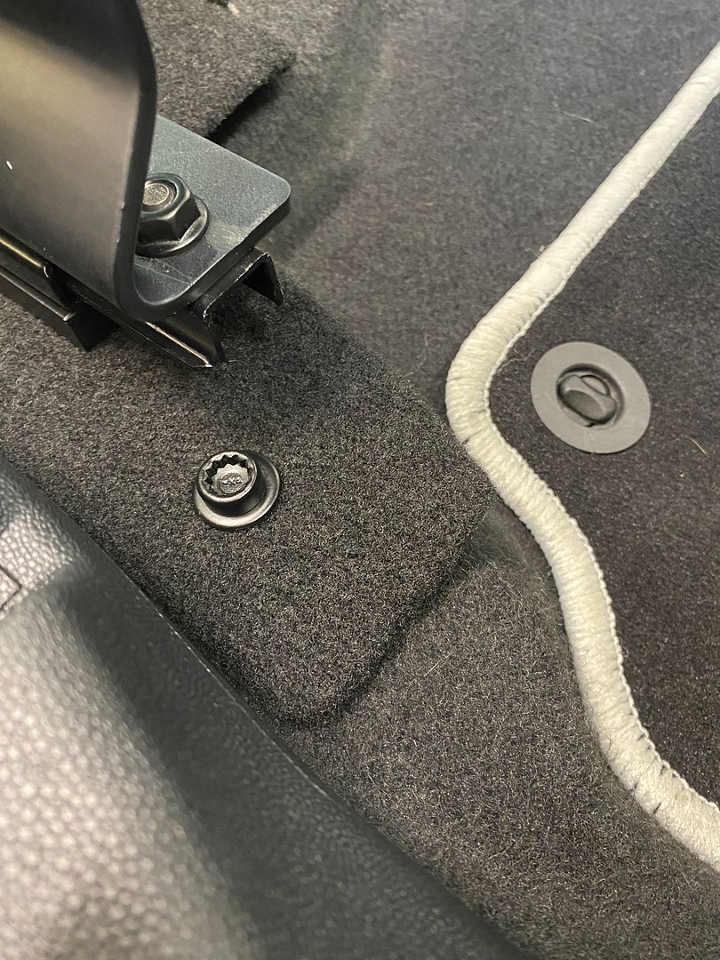

Rear seats back in after 12m of being in dry dust free storage, check out the magnificence that IS the middle head restraint...
Drivers seat all in on the repainted subframe..

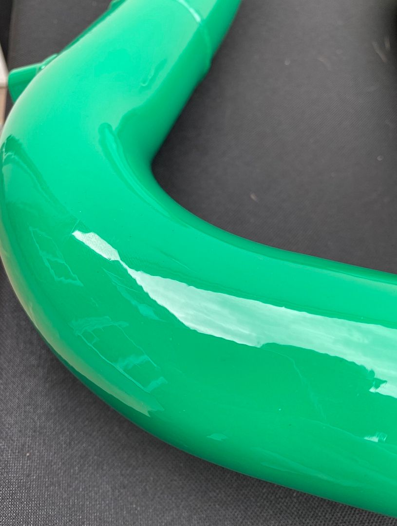

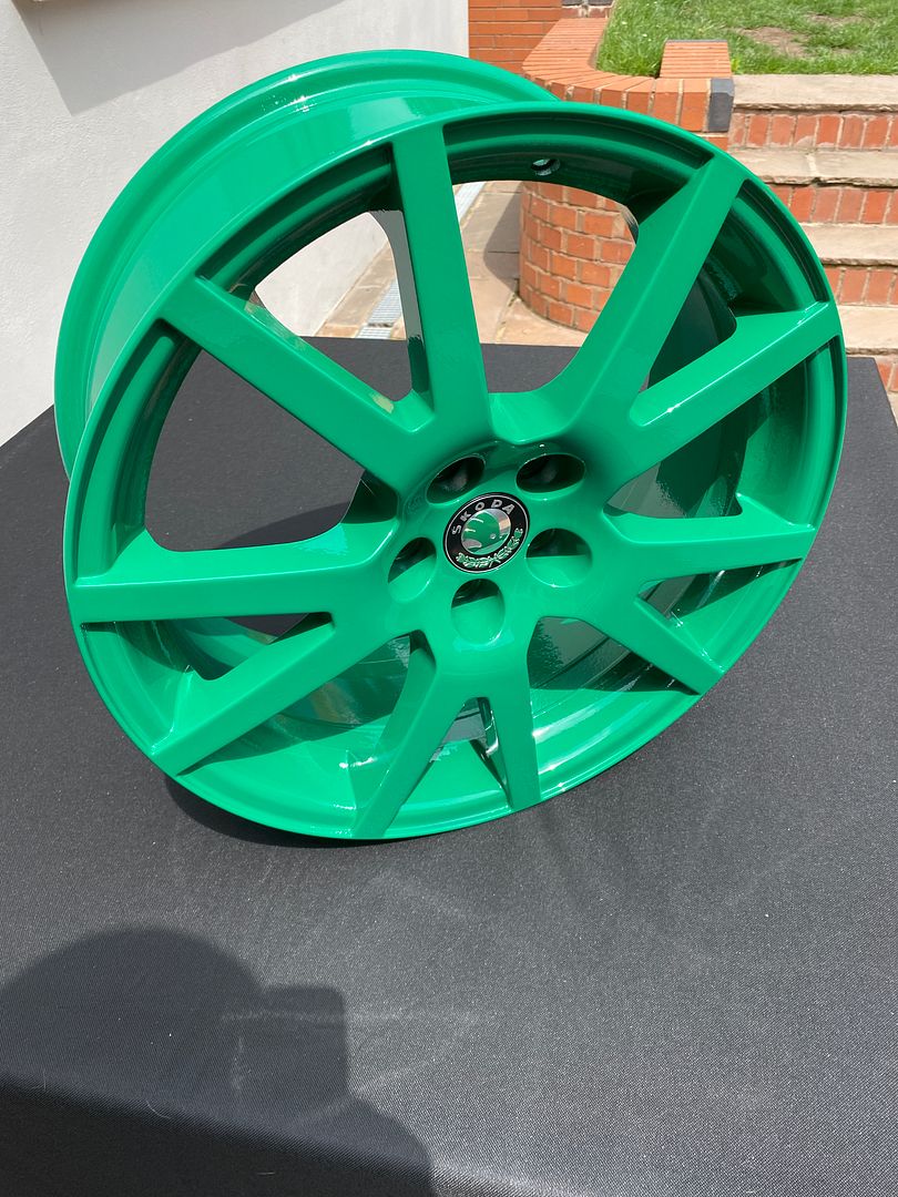

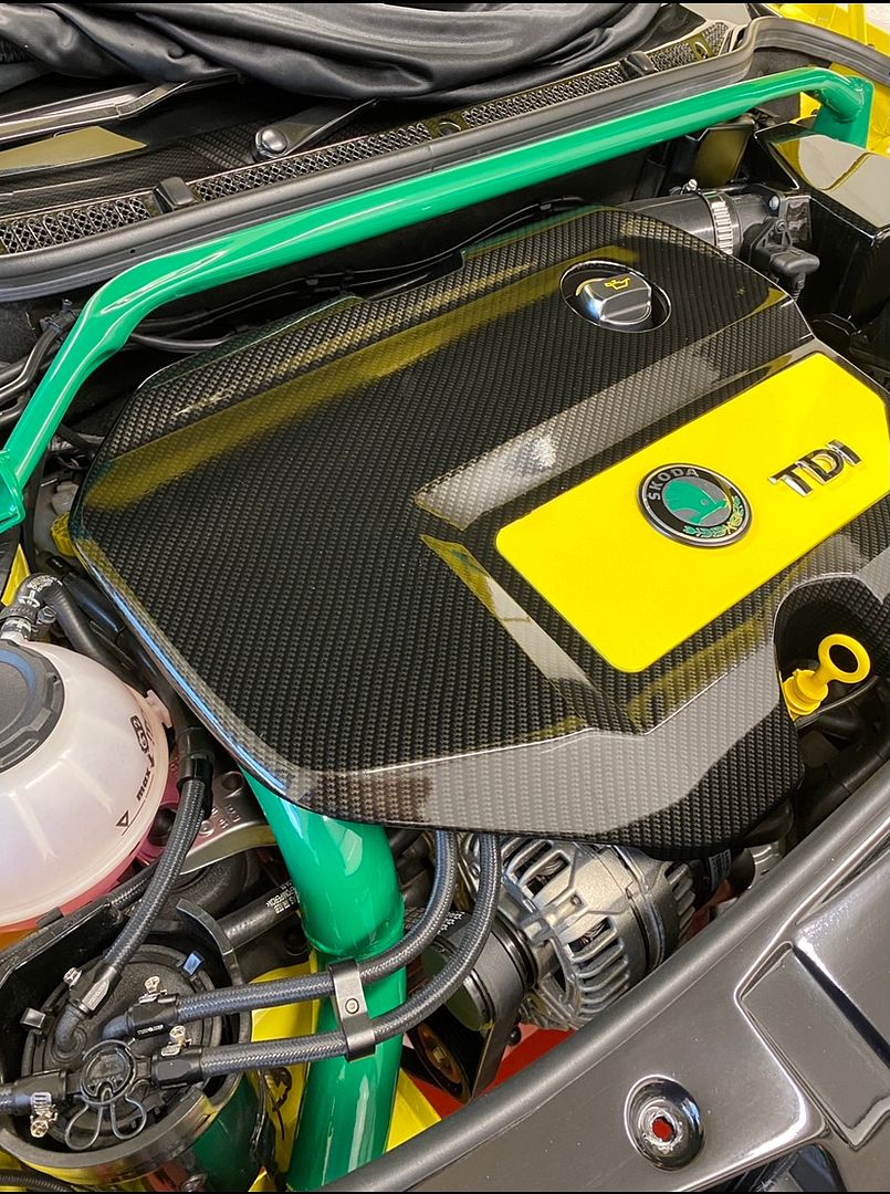

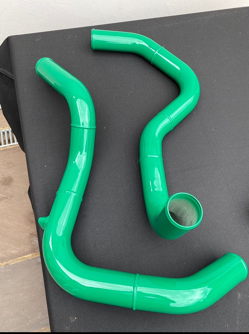

The boost pipes i'd lovingly repainted (probably about 4 years ago) in crackle black were no longer doing it for me, i needed some blingly colour in the bay, so I did yet another "thing"..
My new local powder coating emporium - Project Powder Coating, Brierley Hill - have done me proud again, stripped and blasted, powder coated in Mint Green (RAL 6029) then coated in Gloss Lacquer Powder, they are mirror smooth, and tough too!
The RAL 6029 is the exact match for the Skoda Mint green in the original Badge, and the brake caliper colour, so it ties in well with the SEAT Sport Strut brace in the bay, and the Skoda badge on the engine cover..
Et Voila ....
