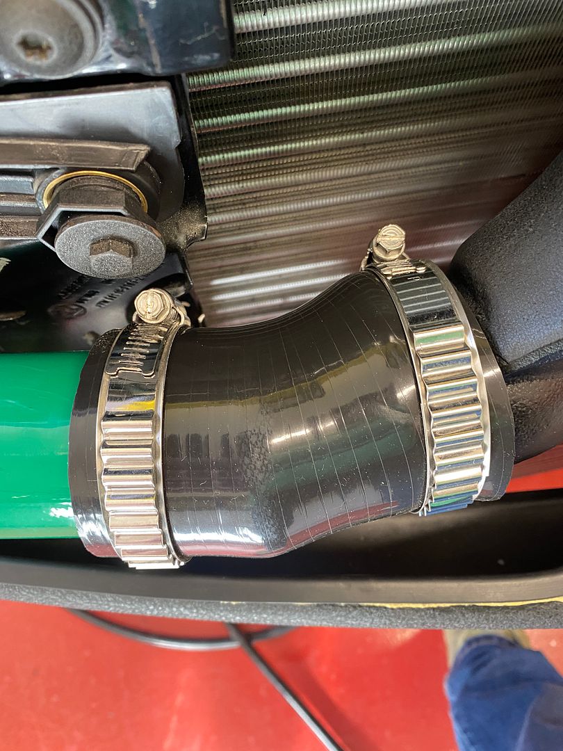

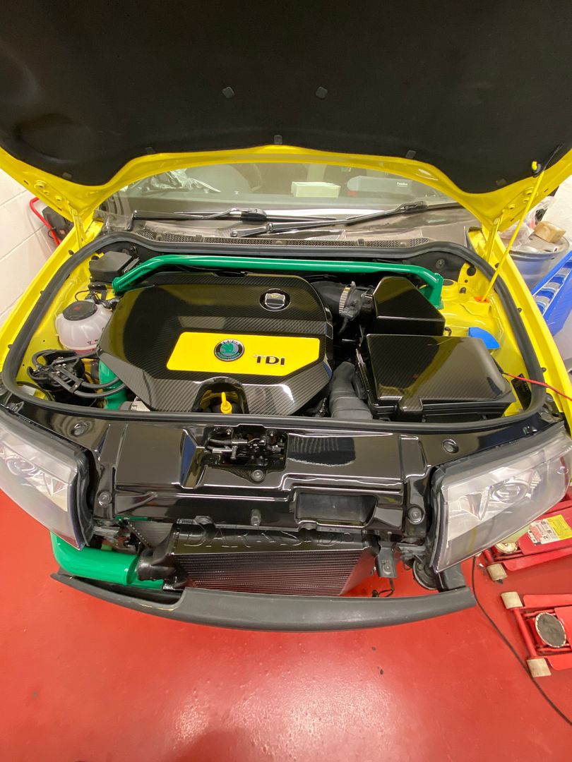

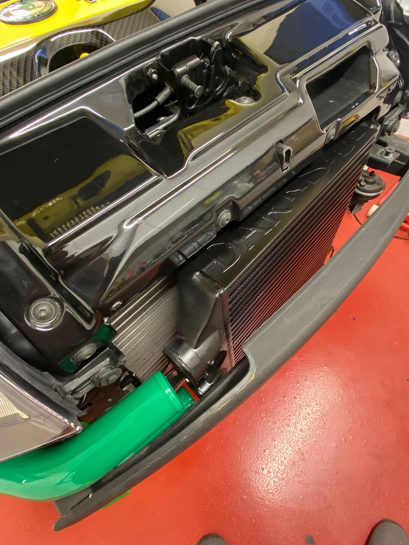

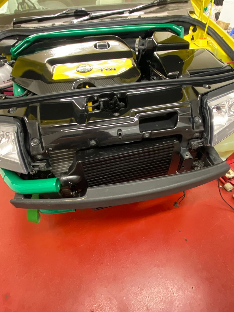

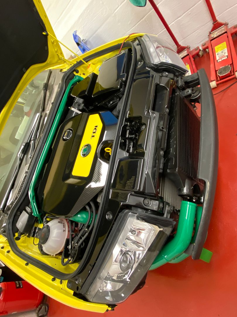

The way that intercooler mounts will be a bad OCD trigger for many! I know I couldn't have that on my car.😂
You know what, I think you're correct. It looked ok initially to me last night but now I'm sat here studying the pictures the more it's bugging me.
I'm now looking at getting the right hand SEAT Sport intercooler bracket modified to bring the cooler out flush with the left had side. Sent some images to a fabrication buddy of mine who can work his magic.
That might well help a little with the pipe issue you described before too.

It's a bug bear for sure, to pull the passenger side forward would mean hacking off that bumper mount as well so I'm leaning towards leaving it where it is having looked at it in depth.
Good news is the 30 degree bend boost pipes fit nice and easy, that removes at least that struggle.

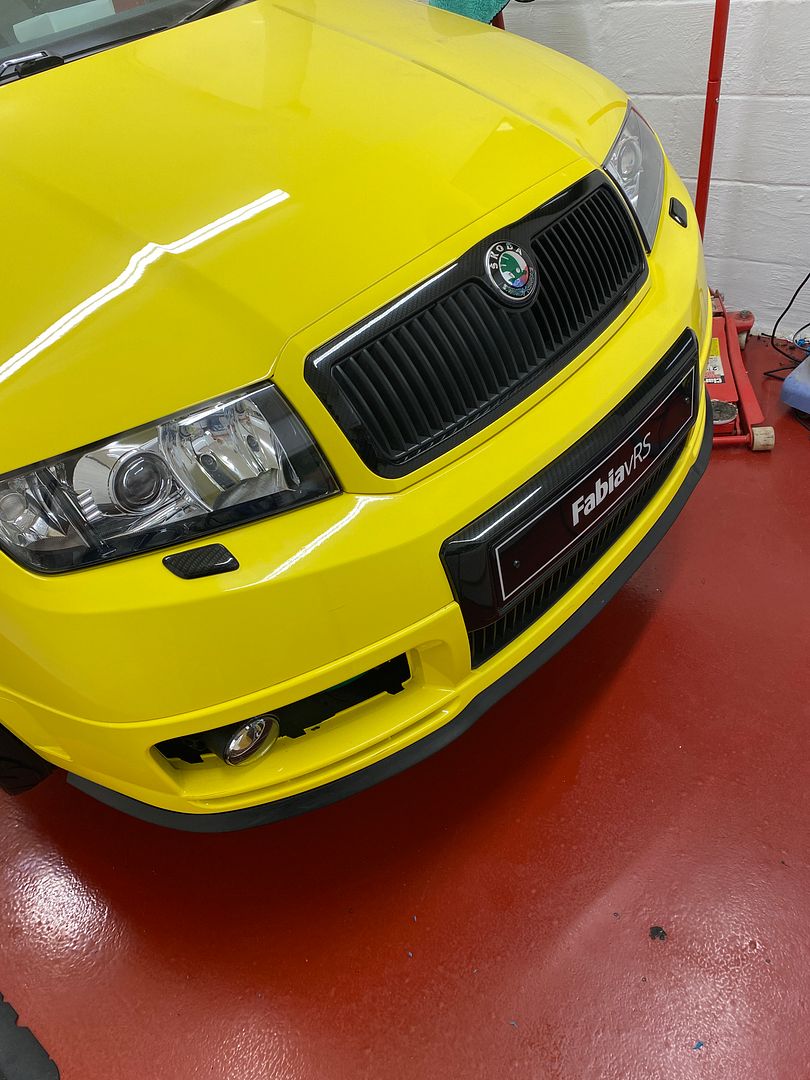

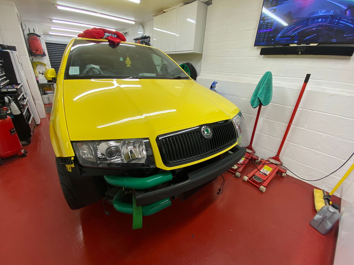

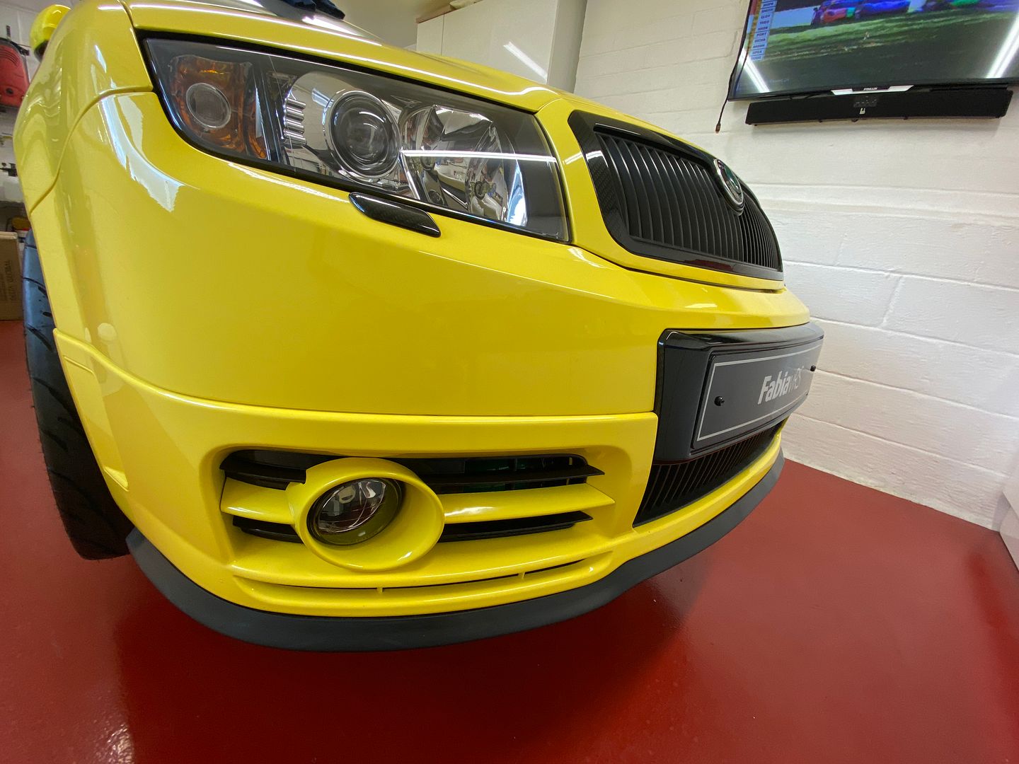

Test fit of the front bumper was a success. I even found the fixings after all these years.
Bumper is back off now as I’m painting the inside edges, be back on tomorrow along with the fig light surrounds. Once it’s finally on I’ll give it a good clay barring then machine polish it.
The 30degree boost hoses were an inspired choice, they take all the struggle out of trying to manipulate a short straight hose and fit almost perfectly.
More pics when it’s all buttoned up at the front.

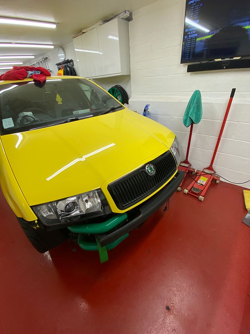

Sunday update. Car looks the same as yesterday apart from the bumpers now painted inside and the carbon dipped fog light surrounds are fitted.

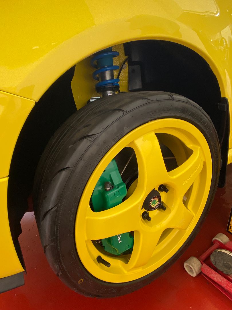

Had both front wheels off to give all the arches a blow out with the Tornador which has a weak mixture of Bilt Hamber Surfex HD in it, this cleans off the collected dust and after a wipe with a microfibre they’re as good as new. Polished the wheels in and out as they were caked in dust from sitting.

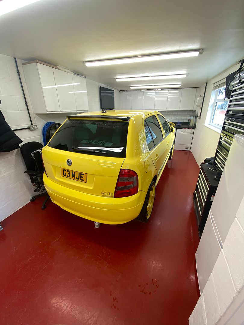

So that’s the front end done. I’ve started deep cleaning the back now with the Tornador with a view to finalising the exhaust set up. I have been messaged by a Fabia fella on the “socials” saying he’s got a Milltek back box so I’ll wait and see if it comes good.
Exhaust located - couldn't get any sense out of the lad with a supposed Milltek back box so based on the research I've done, a Piper 2.5" rear box will mount to the Milltek 2.5" mid-section.
With this information I spent some time on the Piper website and they list a 2.5" rear section, without a silencer and with a 5"x3" oval tailpipe. This is only intended to be a temporary measure until I can get it into the custom exhaust place for my 3" downswept tailpipe section in due course.
It should be here within the week so I can get it on and the car ran up to see how it sounds. I'm expecting it to be similar to my Black vRS which had the unsilenced Ulta Tip exhaust on it and that was acceptable.
