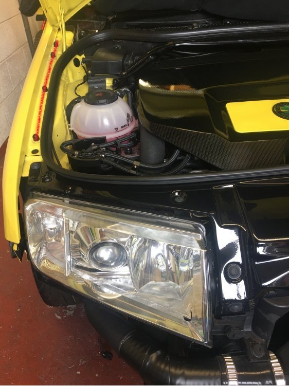

Had a couple of hours free tonight so I test fitted the new headlights, firstly to make sure there’s no fouling on the upper solid boost pipe and secondly to see what the fitment was like round the grille/bonnet etc.
DDDF53EA-F5CA-402B-A86A-88CF54001942_zps
4E9723D2-65FD-4677-B657-CF6AC4D6283E_zps
F1DCABA1-4E78-4113-9C06-B924EB33200A_zps
I’m glad to say the boost pipe “just” clears the back of the light unit and the gaps are acceptable. Just waiting on some side light bulbs then I’ll build the lights up with the backing covers and ballasts.
The reason for the extreme angle is i’m still sorting out the lower boost pipes and actuator vacuum piping.
I’ll get the new drivers wheel arch liner in next to make sure there’s no fouling on that, then it’s front bumper refit time.
Edited by Lofty
The sheer amount of adjustment on the MK1 Fabia headlamps is mind boggling. You can move them about all over the place on the inner and back adjusters. Have spent ages before getting them to line up with the wings then bumper and then to look the same as each other.
I have looked again at my headlight fitment and the drivers one needs moving closer to the wing, other than the top two fitting screws and the long 10mm headed bolt into the front panel, where are the other adjusters for the lamp body Ross??
The back T30, the mounting that it goes through onto the lock carrier also adjusts up and down.
Ahh right I’ll have a look later.
