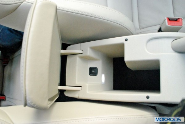

I'm looking at the service manual here. The stock location for the USB connector is inside the front armrest, and the interface module is fitted under the centre console - looks like you'd need to remove the console to fit it.

Yes I see a bit of oblong white plastic on the back of the centre console, I believe this is where the factory fitted option is situated but that looks like a bit of a job to get it there, that's why I was assuming the glove box was the place for the retro fit part.
That white plastic is the armrest storage area light.
Well mines does not come on, or perhaps only when the main beam is on. Is it meant to be on all the time?
It only lights up when your headlights are on.
