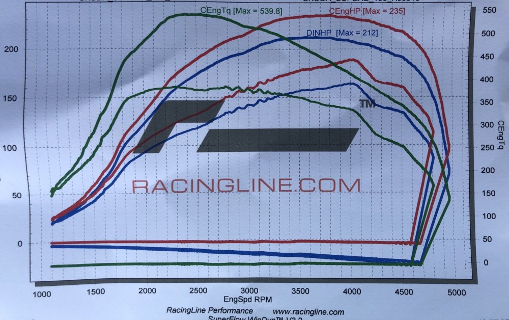

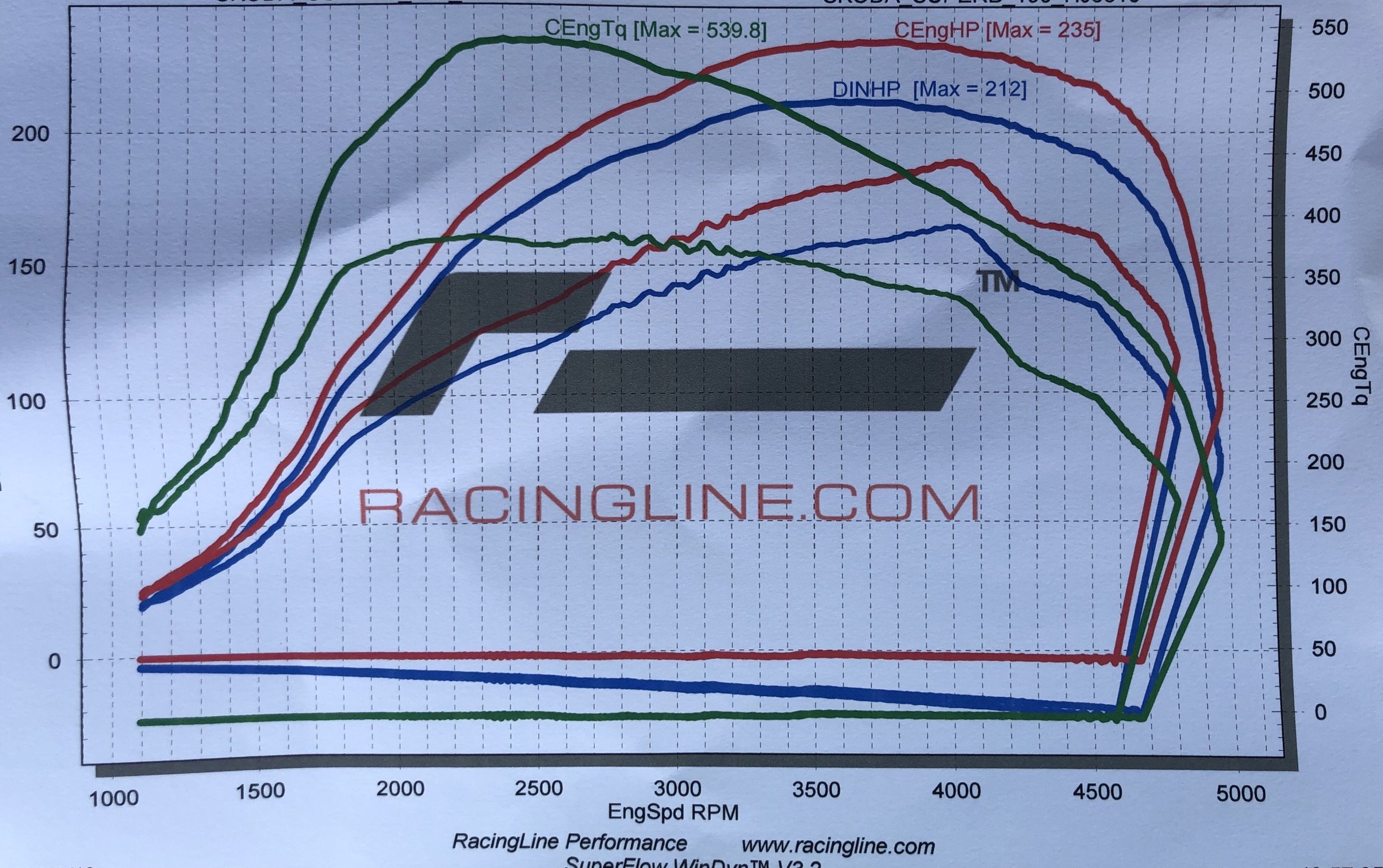

Standard map Superb diesel 4x4 sportline, Bang on 190bhp and 400nm. Then the racingline map. 408231E1-C078-4C17-BC44-C92FDA1BF89B.thumb.jpeg.c17928d1a63933bab0e293a8dd112451.jpeg
