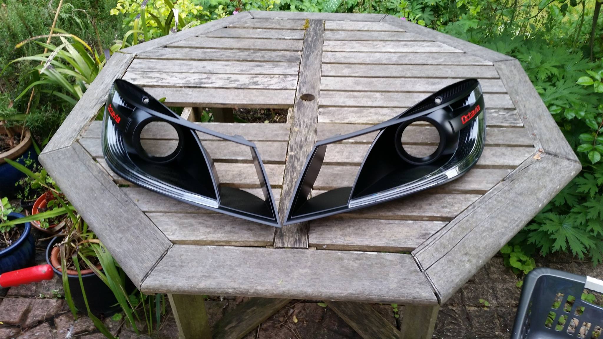

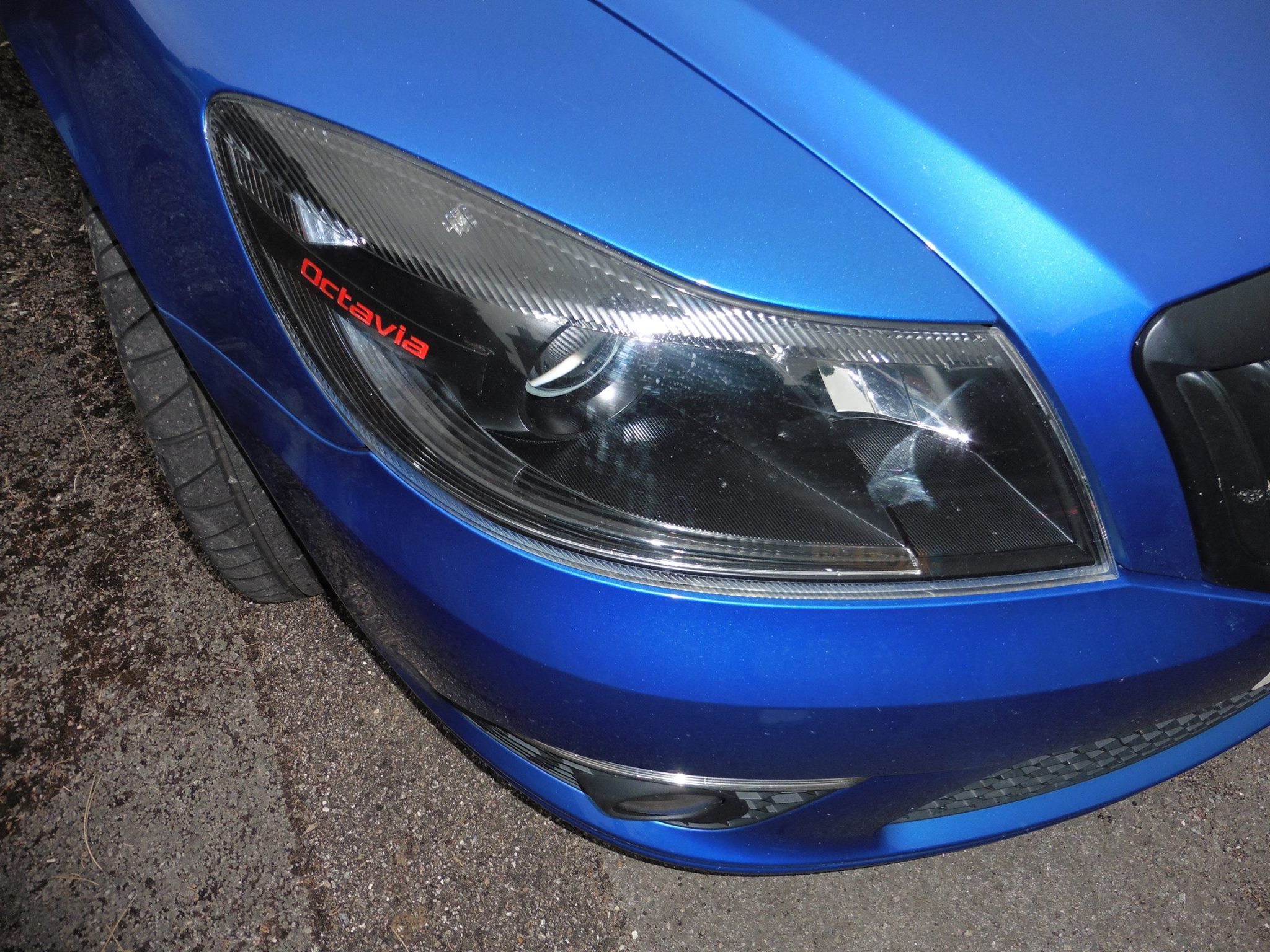

I assume you're aiming for something like this:
You can even add a little colour:
I was just starting a reply, and was getting a few pics together, and I had the same 3 pics as you have just put up to show what I meant,  minus the bottom one!

Couple of images of headlights that have been spilt, looks like a cut to me.

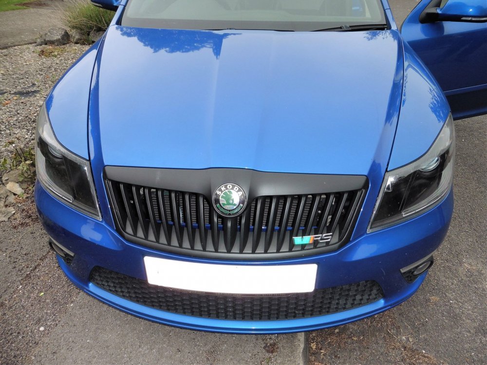

So I thought I would update this. It's been a while but I finally got around to trying it. I'm quite pleased with the result.
I got hold of a set of spare headlights and gave it a crack. Used the technique in the video above to open them and then melted back together with silicon over the top to seal them. Been 3 months now with them in and had no leaking or any problems really. Light output is the same as far as I can tell so that's good!
If anyone is interested I got a load of pictures along the way to show what I did if anyone else want to do it too.
