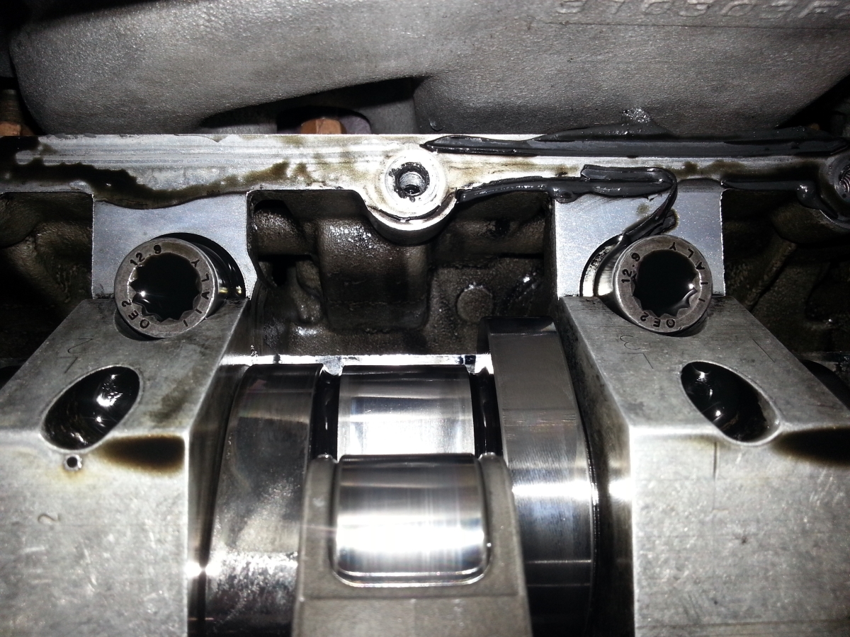

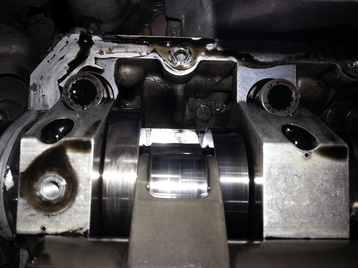

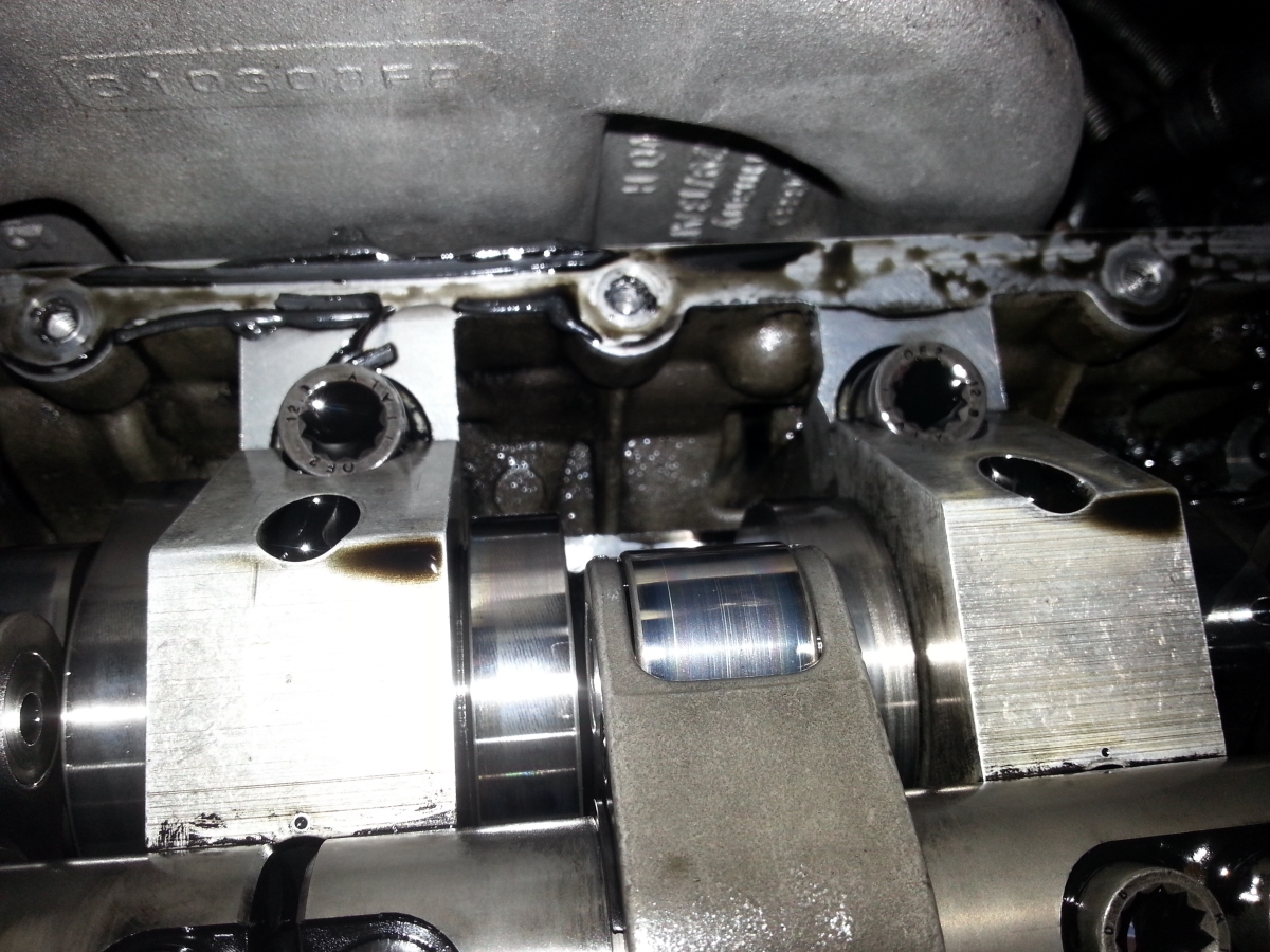

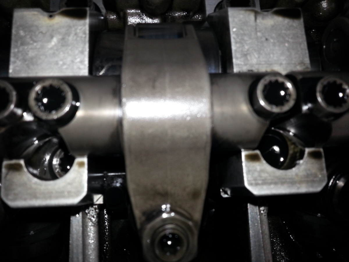

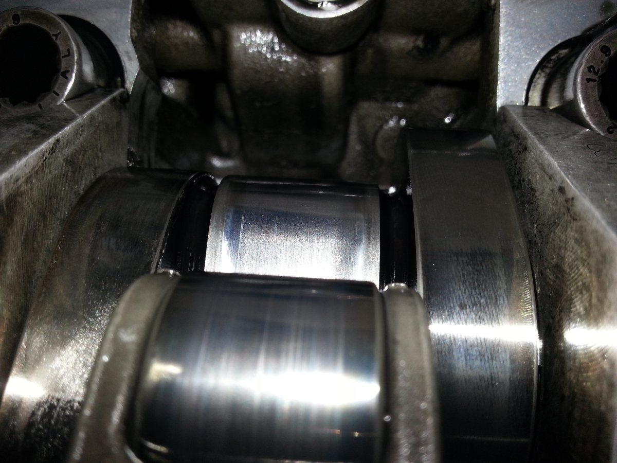

Ok so as im changing the rocker cover due to oil leaking, i thought i would take some pics, to see if any knowledgeable folks think stuff under there looks ok :p
I noticed the two closest central headbolts are full off oil, i did changed to pd150 bolts a few months ago.. is this a issue, also i see some wear on the shells, again are they alright?

There are no shells in those pictures, only lobes and rollers, the left hand lobe in picture 4 looks brutally scuffed around the nose, it should be smooth, please confirm this by running a fingernail across it and report back.
As above,that lobe looks well worn :(

Ive had a look, and it looks pitted or kinda corroded like aluminium does, but i cant feel anything to touch.
Out of interest which is the exhaust lobe?
I think that scuffed looking one is an exhaust lobe, I believe that lobes 1, 4, 5, 8 are inlets and 2, 3, 6, 7 are exhausts.
Hmm thought it sounded a bit off on idle, do you think its in need of further inspection?
Yes, check all the lobes, it looks like the case hardening has worn through on that one.
