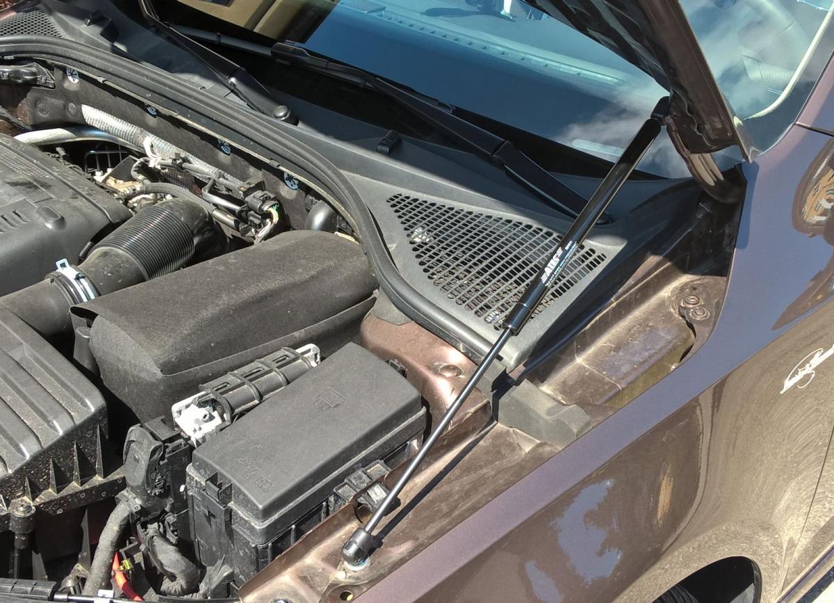

There are two contrasting pictures on the Superskoda website to explain, but I've just fitted mine a few days ago, there's none on mine as far as I can see.
By the way, you will need a reasonably large Torx bit/tool (sorry, I can't remember what size, I was just lucky to have one :p ) to remove the bonnet hinge bolts to secure the new fittings for the dampers, and some washers for the bolts, as they are not included.
They do work well though, as long as you don't mind lifting them the first foot or so.

I do not have time now for a proper instructable, but if you can wait a while I can put together one and give you info on what I did.
A thing worth noting - make sure the struts you use are not too strong (some people here suggested 500N). I have 320N (L=525mm F=320N from Seat Ibiza) and I would say even 220...240N (e.g. L=525mm F=240N from Saab 9 3) would be fine/smoother.
I made a calculation that brought 190N minimum, but even a single 320N can almost hold it.
To remove the screws I used Torx T50 size.
