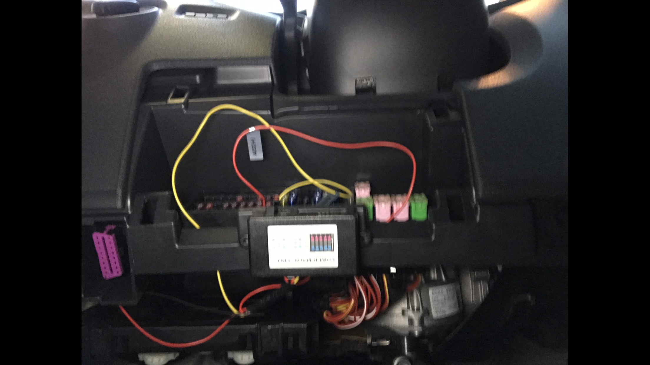

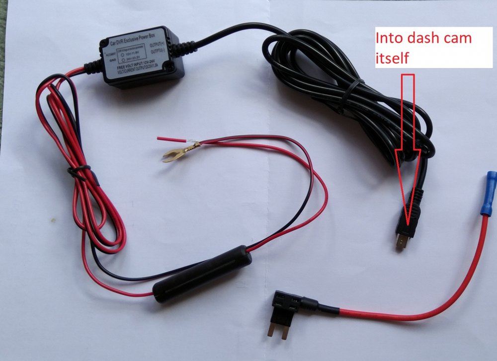

  • It's a fairly straightforward job.   The next base kit comes with a piggyback fuse which will slot into an existing fuse slot and allow you to take power from it.   This is how I fitted mine:
  • For the fuse just place the one that you remove into the empty slot on the piggyback fuse in the nextbase kit. The only thing to watch is to make sure to fit it with the wire coming out the bottom as
  • Just fitted mine following Flash's excellent guide. Took me about half an hour tops. Had to fully remove the fuse box right hand screw in order to get the wire through, but it fastened back

To confirm - black fork plugs into fuse socket, golden coloured fork is for 13mm earth nut, and single red cable into blue crimp? Thanks!

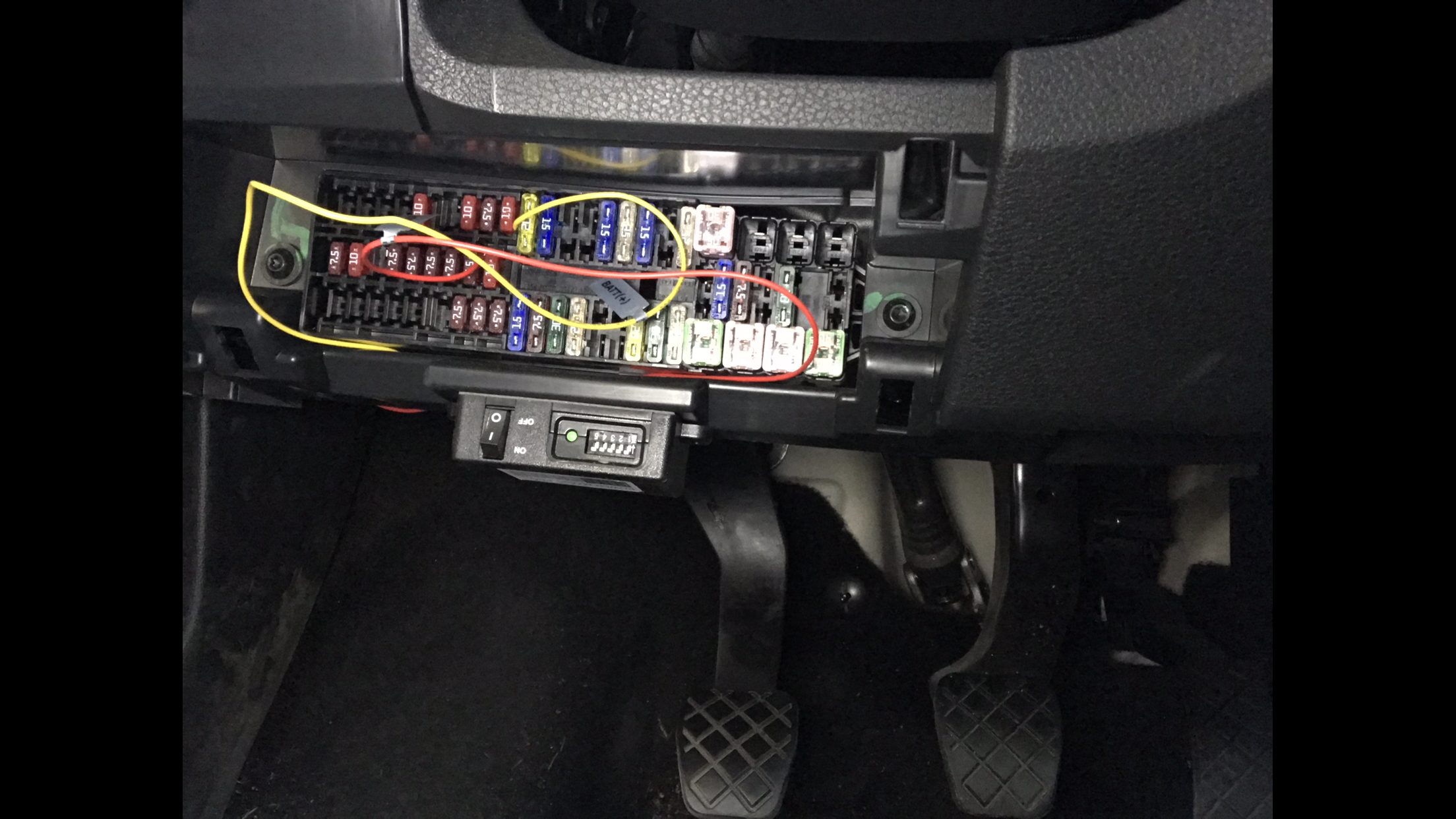

You can find the fuse box directly underneath the steering column

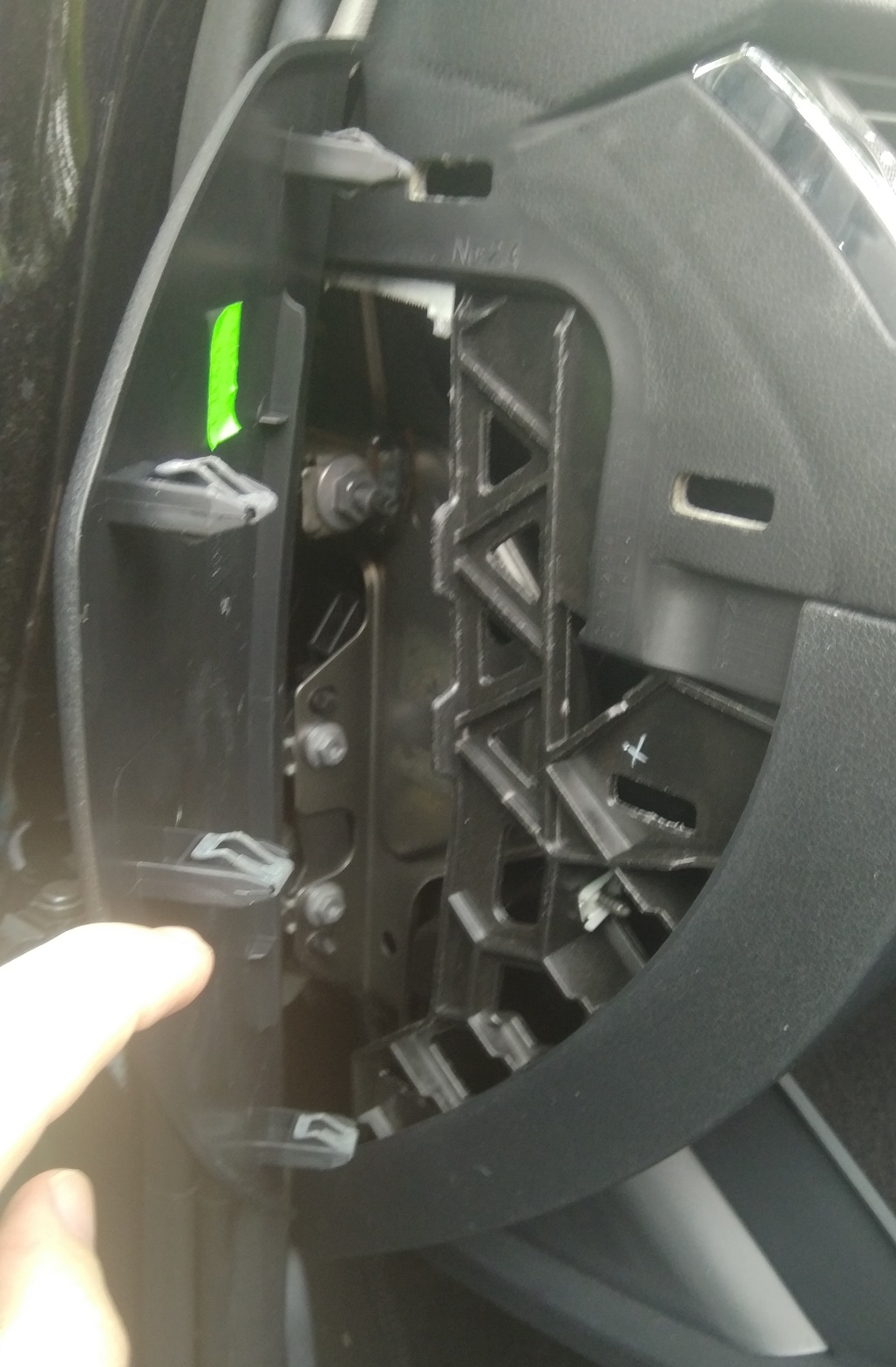

If you find the OBD port and look just to the right side (for LHD) you will find the cover to the fuse box. Pull the cover up and away from the bottom.

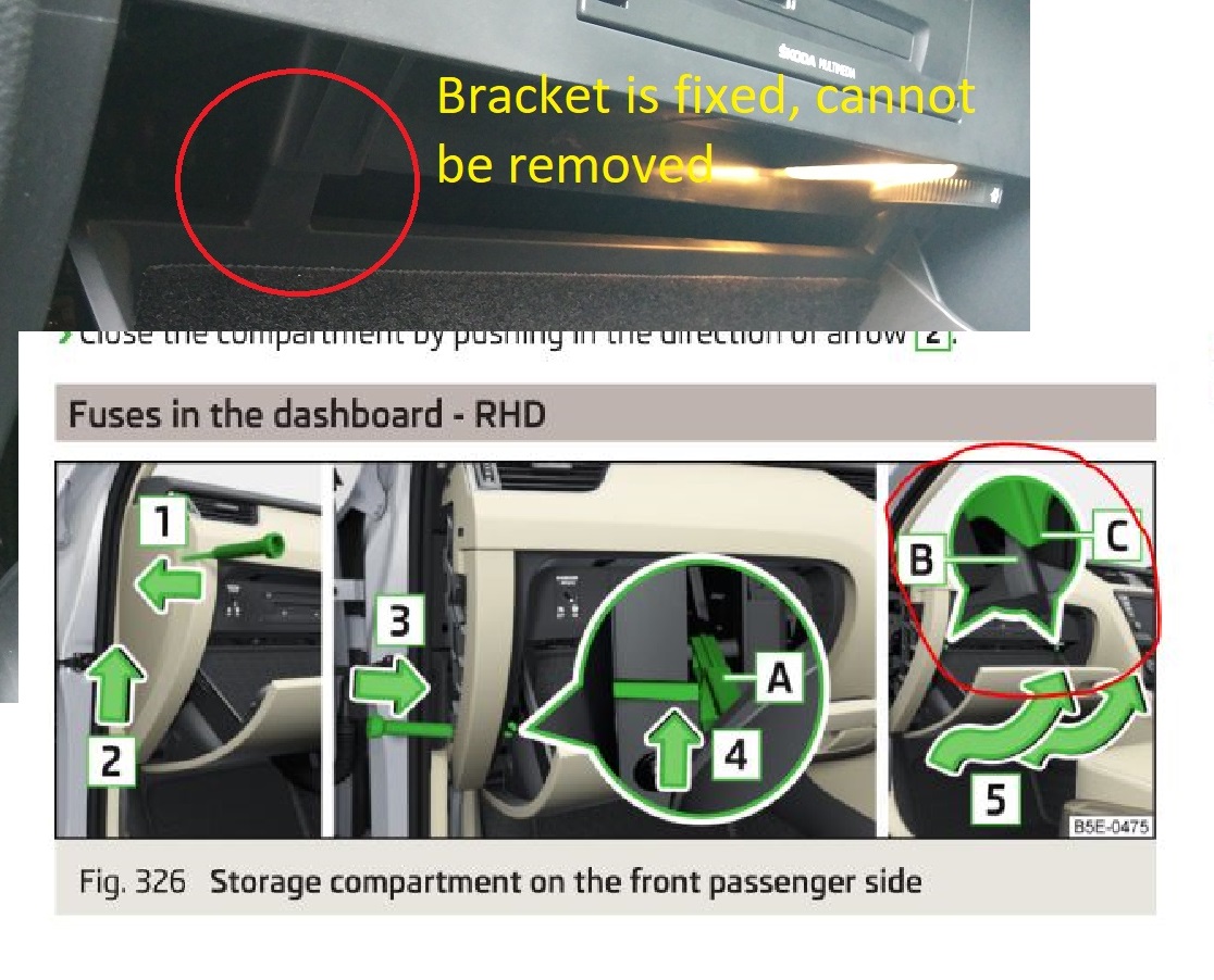

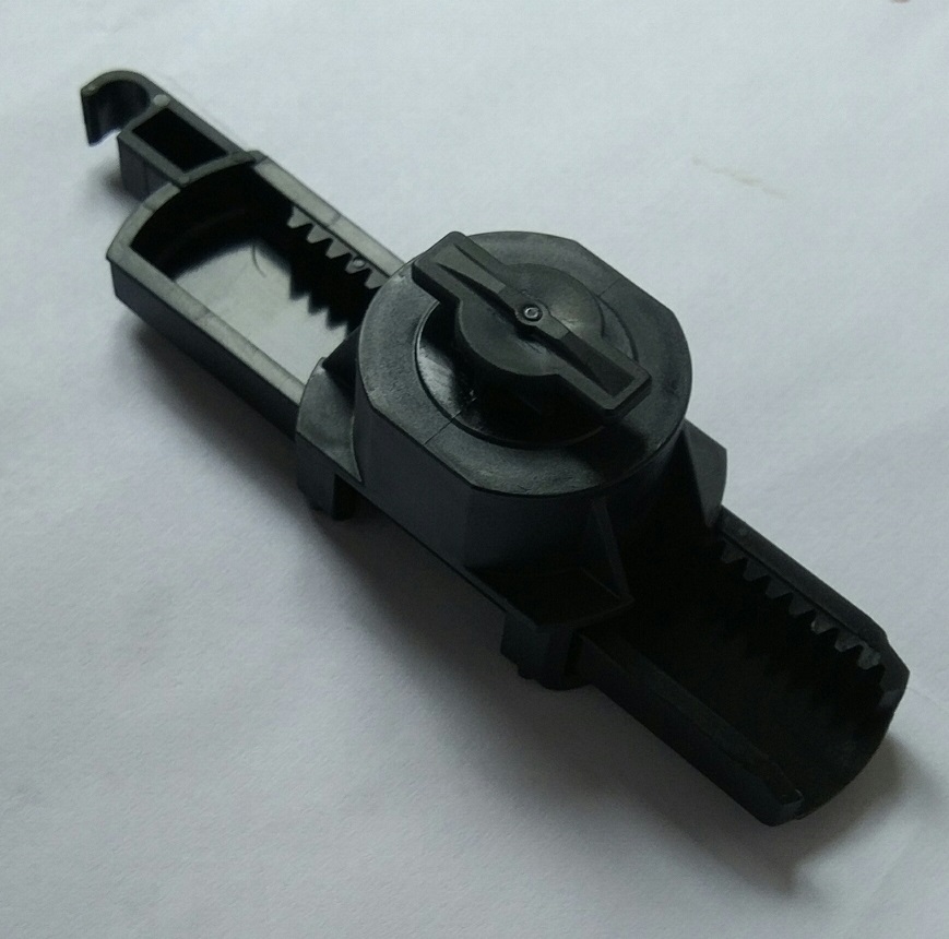

Think you'll find the fuse box is behind the glove box, remove the side panel from the dash (  passenger Door open ) and unhook the damping leaver ( think its white ), open glove box door and pull the glove box door upwards to remove.  Refitting is the same as removal but in reverse order.

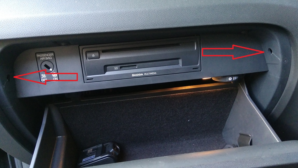

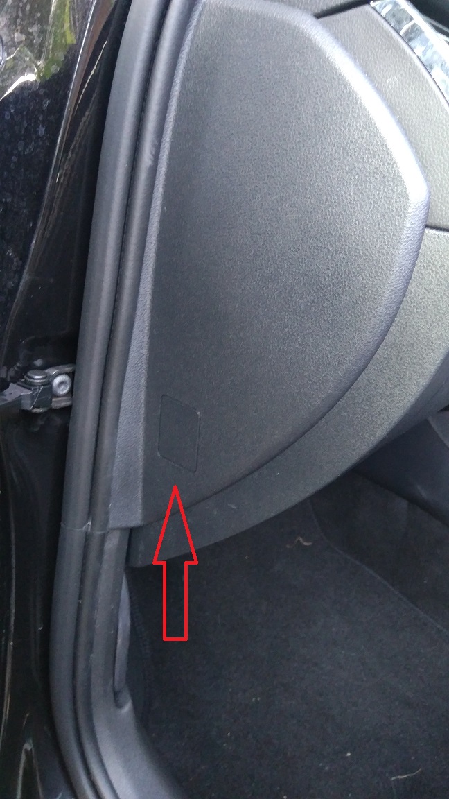

Yes I can see it is behind a glove box, but I`m not sure how to remove glove box. Just took these two photos.
1. Maybe something to do with these two holes?
2. Or there is a screw or something behind that small cover?
This must be a very strange Fabia mk 3 to have the fuse box behind the glove box, both mine have it under the steering wheel.
Mine is Octavia MK3, sorry for confusion :)
Edited by Robertino
Nothing to do with the holes, follow the guide I gave you
Simples
You mean the panel on my 2nd photo?
:nod:

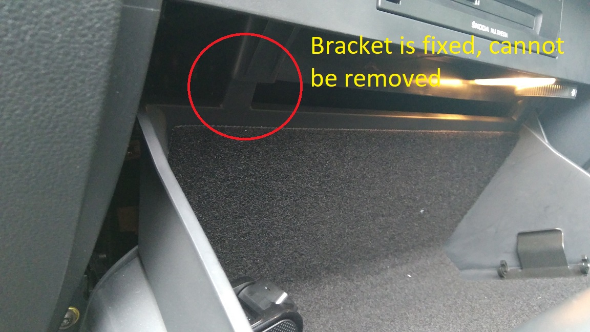

You might need a torch, if you raise and lower the glove box you should see the damping bracket move . It should have a hook type fitting at one end which is attached to something and the other end is ( I think ) attatched to the glove box.
The Instructions are on page 279 in the owners manual
skoda-auto.com/OwnersManual
Edited by Auric Goldfinger
Sorry, but I must be completely retarded.
I also took photo from bottom/under glove box.
Look behind the glove box via the cover you removed from the end of the dash

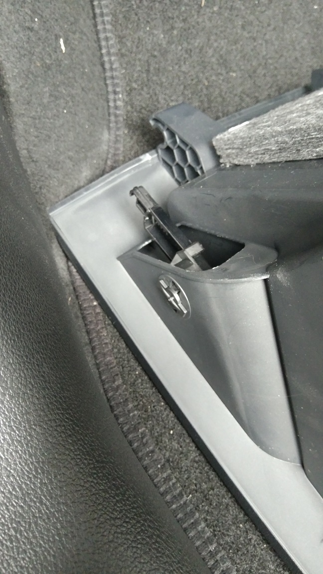

I did what manual said - using screwdriver unclip a hook, it popped out. Looking at manual, its a different glove box, mine isn`t as per their drawing.
Edited by Robertino
The Fun will start as you try and get the damper back in.
I'd order beer, loads
I was being too gentle!!!

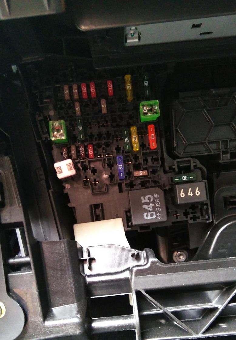

What size fuse I should use?

Trying to fit the dash cam to my Fabia 3 everything's a doddle till I've got to the fuse box... I've got BAT & AAC plug ins to - Er- plug in... so I can use the heated seats or the wing mirrors for the AAC  but... what can I use for the BAT?
Thanks!

Hi, i have the dashcam viofo a119 what location should i place the fuse? I have to put a piggyback with a 5A? Thanks
