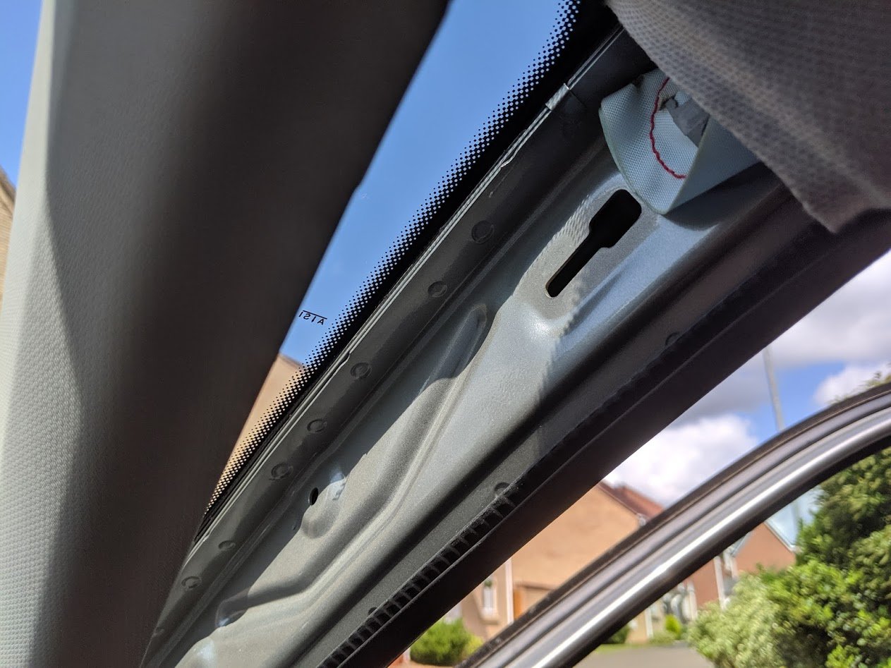

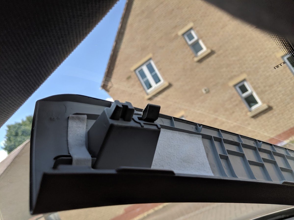

I posted some photos on the bottom of page 4, but yes, it just pulls straight off. Its held on by metal clips so they're pretty sturdy and i'd be suprised if they were to break. Makes the install super easy and means you can secure the cable so its not rattling around or rubbing on anything 👍

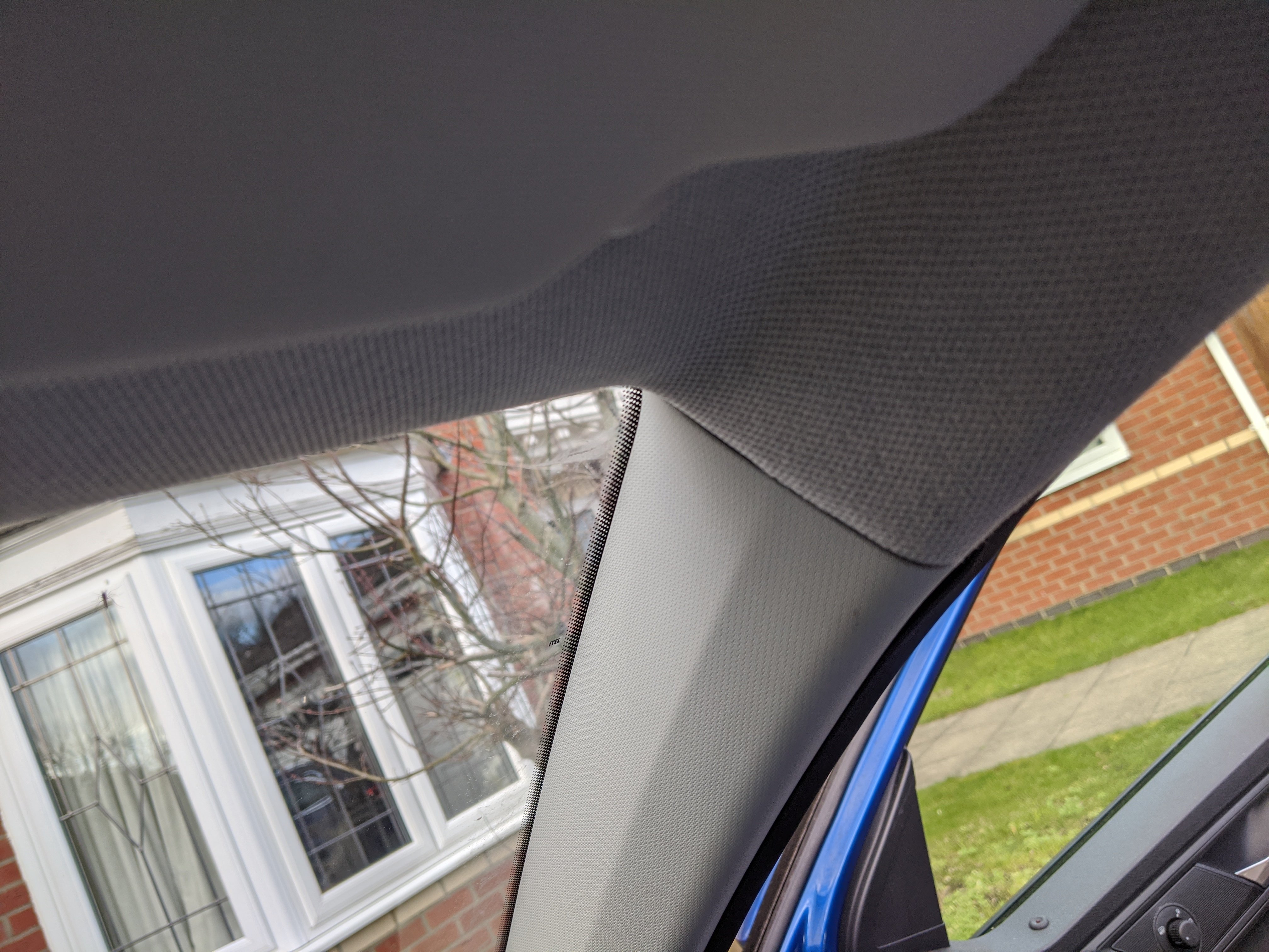

Also ref the trim - did not remove it but noted you can use something big and flat to prise it away from the top of the pillar and then feed the cable into the space between the plastic facia and the door rubber then down into the back of the fuse box.

Just be brave and pull it off, can secure it nicely then 😋

I did the best I could to stick these in to hold the cable in place against the plastic trim... hopefully they're still holding. I have some at home holding speaker cable neatly for my 5.1 setup and they're doing a decent job 3-4 years on.
