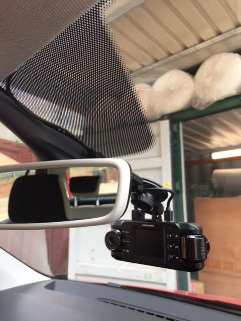

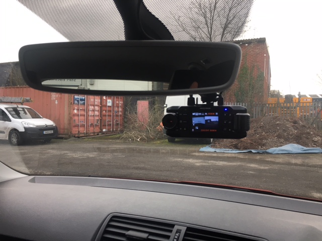

I have been looking at the duo camera, looks like you are pleased with it, any chance of a picture as I can't quite picture where to mount it so that both cameras can do their job.
It's ok, I have had some SD card trouble - make sure it's a genuine sd card from maplin not off the internet, however genuine the shop.
Also lost an SD card down the central heating vents when taking it out once as it's from the underside....keep the flaps downwards when removing sd card - top tip.
the clock doesn't keep to the time, always 1 hour ahead, settings doesn't remember when i change it.
still for me, it's worth it - havign 2 shots is more peace of mind for me. so many dashcam vids of people being hit in the rear and not actually seeing anything but the front view - doesn't prove anything.
not total HD quality but captures what you need.
attached pics is where I have placed it - i don't find the screen a distraction, I found it hard to hide away and also be able to see and have a view....

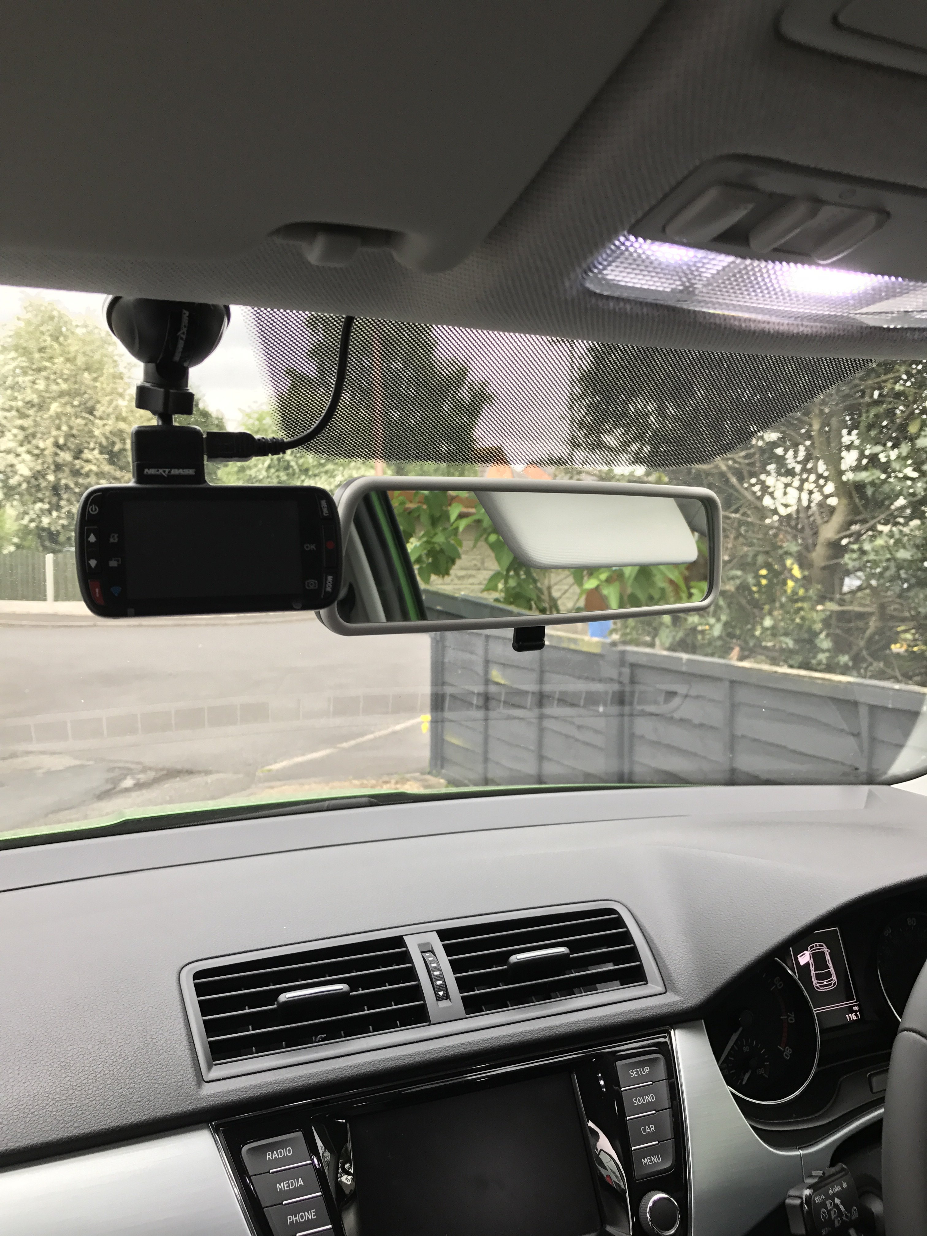

Used TheFlash's method to wire in my Nextbase 312GW dashcam and made the job very easy.
Interestingly looking through the images people have posted mad me curious about the legality of where the Cam should be mounted.
Apparently there are very strict guidelines on this, particularly within the sweep of the windscreen wipers and the screen must NOT be viewable by the driver. (I.e. goes blank whilst driving or behind the rear view mirror.)
Dash Cam placement - the law
Better go and move mine and my partners in her Fiat 500. :o

Ive got mine just at the side of the rear view mirror (but not on the dotted sunshade) it's out the way and offers the best view IMO.

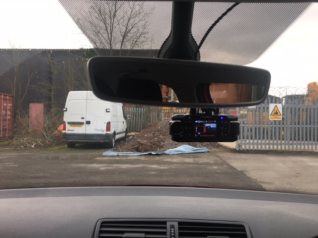

I've also black vinyl wrapped over the writing on the camera and the silver ring around the lens, so it's really stealthy from the outside.
You really have to strain to see there is a camera there (not sure if the pic captures it)
I know you can see the suction ring for now, but when I get chance I will be adding a sunstrip
