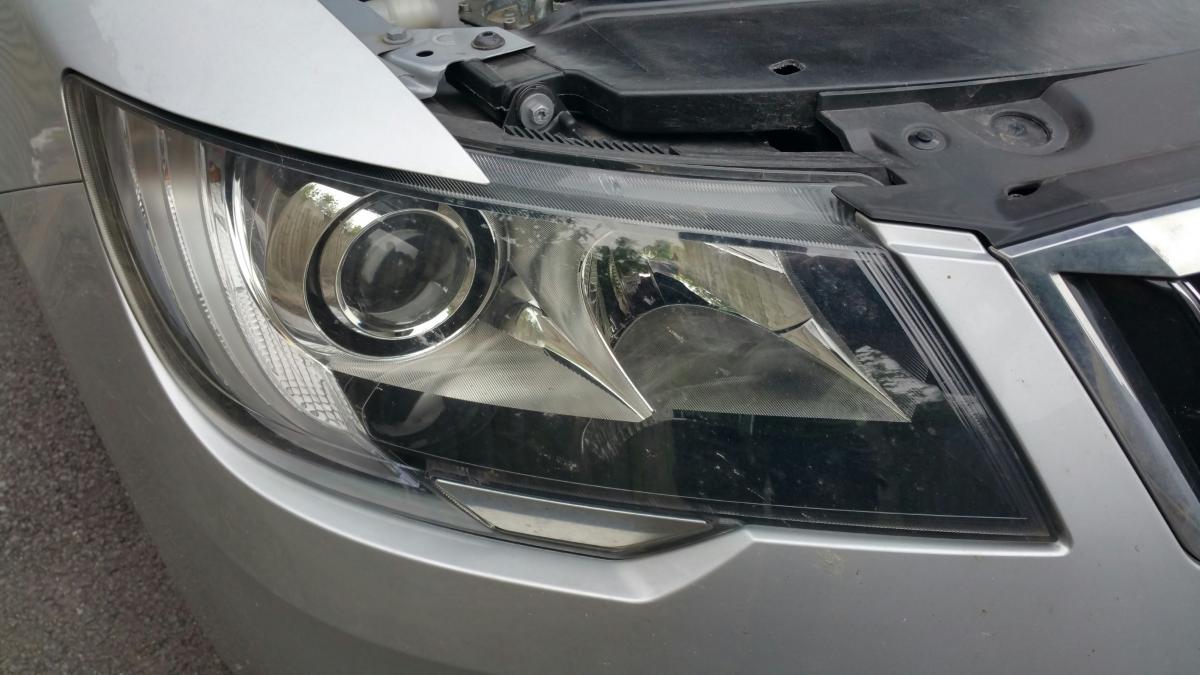

Tomorrow I'll upload more detailed photos of the headlamps and lever that should be moved.
Is yours the pre facelift version - will be interesting to see where lever is?
My post facelift (2014) was initially difficult - easyish now I know how

I think I have the same headlights :)
I'll post more photos tomorrow :)

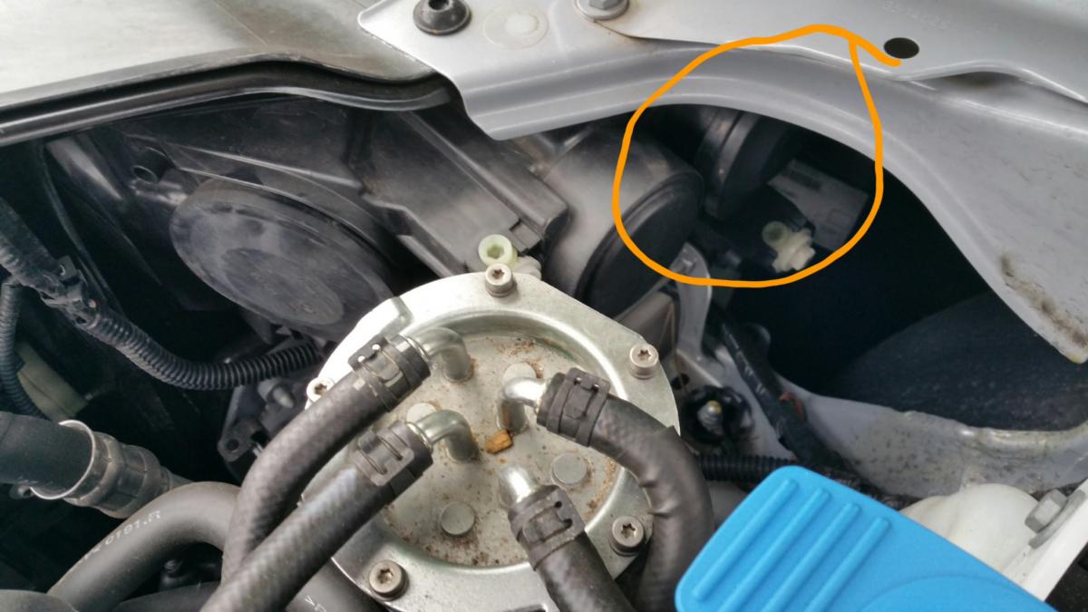

Lever is located "outside" of the lights - you don't need inspection camera to see it :) just put your head down :) Very easy access :) but you need fairly long screwdriver - at least 15cm - 20cm.

Like I said before - long screwdriver is best :) and it's really not that hard as it seems :)

I'll have another try without the camera - but when I first tried when I got the car couldn't get a reasonable view and what I did see was obstructed by my hand when inserting a screwdriver. I suppose might be better with a longer one! Saying that I don't have the daintiest of hands  :notme:

Had a quick look - without the camera can JUST see the lever on the offside, struggled with the nearside  :sweat:
With my vari-focals getting in the way I think I'll stick to my cheapy inspection camera - very easy to visually guide in the screwdriver to the nicely illuminated lever  :nerd:
