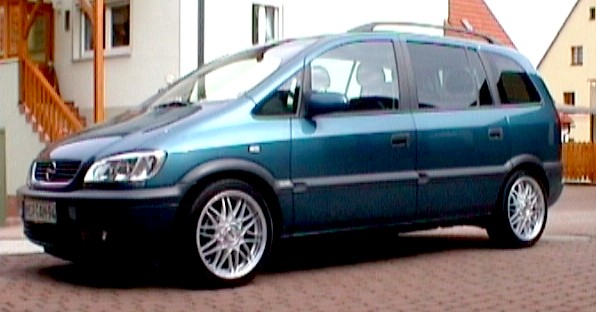

I question the 1.6 101hp capacity for such a car, but there is a low mileage low price example for sale, which seems pretty ok at condition (professionally reworked sills), if not hot selected hardware...
1508110_965056830193665_2241572607984671
Edited by WAUOla
Hold out for a 1.8 - the 1.6 is underpowered for the size of the car. Head gaskets can fail at about 130k miles and the gearbox can give trouble if the oil level drops. Running gear wise, basically it's a mk4 Astra underneath, so parts wise plenty of spares options, and really easy to repair. Main thing is to look for a good history, and also that the cam belt and water pump have been changed (pump is belt driven, so should be changed with the belt - easy enough job, about 2 hours work - no special tools required and plenty of access).
