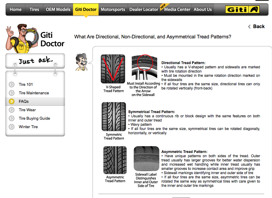

Asymmetric(al) is the spelling, for what it's worth.
Asymmetric (sometimes called non-directional) tyres usually have 'Outside' and 'Inside' stamped on the wall of the tyre.
This tells the tyre fitter which way the tyre must be fitted onto the wheel.
Once fitted correctly onto the wheel, that tyre/wheel can be legally fitted to any corner of the car.
Although most asymmetric tyres are non-directional, some are both asymmetric AND directional which will limit there fitment to a single side of a vehicle. The manufacturer will have two moulds to create tyres that are a mirror image of each other.

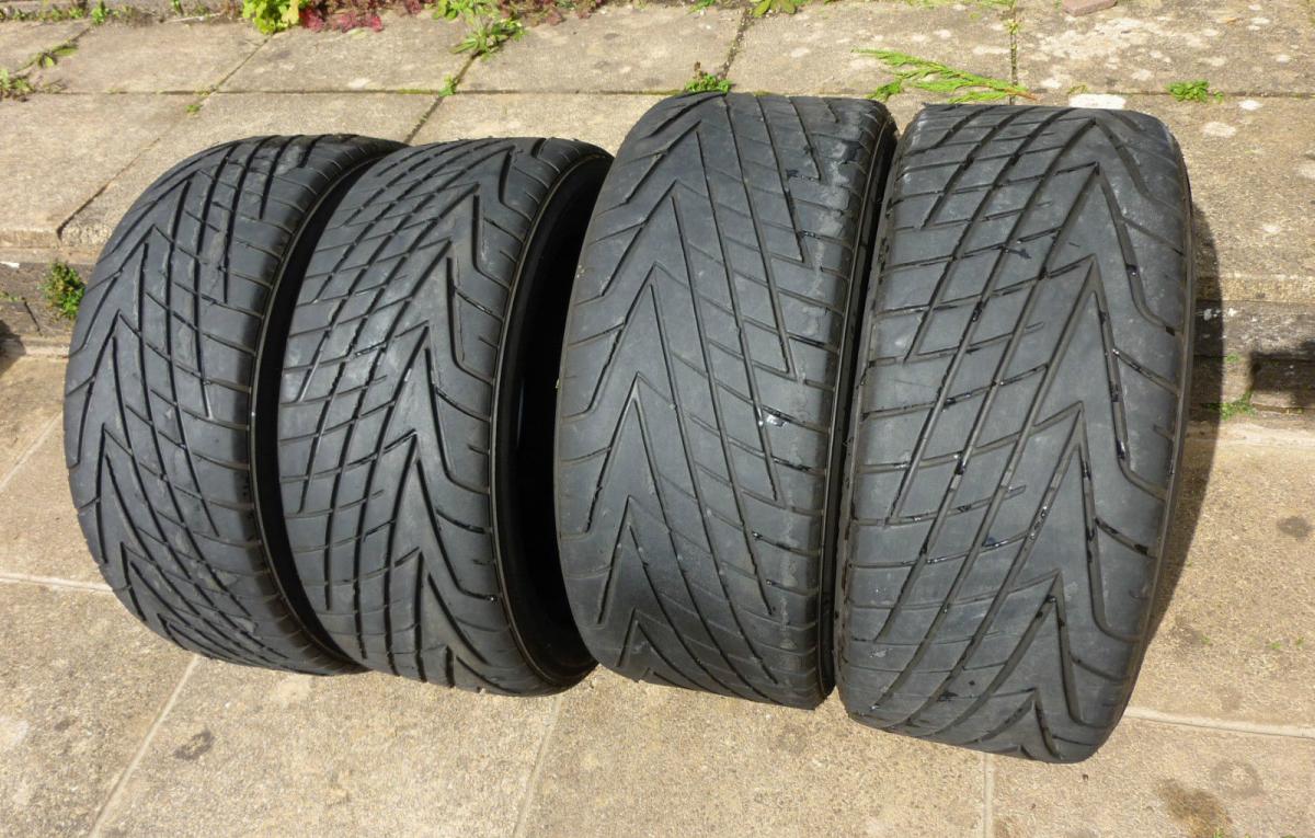

It would be so very helpful and informative if you could say what tyres these are.
Brand / Type / Model & Size would be good.
cheers.
The Yokohama Advan Neova AD05/AD06 I mentioned earlier are a good example as per this picture:
Please see attachment..
Edited by giandougl
Yes, that covers:
- Symmetric directional tyres
- Symmetric non-directional tyres
- Asymmetric non-directional tyres
It doesn't cover asymmetric directional tyres which can only be fitted to the left or right of a vehicle.
Yes, that covers:
It doesn't cover asymmetric directional tyres which can only be fitted to the left or right of a vehicle..
