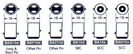

Different locating pin alignment aren't they?
Tech1e- haven't tried one yet, but if it's not ,it's pretty close - both pins are on orange one are same distance from the end . Will try ,& try one to see . Fabiam- I've got 4 in my glove box, just in case one of the new ones fails. in this one horse town, you tend to look for other uses for old items, as what might be pence in a town, will be £ here. ( Assuming you can find someone selling it).
TECH1E. - as usual- you're correct . Pins look ok, till you look at them end on.

As Tech1e said are the pins the same ?
Lots of lamp holders tend to be offset pins for brake lamps and directly opposite pins for indicators, even though they are a single filament lamp :)

Offset pins on the rear of a mk 1 hatch (I checked yesterday, mate is getting me some silver ones to get rid of the egg effect)

Just file the pins a little and they'll fit.

Fordfan- I'd change file a little to a lot, then find some brass mini nails ( as used in shoemaking) ,drill a hole in the cap and solder in .
