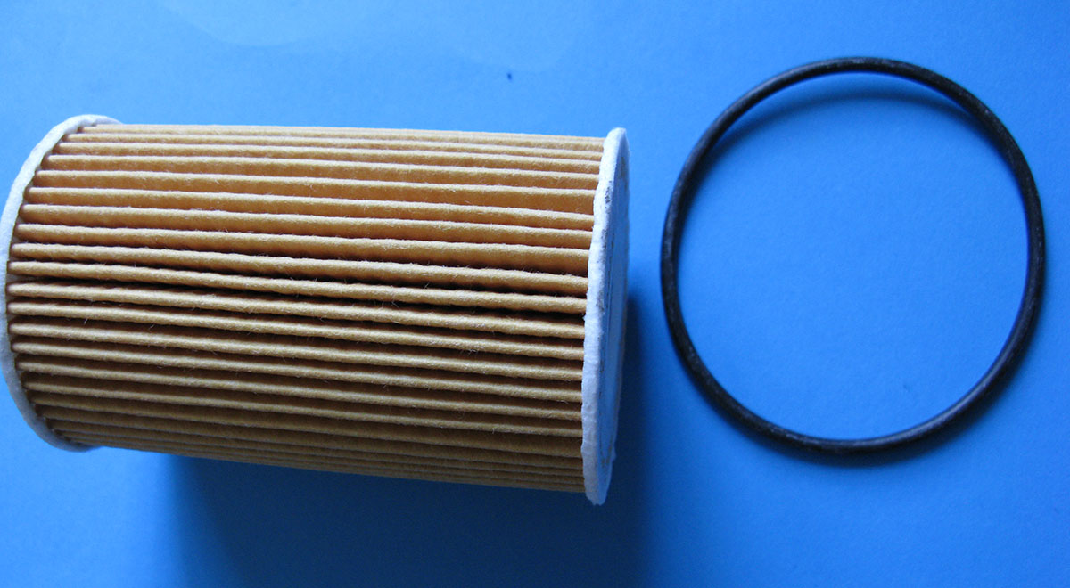

II'd pre-ordered a replacement Bosch oil filter in advance. The old oil filter was just like a cylindrical sleeve with the centre spigot part of the cap and not part of the filter as on the replacement. There are TWO versions of the Bosch filter used on my Yeti, don't rely on Registration for online ordering use your VIN.  Fit a new O ring on the cover and replace. The tightening torque varies between 20-25 Nm. Mine was 25Nm stamped on the black cover.

The 2 different types of filter foxed me a little the first time. Had to re-order a filter ostensibly for a 1.6 diesel engine instead of the "2-litre". (Traced by cross-referencing the old filter's type code to different engines). I suspect which engines got which design of filter housing was down to whatever was available on the line on the day? My car's engine like yours has the long, plastic centre spigot built into the cap, not a fresh spigot every time built into the filter cartridge. Seems to make the new filters a touch cheaper this way round too! The filters themselves seem identical. Mann, Bosch and Crosland filters come with a pair of new O-rings for the spigot. One about 15mm dia. The other even smaller, for the lowermost part of the spigot. In addition to the much greater dia. cap seal O-ring.
From memory, the Bosch filters also include a new sump plug washer, which the others don't. (Useful if you are draining the oil conventionally. Or if using something like a "Pela" vacuum oil extractor, then you won't be bothered, as you won't be disturbing the sump plug anyway).
