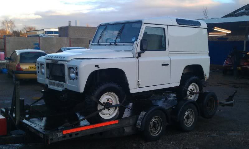

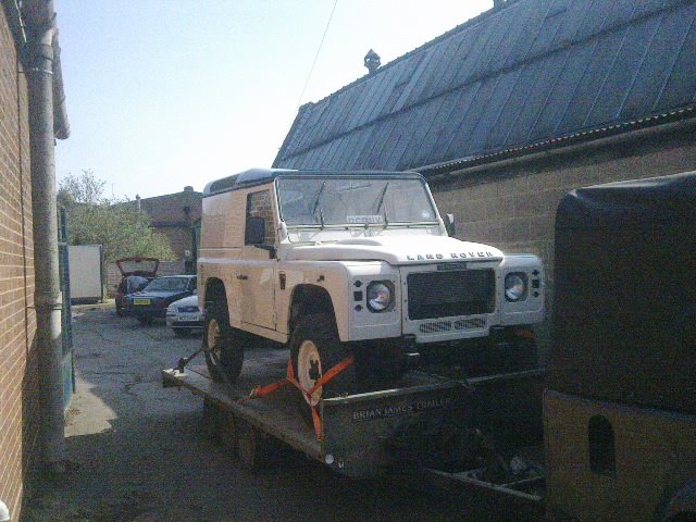

Take one looking sorry for itself (buy mechanically sound) Defender TD5... and get to work with...

Start...
Stripped down ready for the Gloss black roof, Wheel arches, Bodywork corrosion touch up, Bodywork buffing.
Coming home..

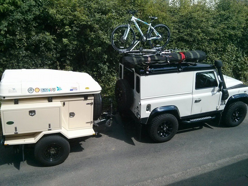

Roof bars will suffice for the odd trip
normal_10511323_10152163362632251_472328

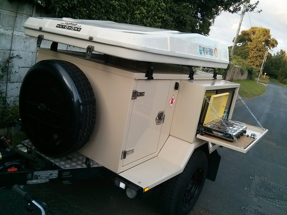

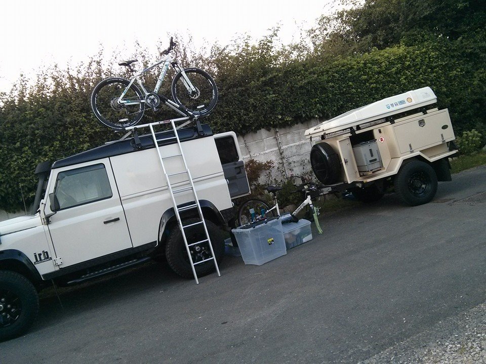

Fully loaded Expedition trailer. Maggiolina roof tent, Engel fridge, expedition battery etc..
