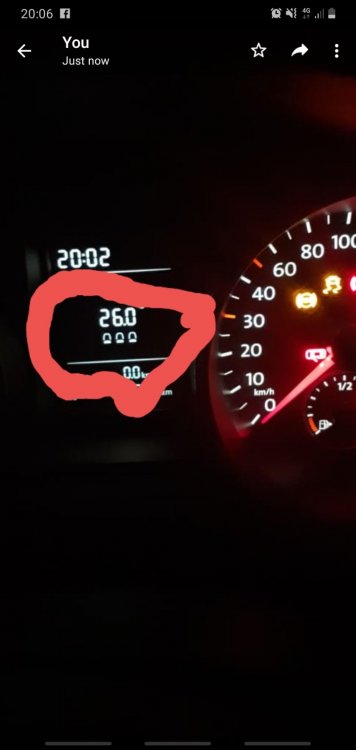

Hi. I have a Golf 6 seven speed, DSG gearbox , we replace the clutch nd release bearing, but still it dont want to go into gear, stand still like a donkey,  it shows 3 locks next each other on the dashboard,  can anybody help me pls,
Errrr.... I think they’re the rear seat seatbelt warning lights, not “lock” symbols or anything else to do with the clutch units in the DSG box?
Correct - they are rear seatbelt warning lights.
