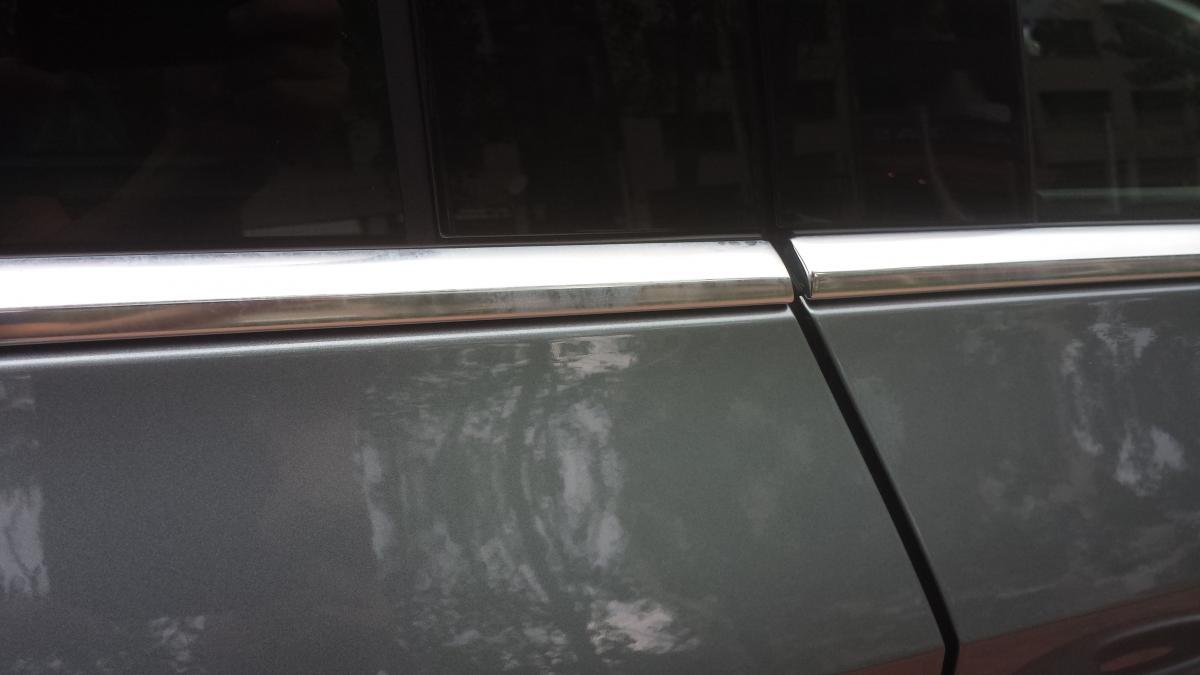

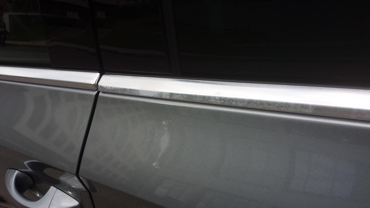

Since I get my car(3 months back) chrome strips (mostly of rear doors) become more and more matt. To be exact they are covered with some white spots and with every visit to car was seem to cover more and more space.
Even on the day I've pick it they were there, but was thinking it was because of bad chemistry used in clean reagent when first time washed before handover.
Is this only me or is wide spread? Does it worth to alert the dealer?

These should be a polished, chemically brightened and anodised extrusion. When you anodise over a polished surface you put create a thinner layer of oxidation on the surface to keep the finish bright. If not enough anodic film is created then the surface could start to corrode. Especially if they come into contact with low or high PH fluids. If you get your car washed at a hand car wash, it's likely that they have been exposed to fairly corrosive cleaners.
Sent from my SM-G925F using Tapatalk
First cleaning was in dealer workshop (no idea what they used). But car was picked after rain combined with dust and just looked like fingerprints....
I do not personally clean my car, just visiting a nearby wash center (probably 5-6 times since now). They use Ma-FRA products, and yes its a handwash car wash, But if the reagent used had high PH (or low) why only the back doors are affected?
P.s. Not quite sure if the chrome effect is exactly anodic applied, if you are right the ohm meter should show something (I'll test that a bit later)

P.s2 And something more, only the lower chrome elements of the doors are affected..

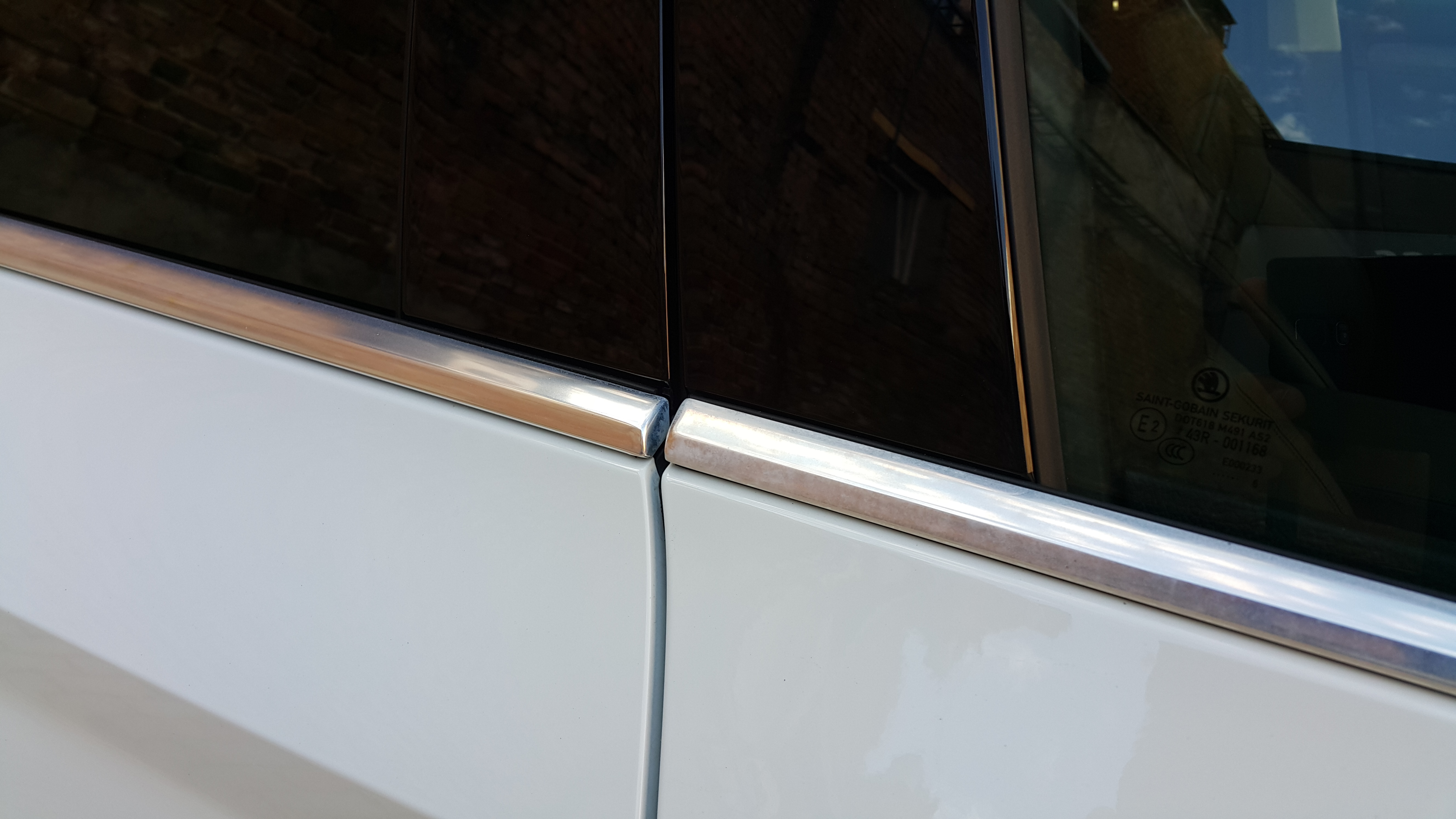

Dealer replaced the top chrome strips of one of the doors, but refused to confess guarantee for the lower part of the strips. Claimed reason was wash reagent too corrosive, or atmosphere conditions lol .
Most strange was that there were 6 superbs and all of them suffer in more or less part of the chrome desease, and only for that small lower chrome part.
Even the representative of the dealer confess its no sense as obviously materials  used for both parts are different and surely one have pure coverage protection.

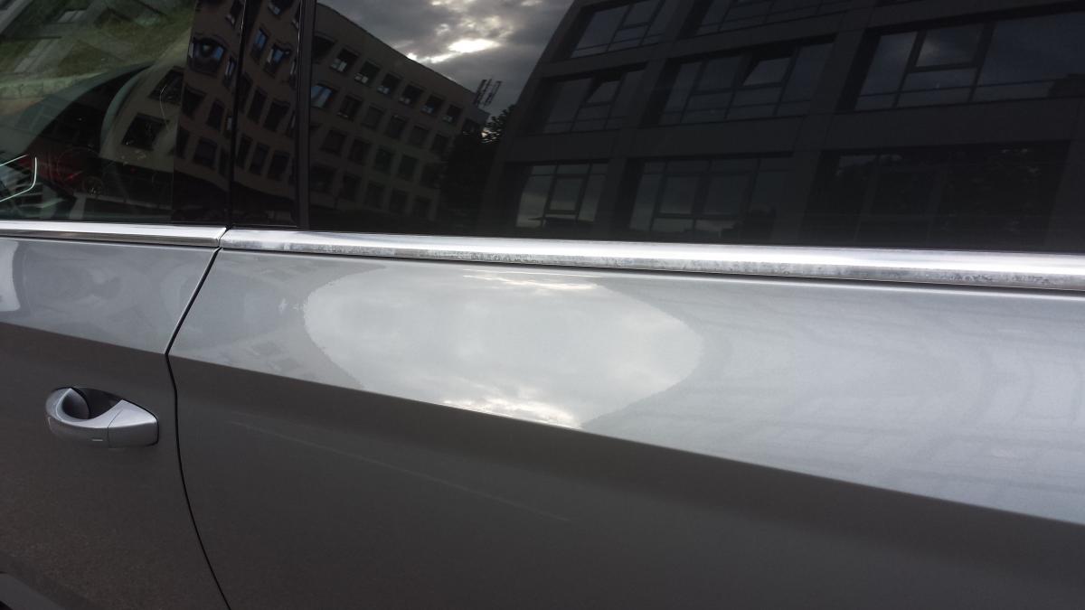

Went to the dealer today with the strip color change, they showed me the response from Skoda factory: "....damage to the chrome is caused chemically, by aggressive cleaning with PH more that  12.5 or bad diluted with water. Customer should change way of cleaning. This is not possible to change in terms of warranty. ...".

I provided them with the detergent's data sheet, where it reads that it has a EU certification
and does not exceed the PH level of 12,5% as set forth by manufacturer.
160901_Van Der Degreaser SDS 2015_LV.doc
as seen in the photos below
different parts of the auto body has not been affected equally by the detergent,
therefore it can not be blamed on detergent.
some parts are not affected at all

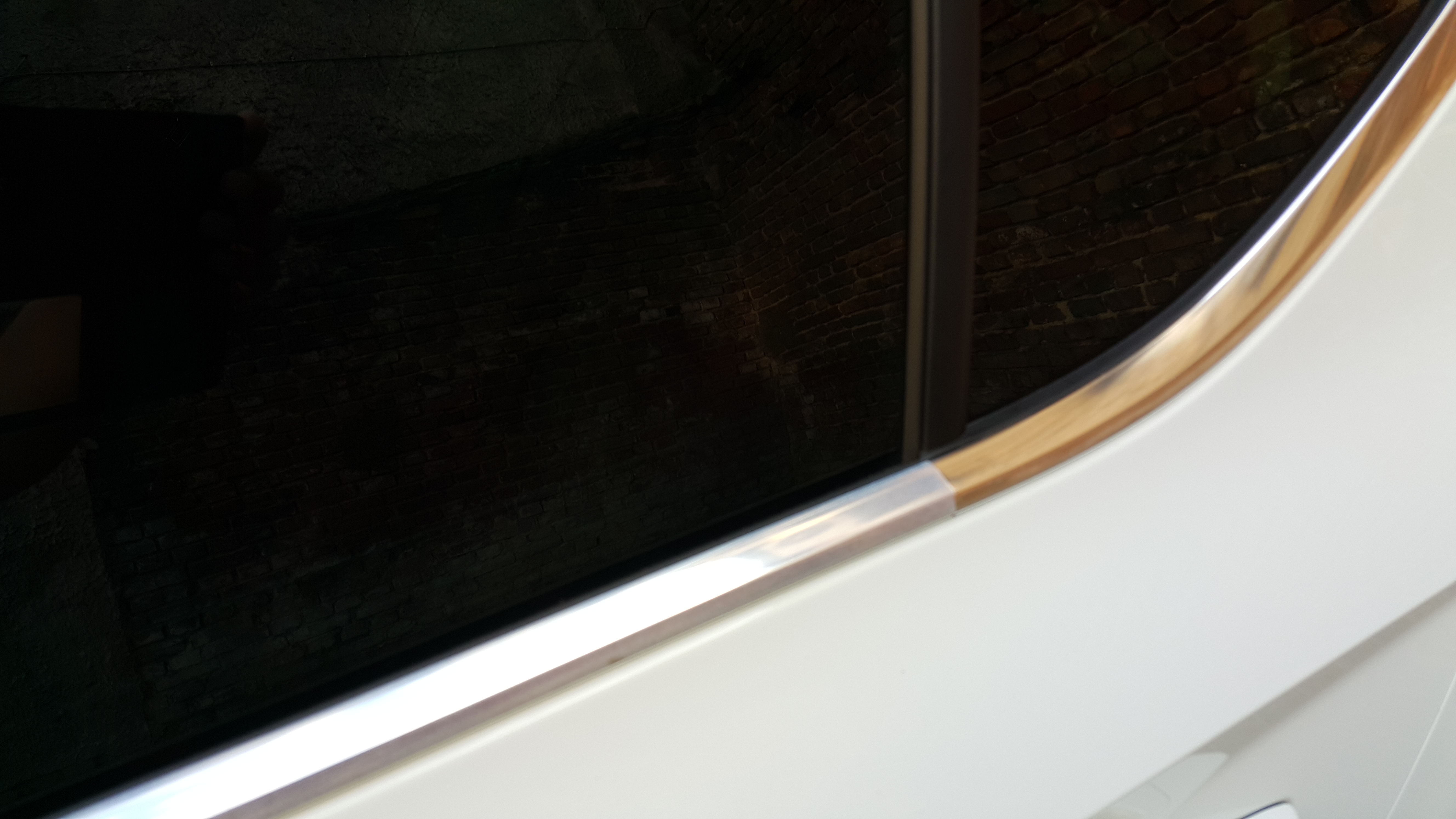

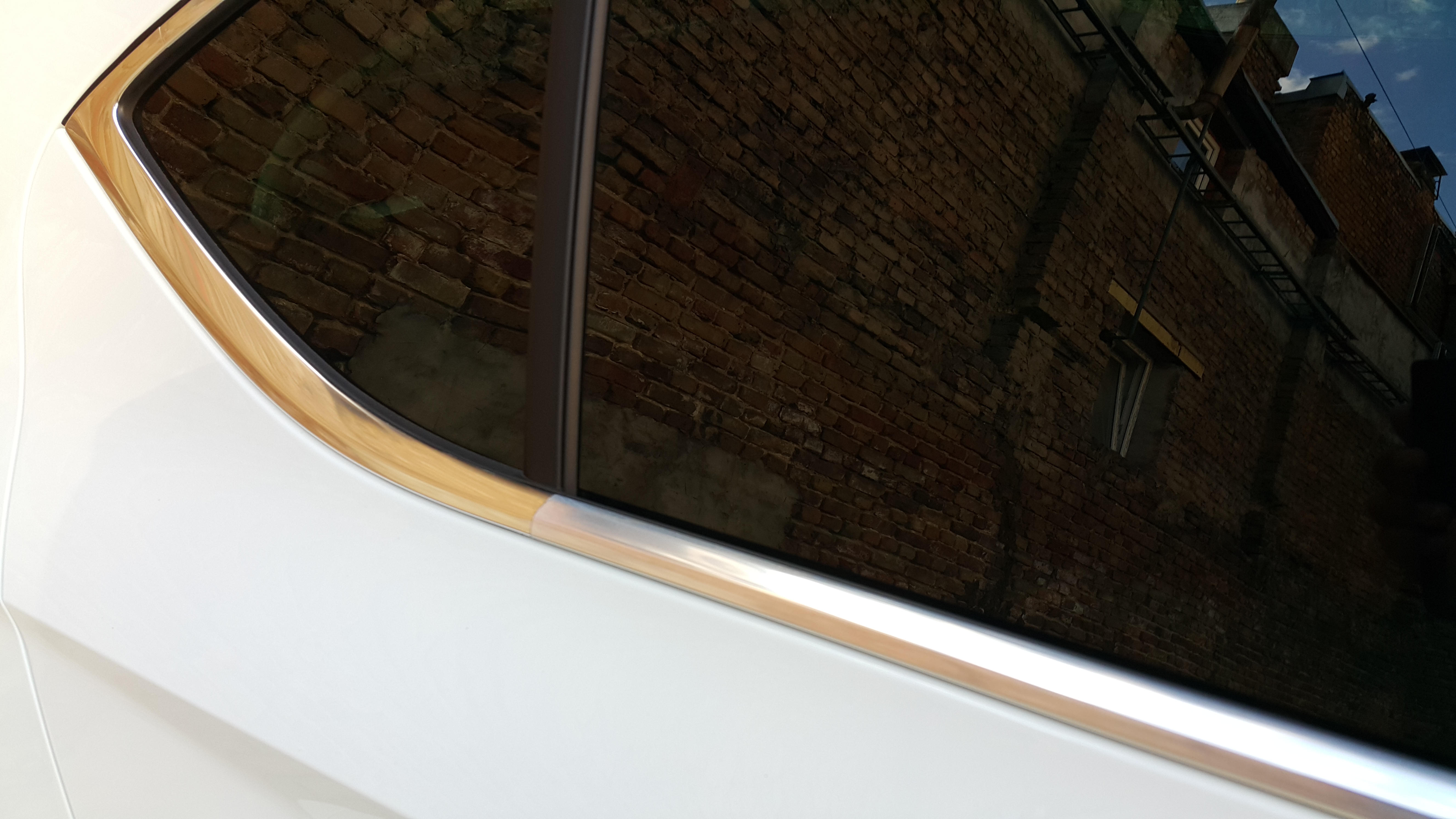

another part with dead "chrome"
dealer promised this will be covered by warranty, sent pictures to manufacturer, but after one week claim were rejected 😞
but mine lovely dealer found one used part, in perfect condition, and replaced it just for 20€
Had a similar situation on my S2 estate.  There was a thread on it.  General consensus was that it was a delamination of the strip caused by water ingress and not high PH cleaners.  Several people had manged to get dealer to repair as I remember (3 years ago).  Was a big deal on the estate as it meant changing the rear window fitting or something.  Anyway, some people had it repaired under warranty.

You're right - on the S2 estate the rear trim and the window are one part and it all has to be replaced.
