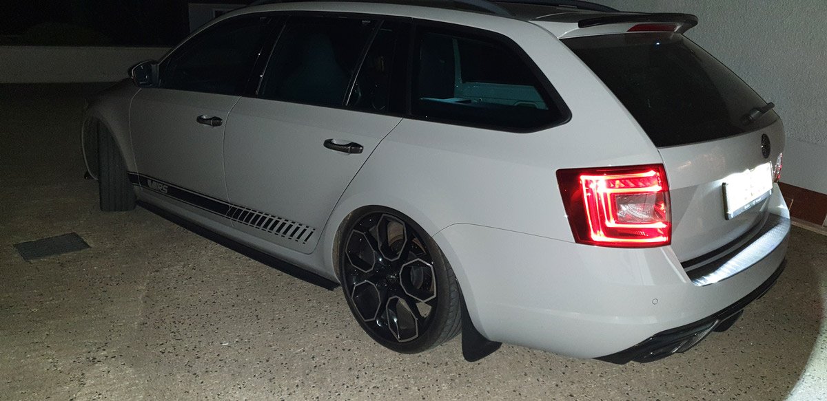

lowered 40mm with 20mm spacers and 300kgs of free weights in the boot = -ve arch gap :giggle:
by the way i drove 60 miles like this with no rubbing, banging or clattering at all :thumbup:

orchard2.jpg.0e961a5d2a05256bee7cb2e57f706184.jpgstripes.jpg.8c02d94042840a3ca927a3b559d451d1.jpg
You think you could get away with going 20 on the front?
cant see why not
Thank you just thought you would know with you having 15’s in your opinion it wouldn’t be too close to the wings? Just I have ordered 40mm H&M springs so would sit the same as yours thanks for your time
