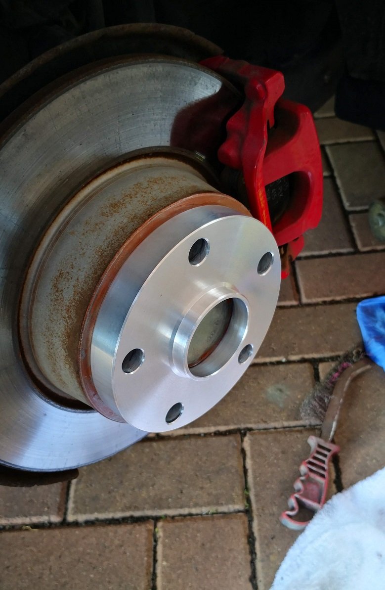

So im going to be fitting my spacers at the weekend (weather permitting) is there any special steps that need to be take or is it a case of:
remove the wheel
apply copper grease to hub
place spacer over hub
replace wheel
install new nuts and tighten
you need at least 45mm studs dont forget. thats about it. The spaceers are hub centric just line up the holes and you are good to go.

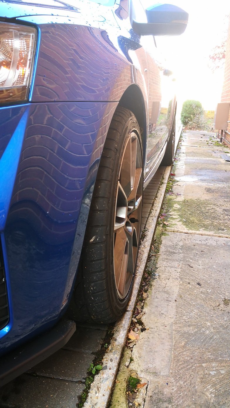

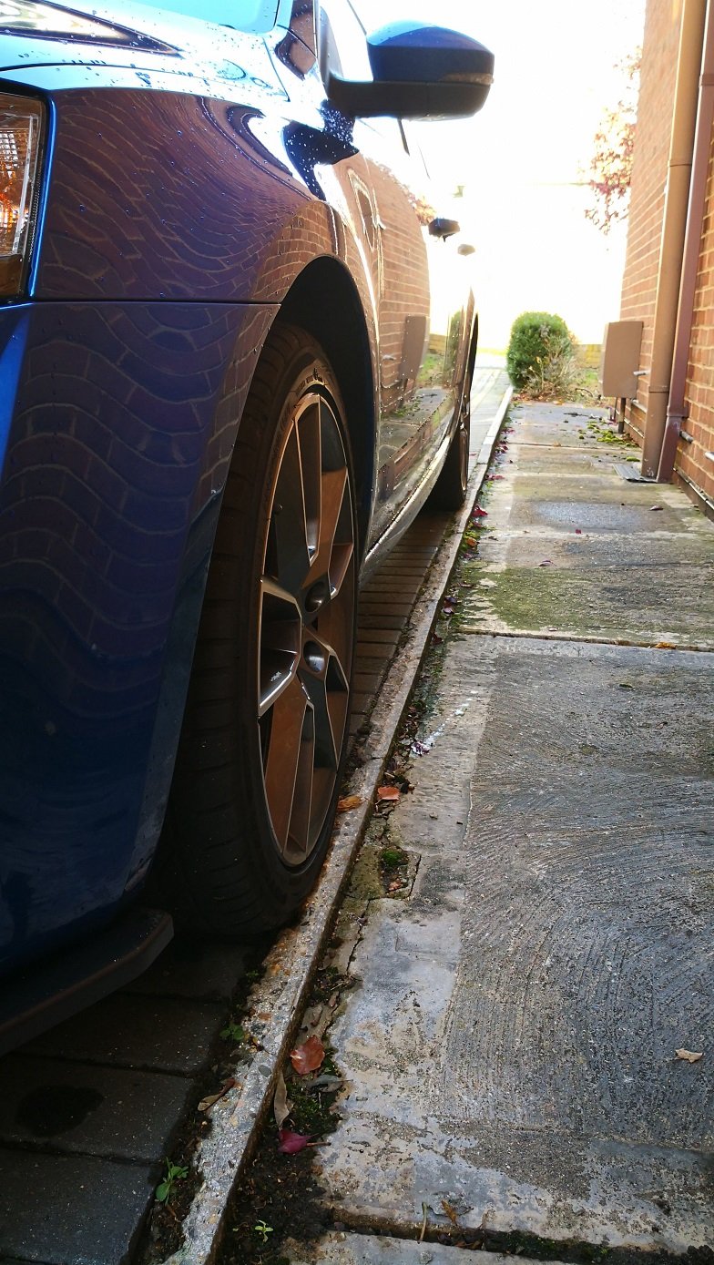

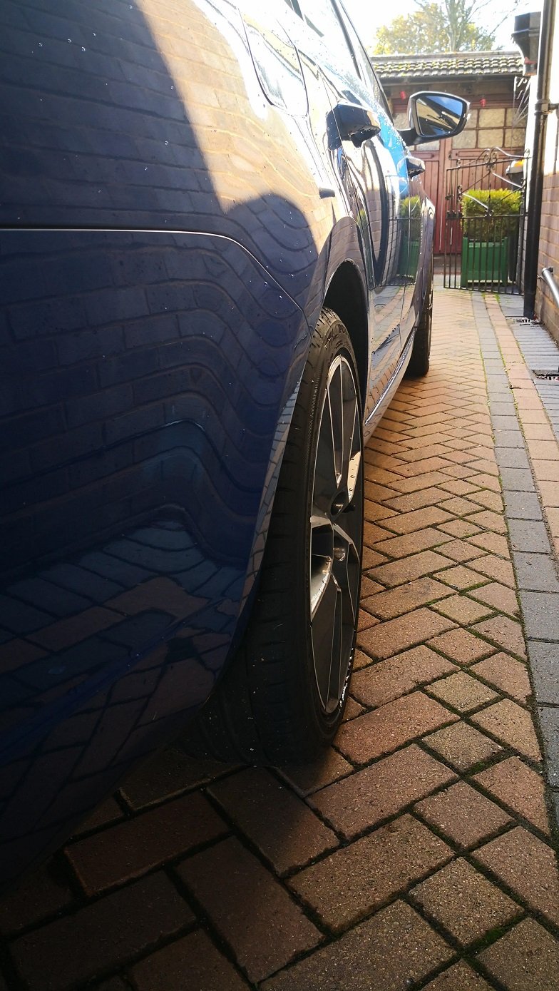

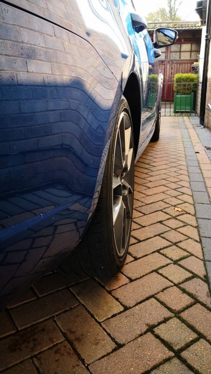

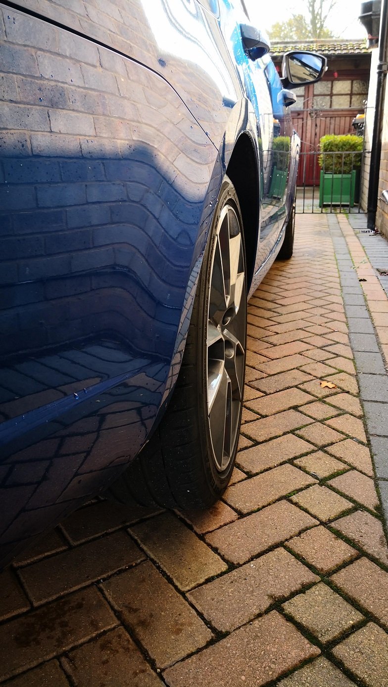

15mm Front
20mm rear
Before                                                                                                    After                                                                                                        Before                                                                        After
1692735624_RearoffsideBefore.thumb.jpg.8493c449e54cad6fe34fcd4916a5152b.jpg  49938495_RearoffsideAfter.thumb.jpg.ee9a4986f7f1ea15fe3f8ca31875b99d.jpg   344287806_frontnearsideBefore.thumb.jpg.d3ef714a05d53e657d1be131f0202db2.jpg   139725746_frontnearsideAfter.thumb.jpg.f9800d3f190da913924f8b1d8f10c97d.jpg
BlockABoots, I was going to fit my spacers this weekend (same supplier as you, Watfields) but I was a little put off when I had a trial look as the spacers didn't fill the entire hub which is the same as yours (where you can still see the copper grease) did it not worry you, I've been trying to find other examples online but couldn't...
it does look odd... mine are H&R and are flush with the edge.
I did think it odd, but its about a 1.5cm different, have you contacted Watfields at all about the issue?.
With the alloy wheel laying face down did you try inserting the spacer in the wheel (like it would be if fitting it to the car) to see if there was any 'play' when inserted in the alloy wheel?
Im not sure it would make them less save would it?, as is actually the centre 'lip' part that the wheel slots onto not the outer part of the hub? and its not the outer part that supports the wheel its the clamping of the tightening of the bots over the center lip of the hub...or in this case the spacer, hence whey their hub-centric??
