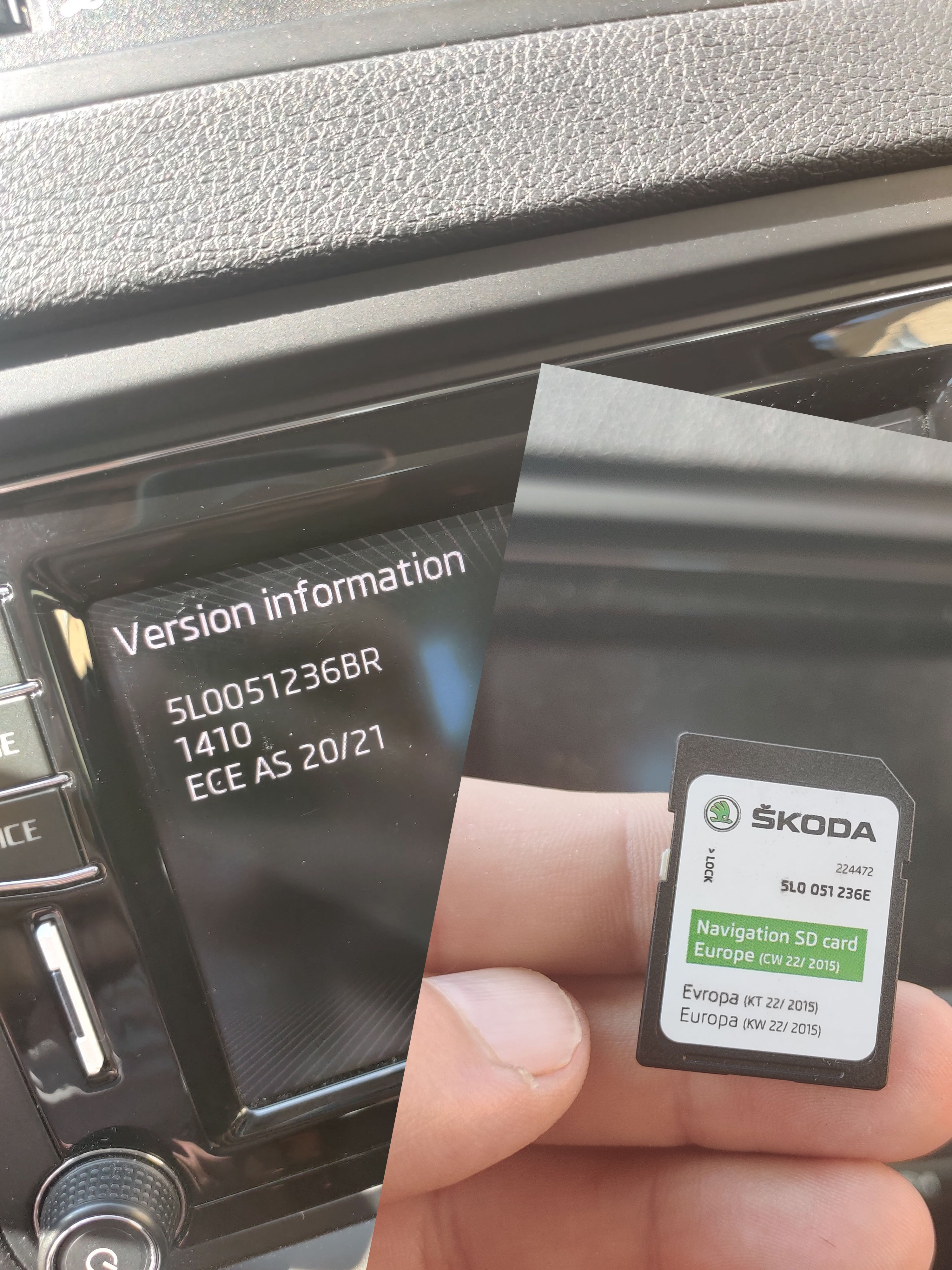

the zip is 14.8 GB unpacked its 15.07GB. As I said before it's 15GB and as I pointed out earlier in  an earlier post I have no idea
why they're indicating that it requires a 32GB card when you without any problems can put the maps on the 16GB card.
I can understand that they wanna indicate that the folders are increasing in size but at that point they need to be able to provide us with new 32GB cards
but the last three updates has all been around 14-15GB unpacked and haven't increased much in size maybe a few 50-100MB.
Using the card from 2015 that's 16GB as seen in the picture attached and the new version of the maps.

Much newer Skoda sat-navs  use 32gb cards so I can see no reason Skoda need to supply a 32gb card for  sat-navs that are no longer made.
I'll ask again have you updated your 16gb SD card with that new map and can confirm it is working?

Yeah I just attached pictures of it I hope that will be enough as proof for you :)

I did not see that as we posted at the same time and you had not answered my earlier question as to whether it was working.
IT WORKS!
Question now is if they have done something wrong with the updates or if it's supposed to be the same versions as 6months ago.
