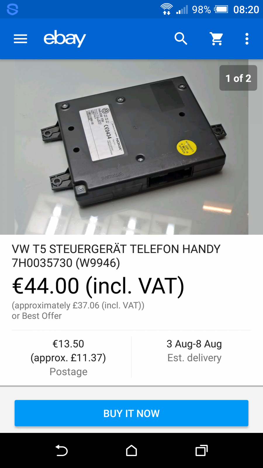

Like this, do I just need the harness and mic?!
Scrap that this doesn't!
I don't recognise that one mate, it looks like it could be an older unit.  Stick the part numbers I gave you into ebay.  I think £100 is reasonable including harness these days although I'm not as up on the pricing as I was.

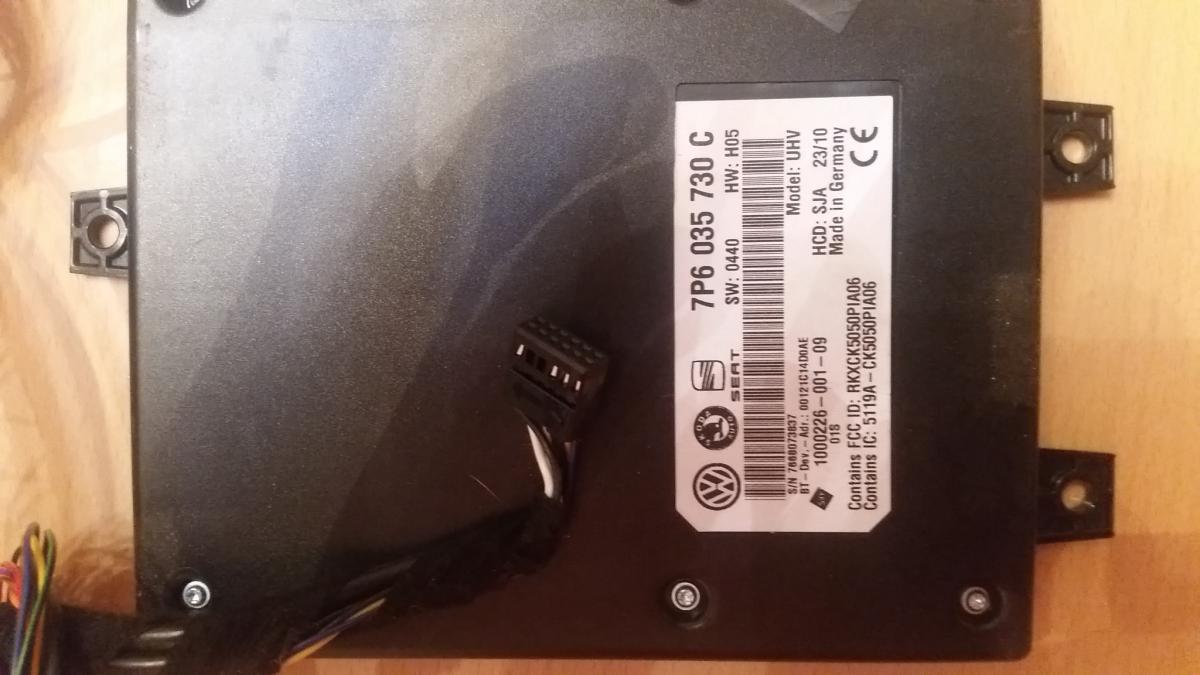

Does anyone know if my newly fitted Columbus and Bluetooth module need to be coded together in order for the Bluetooth to show up on the Columbus unit under PHONE? I've tried connecting the Bluetooth to the Columbus but it's not picking it up???
The car needs to be told there's a phone kit fitted, otherwise it won't be able to communicate properly. Also, some phone kits need the Maxidot and MFSW to connect and pair a phone.
Edit: If you have a 7P6 035 730 C module then it's only possible to pair a phone with MFSW and Maxidot, I think. If you don't have these then you can't pair a phone I reckon...
Edited by Rustynuts
I hope not I'll be well annoyed if so coz I've heard different. What module do I need then if I don't have MFSW or Maxidot?
I don't know to be honest. I think the later 7P6 035 730 J onwards are okay, but I'm not an expert on them. There's just too many for my old brain to keep up with I'm afraid, but I'd like to know if you get an answer.
