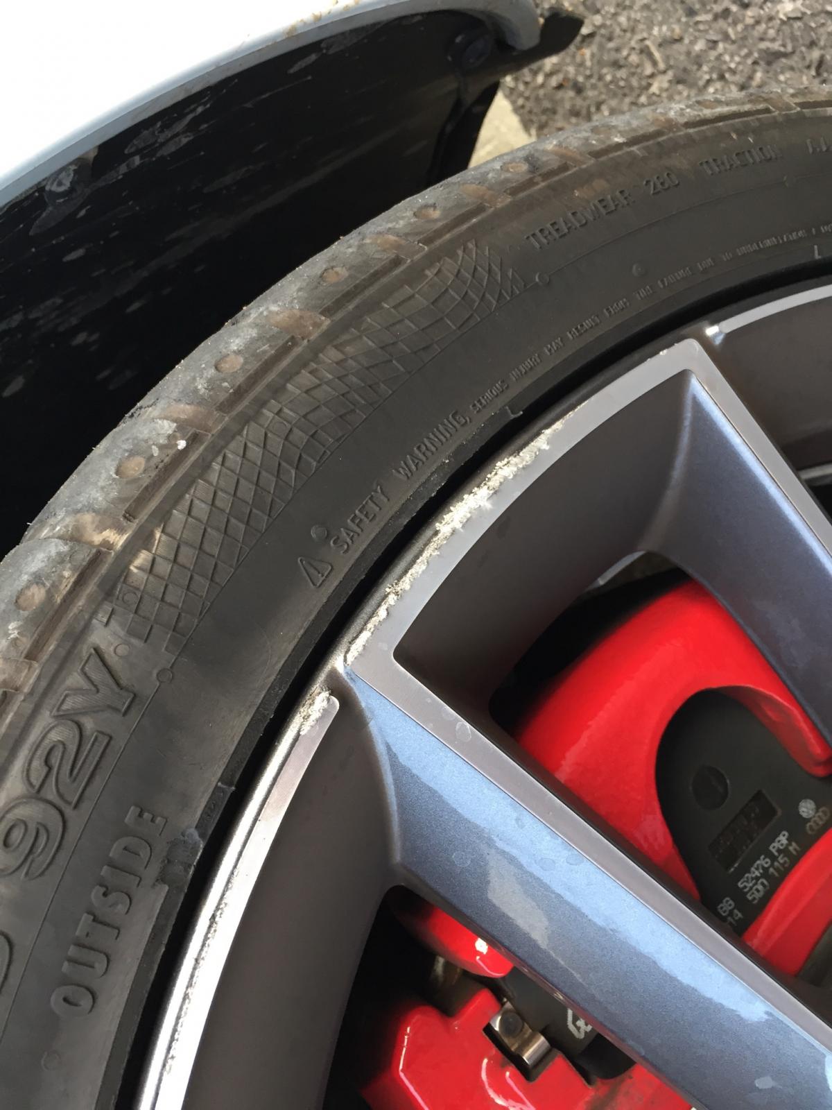

As per title really, the missus thought she'd play chicken with a kerb and ballsed up 2 alloys.
has anyone else come across repairing these diamond cut wheels made of butter? Any recommendations of alloy wheel refurbishments in the northwest?
I'm aware they'll be a full refurb job.

Front passenger ding 1:
Front passenger ding 2:
Rear passenger:

The only way to get a satisfactory repair that won't look **** is to have them refurbished properly and re cut.
I've seen some shocking dealer/smart bodges that look **** right from the off and get ****ter after a few washes.
The only trouble with getting wheels recut is depending on the design it can look pretty obvious. Both Gemini and extremes both have thin bands of machined finish which will widen when the damage is removed. Obviously the deeper the damage the more they would have to take off.
Thankfully for you both wheels are on the same side so at least each side of the car should match
They look like shallow gouges to me - I had similar and I was very pleased with the results from a mobile wheel service. Not noticeable when off and close up' and invisible when back on the car. Give it a try - if you get a decent repairer they will pipe up if the finish will be no good.
Mine was worse than this. Bump n scuff in carlisle fixed it for £80. Next day turnaround. They do it on a lathe so you get the proper diamond cut finish then they relacquer the whole wheel.

Thanks for the replies guys, had a few quotes ranging from £85 to £130 per wheel, to fully strip the wheels and CNC the faces, tempted to refurbish the 2 damaged wheels and powder coat all 4 to black ala the vRS 230.
We use 'the wheel specialists' in manchester. £95+Vat for a wheel. Not he cheapest but we've had loads of diamond cut done for our customers from M3 to Bentley and they are worth every penny.
The advantage to doing this that Halfords' bog standard gloss black touch up pen will match the painted bits of your alloys perfectly, if anything else happens to them in the future.....
