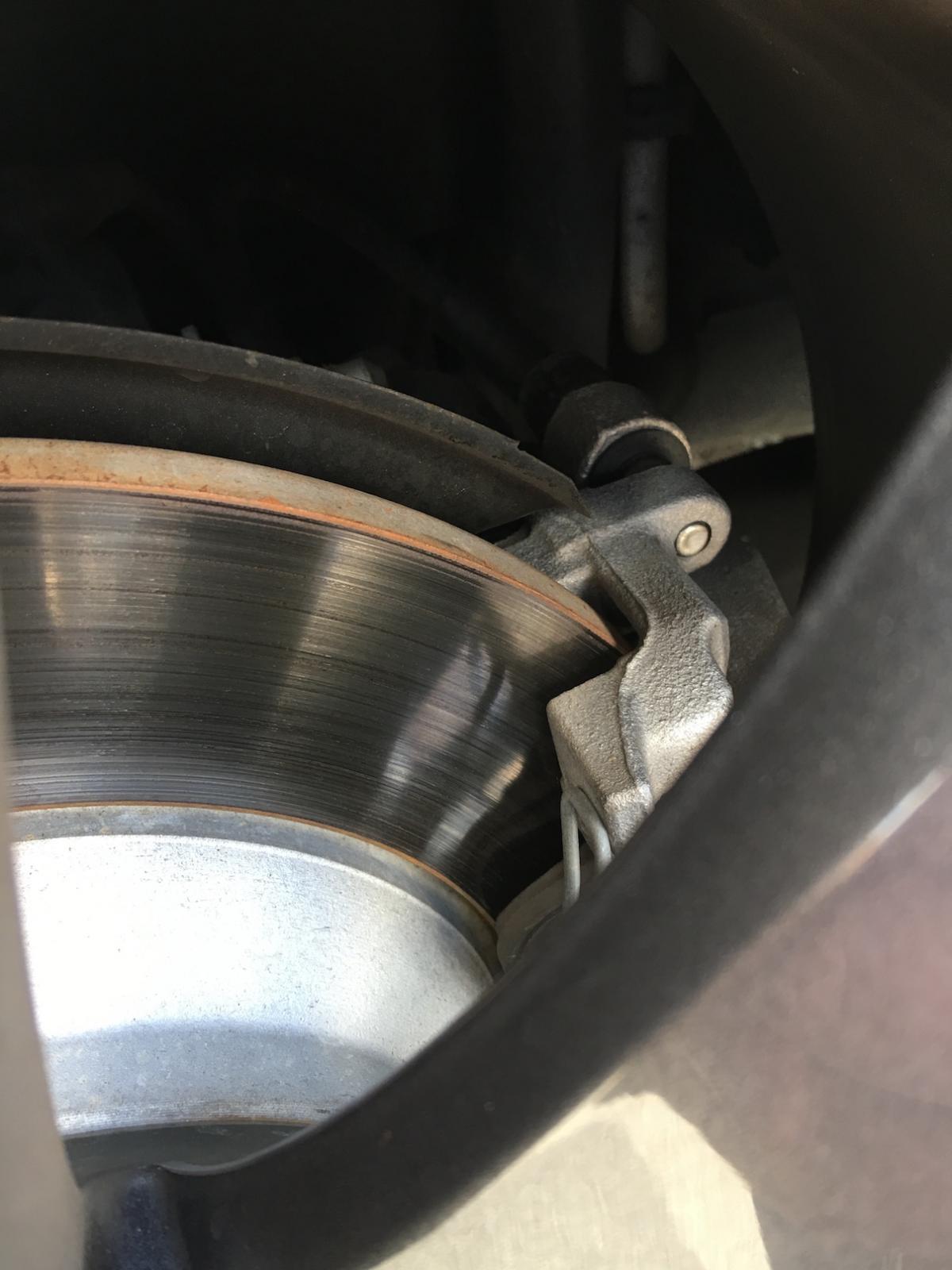

This is how the front nearside disc looks on my 1.4 petrol manual (so not a big heavy engine over the front end)
Car has done 10500 miles, 80% I would reckon have been motorway miles. Long term fuel consumption is about 50mpg which tells you car is driven in a manner that keeps off the brakes. Mostly it's just me in the car and some shirts and an overnight bag.

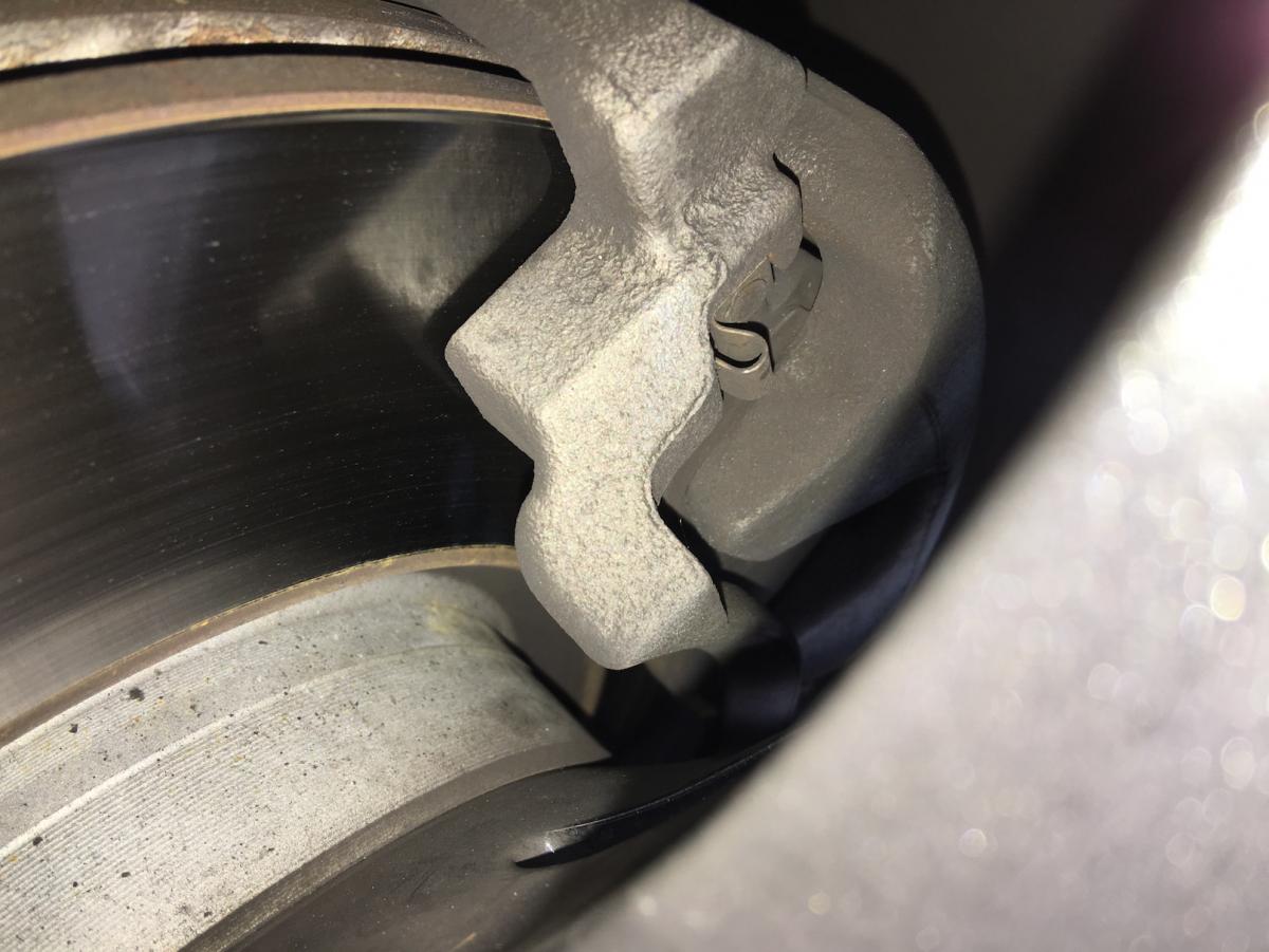

In contrast this is the near side rear disc

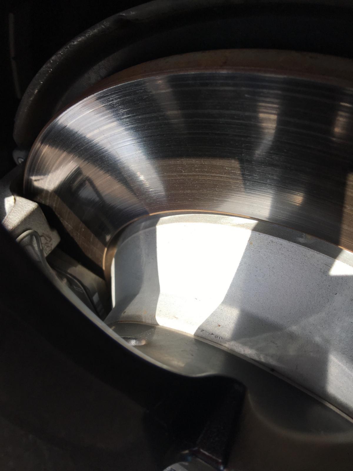

And the off side
Don't look good in my non trained mechanic mind. The front wheels get covered in loads more brake dust indicating as we expect that the front wheels do the majority of the braking effect (although I appreciate the front pads are twice the size as the rears)
Drive with the windows open at low speed and you can hear the rear pads dragging on the discs. They rust up quickly too compared with the fronts which tells me one of two things, the discs are some sort of soft iron particularly to score up so badly, or pads don't release sufficiently and get hot. Repeated overheating leads to the metal corroding quickly.

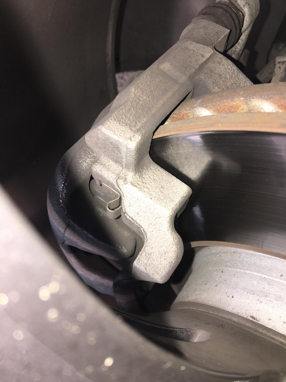

Rear Offside
Rear Nearside

It's worth making a fuss about and trying I think. As people have said, given the front brakes do more of the actual braking, if the rear are in much worse condition then there is cause to argue that there must be something not right. After all the worst they can say is no :)
i think the braking split between front and rear is far greater at the front, however you would expect any force of braking would leave the discs clean.

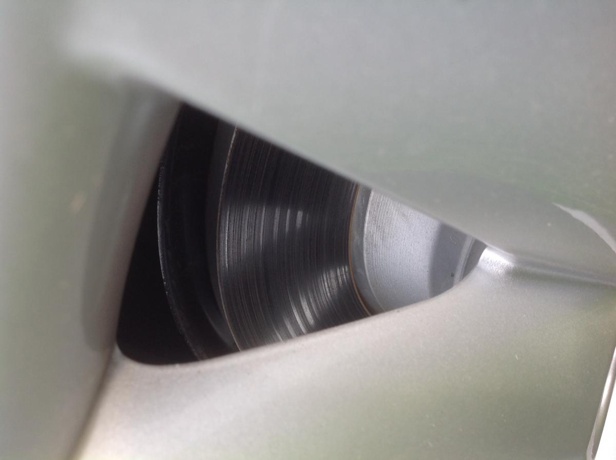

Here are mine at 12.5k. Auto hold has been on from day one and I always employ the parking brake at stops longer than a few seconds. I also let it release automatically.
I usually carry a lot of gear in the boot and I do partake in some heavy braking on occasions.
Fronts look ok, rears not so good.

O/S rear
N/S rear
