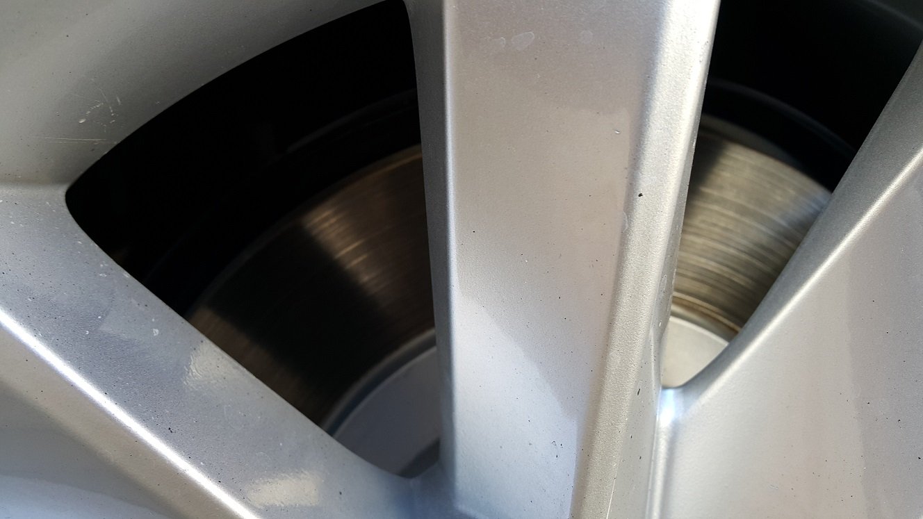

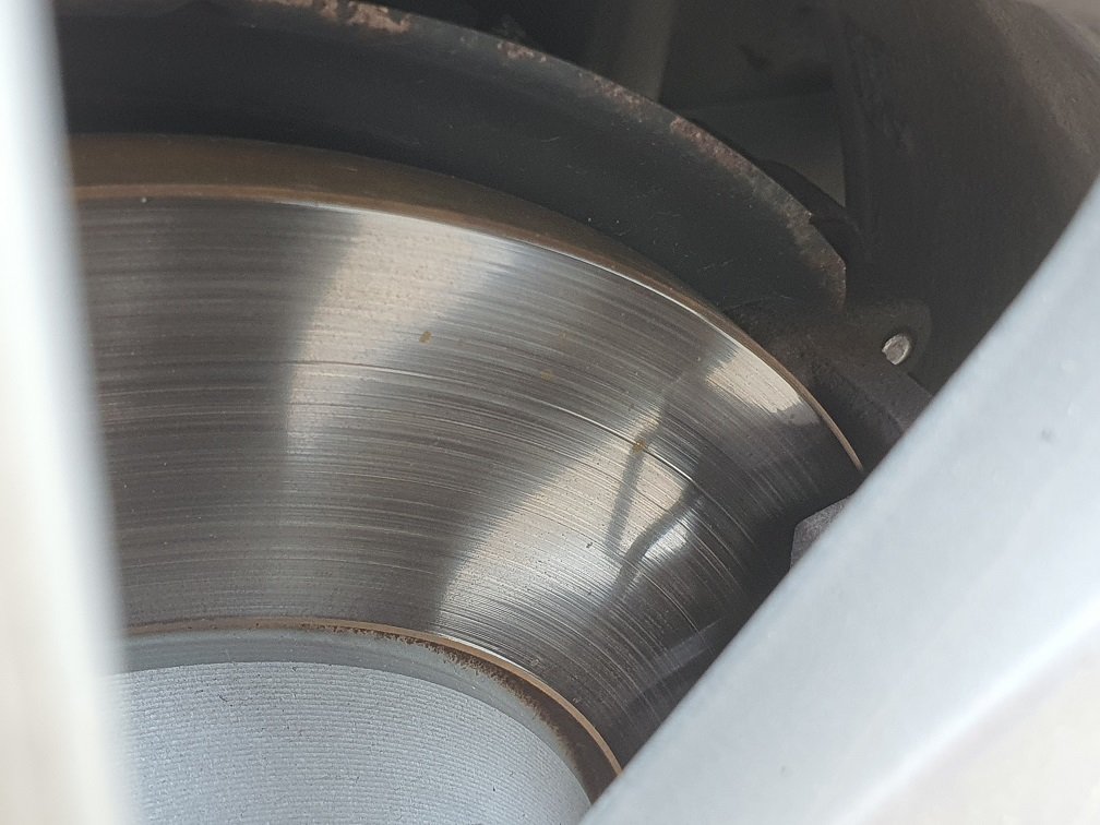

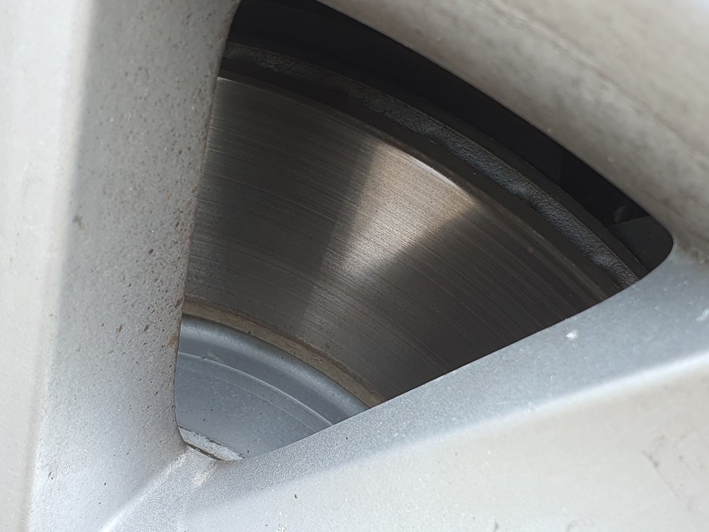

Can't say there is day and night diff,
but Zimmermanns looks better than stock, compare -
original Rear disc after 11k Km
Zimmermann Rear after 10k Km
20200703_Otto_Zimmermann_Rear_10kKm_01_25p.thumb.jpg.e9877c7dda8bade637ce0b1d09de4b47.jpg

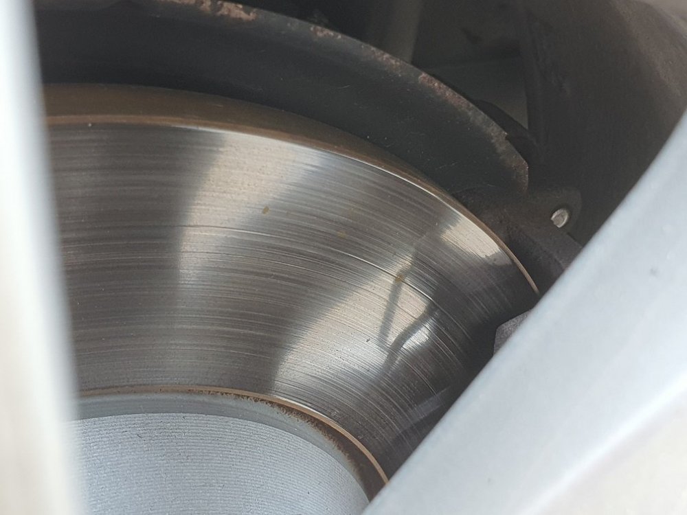

front's are almost equal
orig.
Zimmermann
20200703_Otto_Zimmermann_Front_10kKm_01_25p.thumb.jpg.34d23176aa3604b83b01be2487d373f6.jpg
