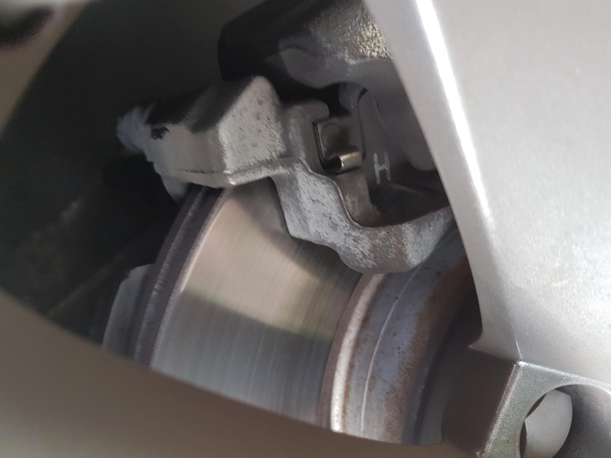

My mate has a 2015 GT trim 190 Passat...
He has 10k on it now...
Here are his rear disc's

    Hello all, I've been following g this post with interest.. please be nice to me I don't own a Skoda Superb, I have a Mondeo MK5 Powershift. It's done 12k miles and is a year old and also has an elect

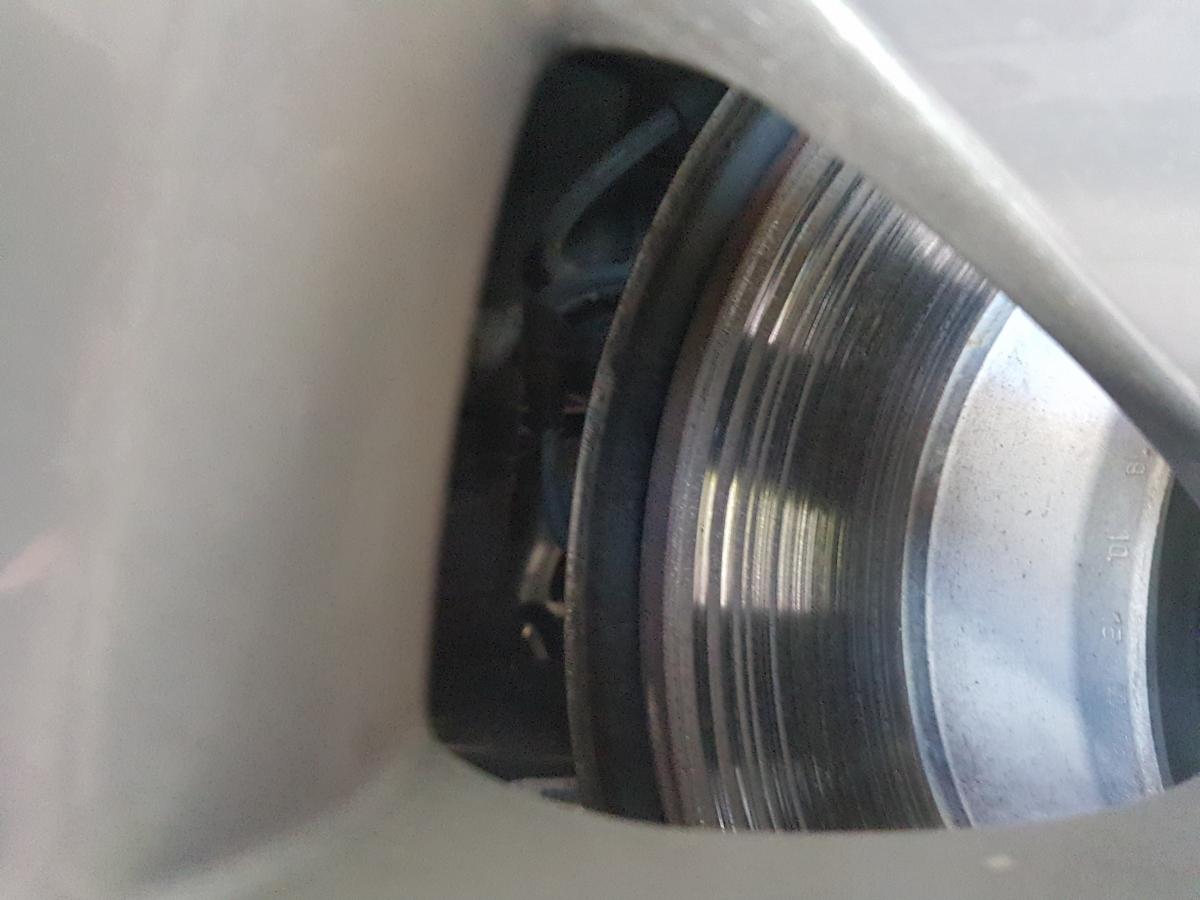

same problem. Problem?!? No, Škoda's "phenomeneon"
10k km on odo

The rears score as they have the pads dragging due to auto adjuster and get sh1te flicked up from front wheels

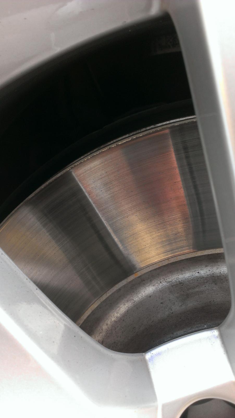

My rear disks are completely shot after 9 months and 17k miles. Mostly motorway miles too. I took it to the dealer yesterday who said it was dirt, or the esp, anything really apart from the electric brake sticking on which I would think is the main suspect.
The fronts however look like they've just come out of the factory, so there's something not right.

Regardless of 9 moths or 17k, the rear discs should not need replacing so soon.

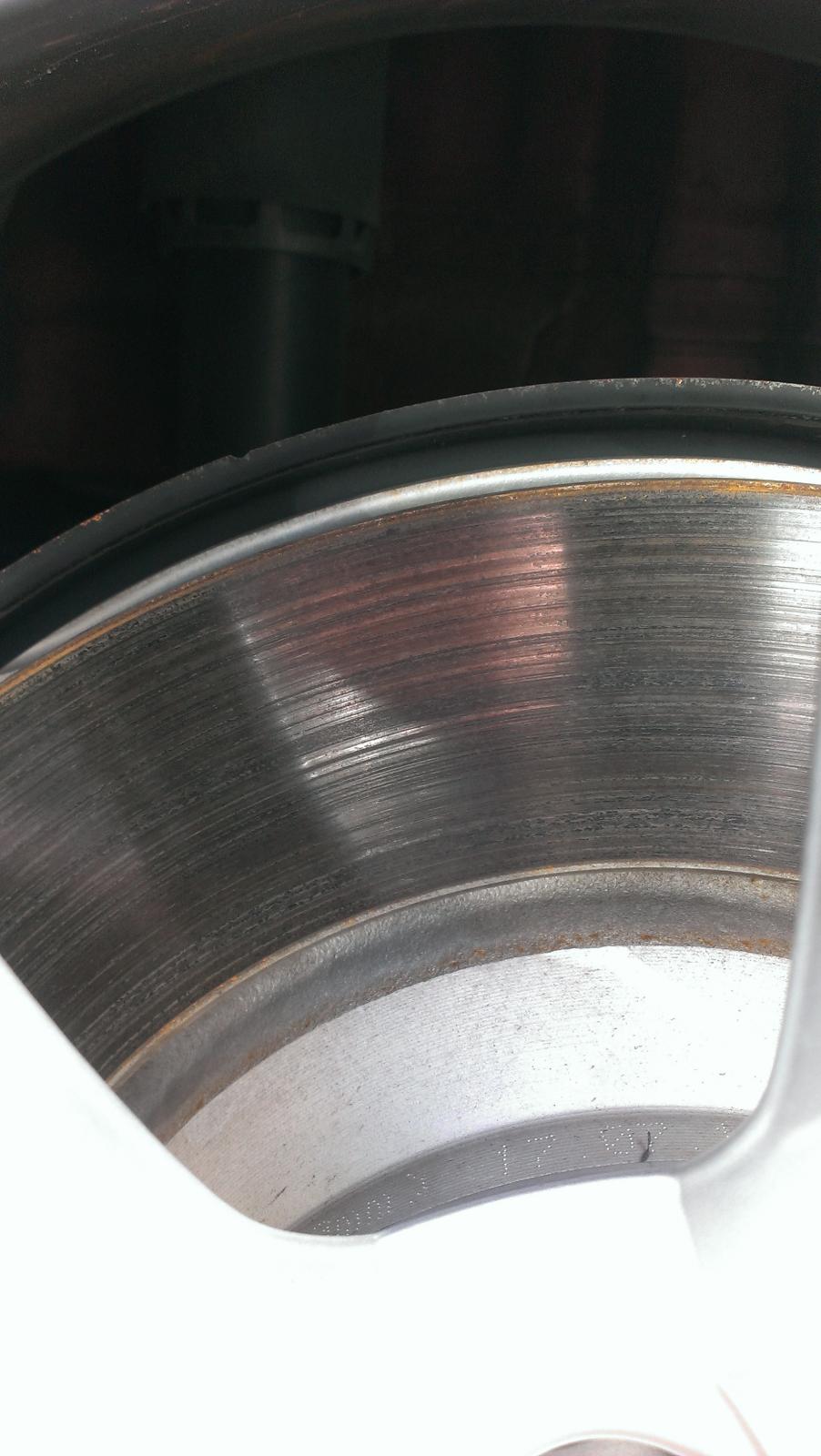

Offside front vs Offside rear

The dealer I spoke too said they had received a notification from Skoda saying there is a problem with scratching of the disks, he said the remedy was to clean the brake pads and the braking function isn't affected. I questioned that saying "how are they dirty on the both sides scratching the same pattern into the disk?", to which the conversation moved to suggesting it the ESP which I don't buy for second.
I rang Skoda customer care line to see if they knew details of the dirty pads notice, and they haven't had anything reported on the vehicle. I've got a dealer nearer to work who have previously seemed more reliable in my experience, so I'll pop in there this week and see what they say.

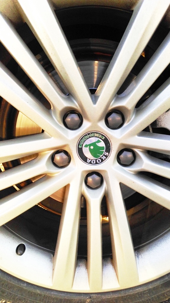

I took a picture - perhaps it is more relvant this way - of my rear wheel.
It is clearly visible that the disc protection is very well engineered, in the upper part it is well "dressing" the disc and in the lower side it is 2 fingers lower than the disc itself, to provide good cover to the disc, because the debris from he road are thrown towards the lower side of the wheel.
Mind you these are the OEM discs in the picture, the car has 50,000 miles
