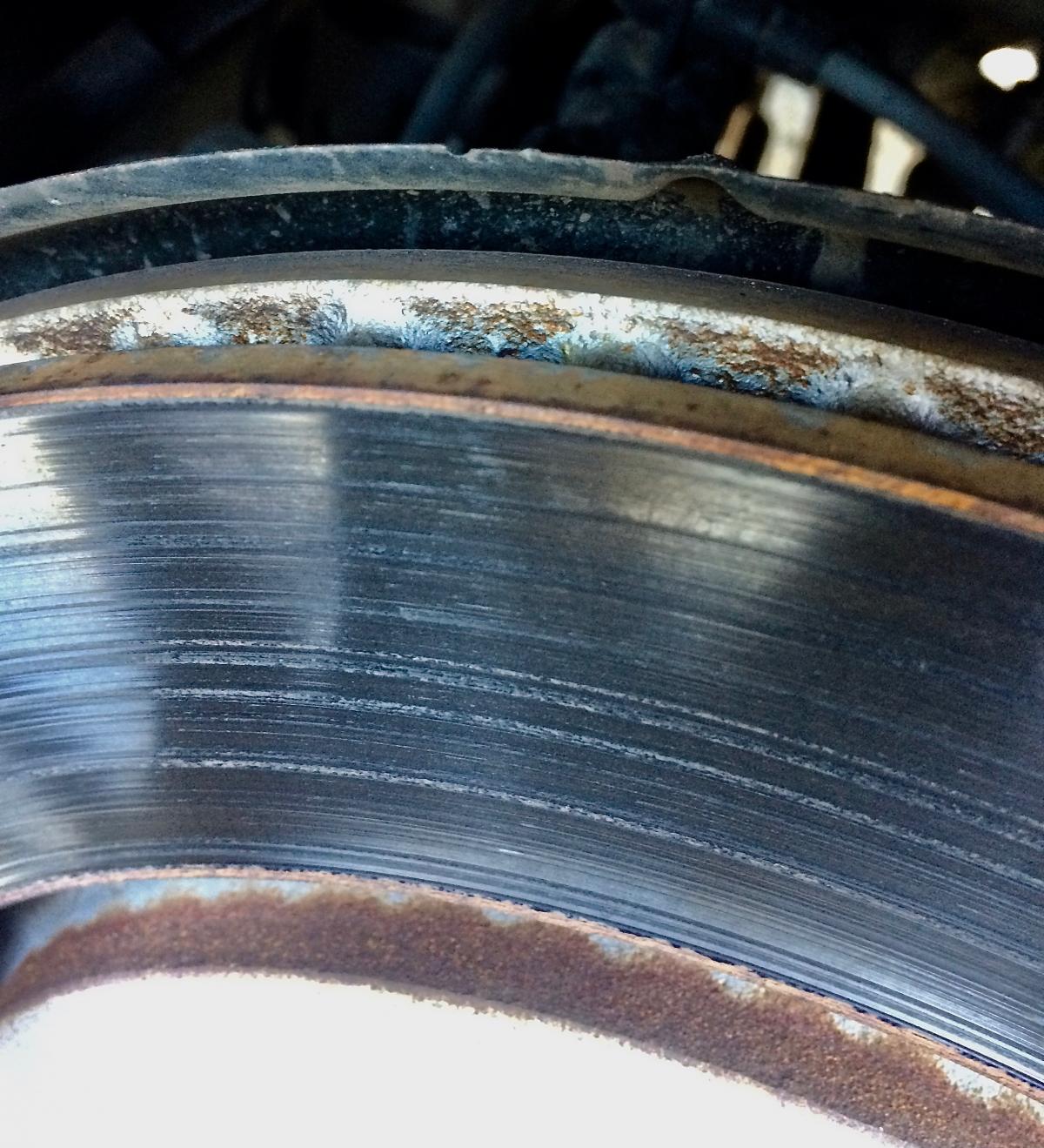

The last time i checked my discs a week or so back they where in a bad way surface wise (after a drive) with only approx 25% surface clear from the pads.. (see previous posts)
However i have checked them tonight (it is dark) but in fairness the surface does not look that bad and seems the full surface has been cleared...  The outer edge is covered in rust, but the outer surface is clean...
The only thing i can think of which has been different is we have a good covering in snow at the weekend and a lot of ice and at one point i had the ABS kicking in continuously.. (while going 5mph on our street) so i wonder if maybe the rear calipers kicked into life cleaning the surface?

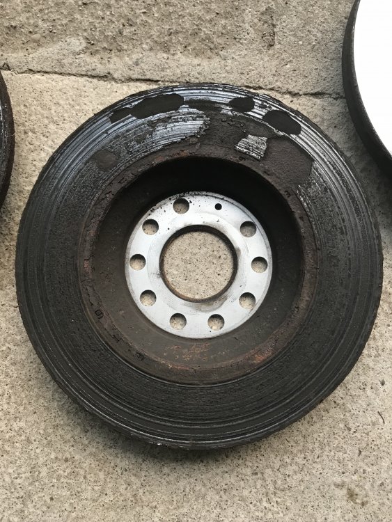

This is a photo of one of my rear brake discs from my 66 plate Superb which has covered 37k miles and is driven regularly!!
This is not normal and something I’ve never experienced before in any other car. The issue with my model (SE L Executive with electronic parking brake) is that there are no aftermarket discs available, only Skoda ones!!
My God! That looks terrible. The scoring is diabolical but those patches are something I have never seen before on a car.
Welcome to the forum.
Loads of After Market Discs available, even the cheapest crappiest that you can find will be better than the Skoda OEM ones.
