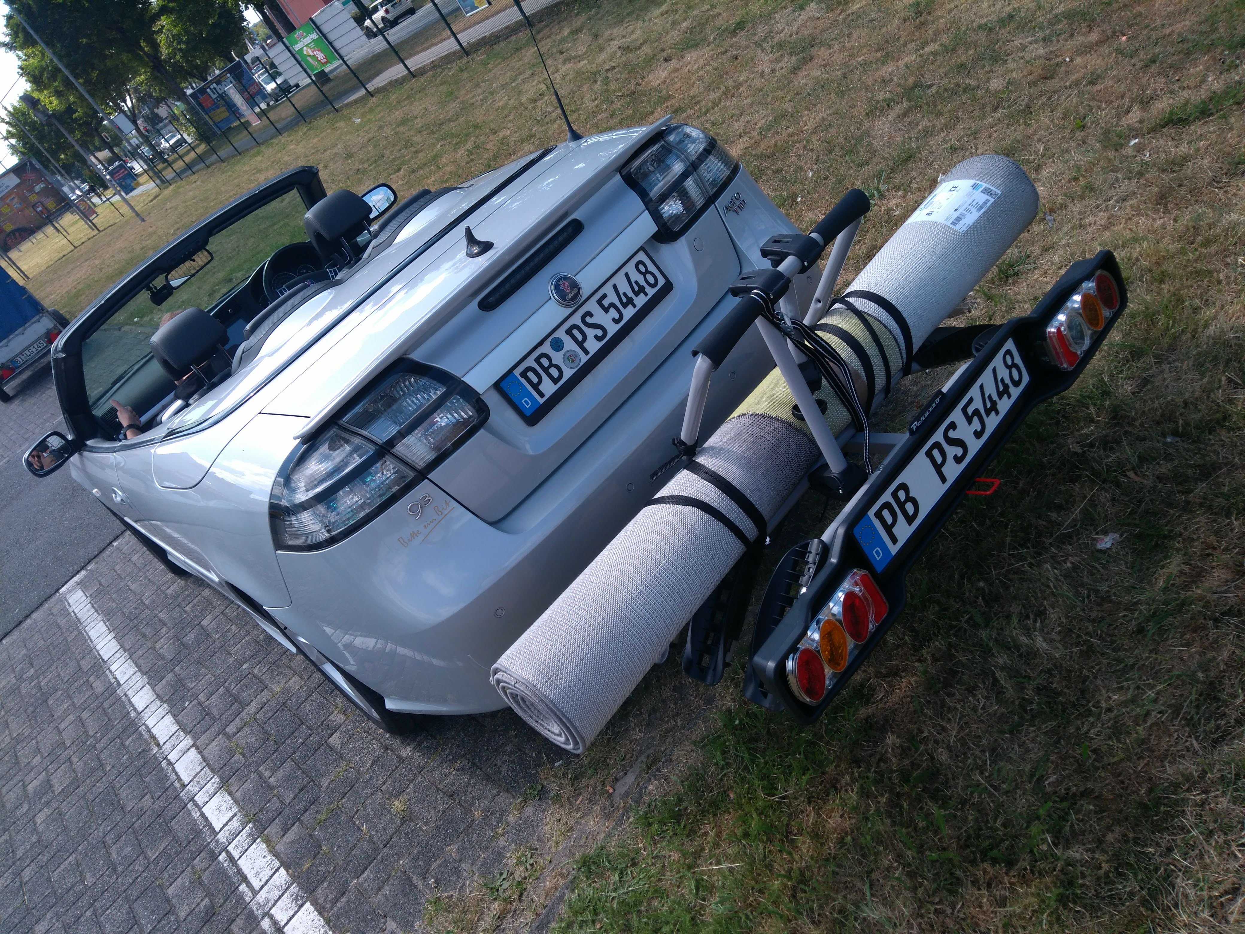

Took all the documentation to the city council to register the car (Everyone goes in person to the office with their number plates in hand when they have a new TUV or to re-register the car etc since the plate has little discs on that indicate the TUV status etc).
After a bit of faffing around (Germans love their paperwork!) it now has a German number plate and told DVLA it's been exported etc.

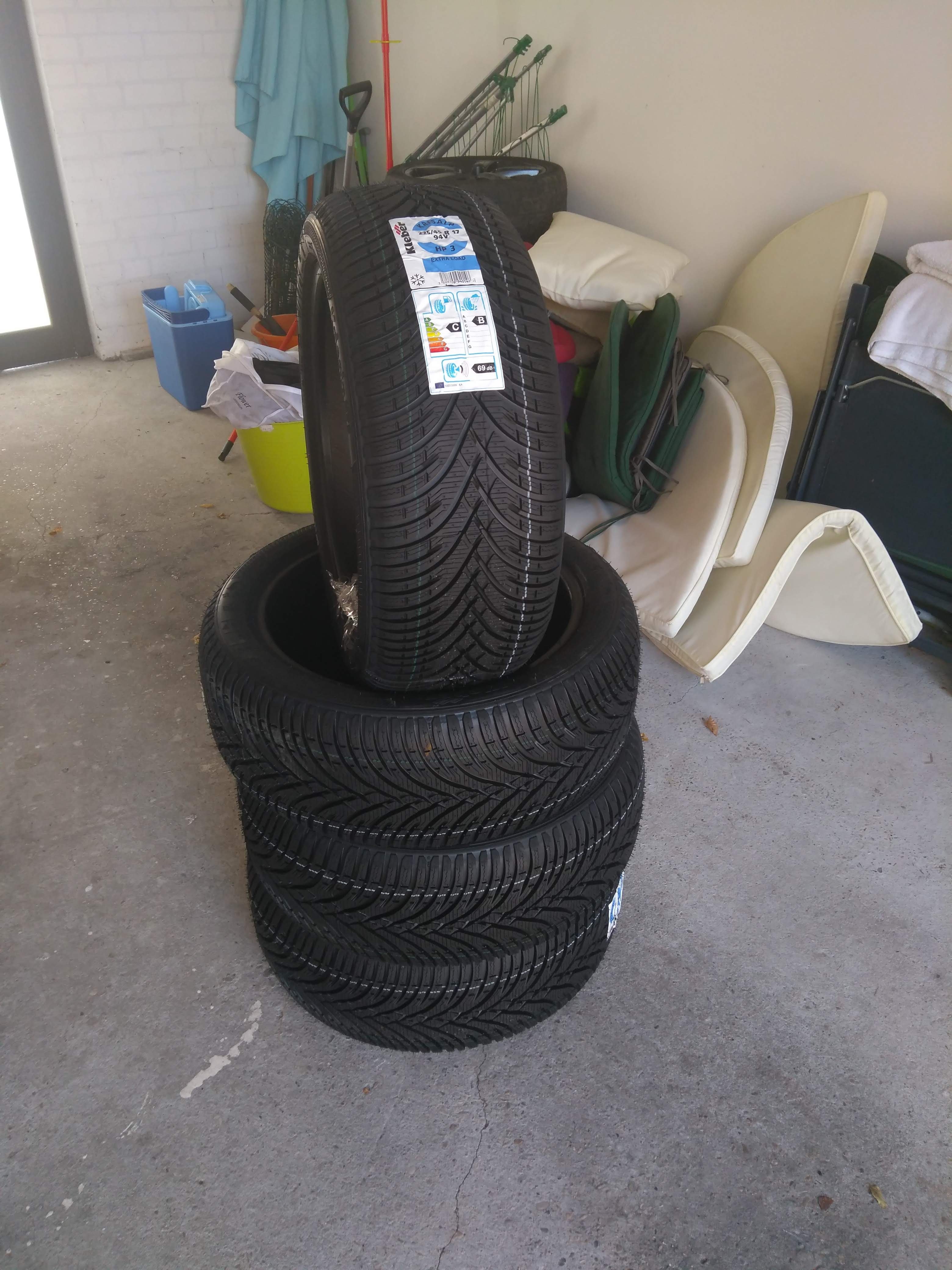

Bought the winter tyres while they're still cheap (legal requirement here).
