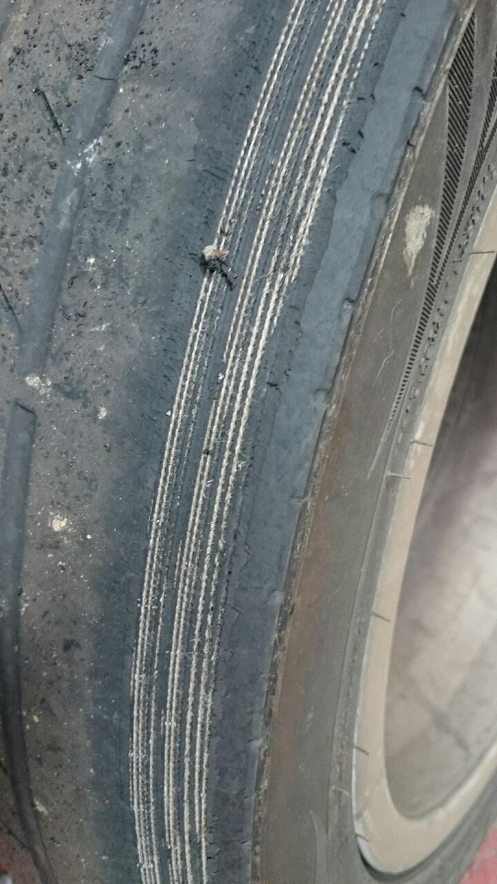

I had a bit of a shock when I discovered that both my rear tires were down to the core on the inside edge of the tire.  I have a 2007 octavia estate Lauren and Klement with the 225/45 17s.
The tire place said the toe and camber was way out.  They adjusted the toe both sides and did the camber on the OS but said that it was difficult to get to the camber adjustment on the NS without removing the exhaust.
Is this common? What is the best way forwards?

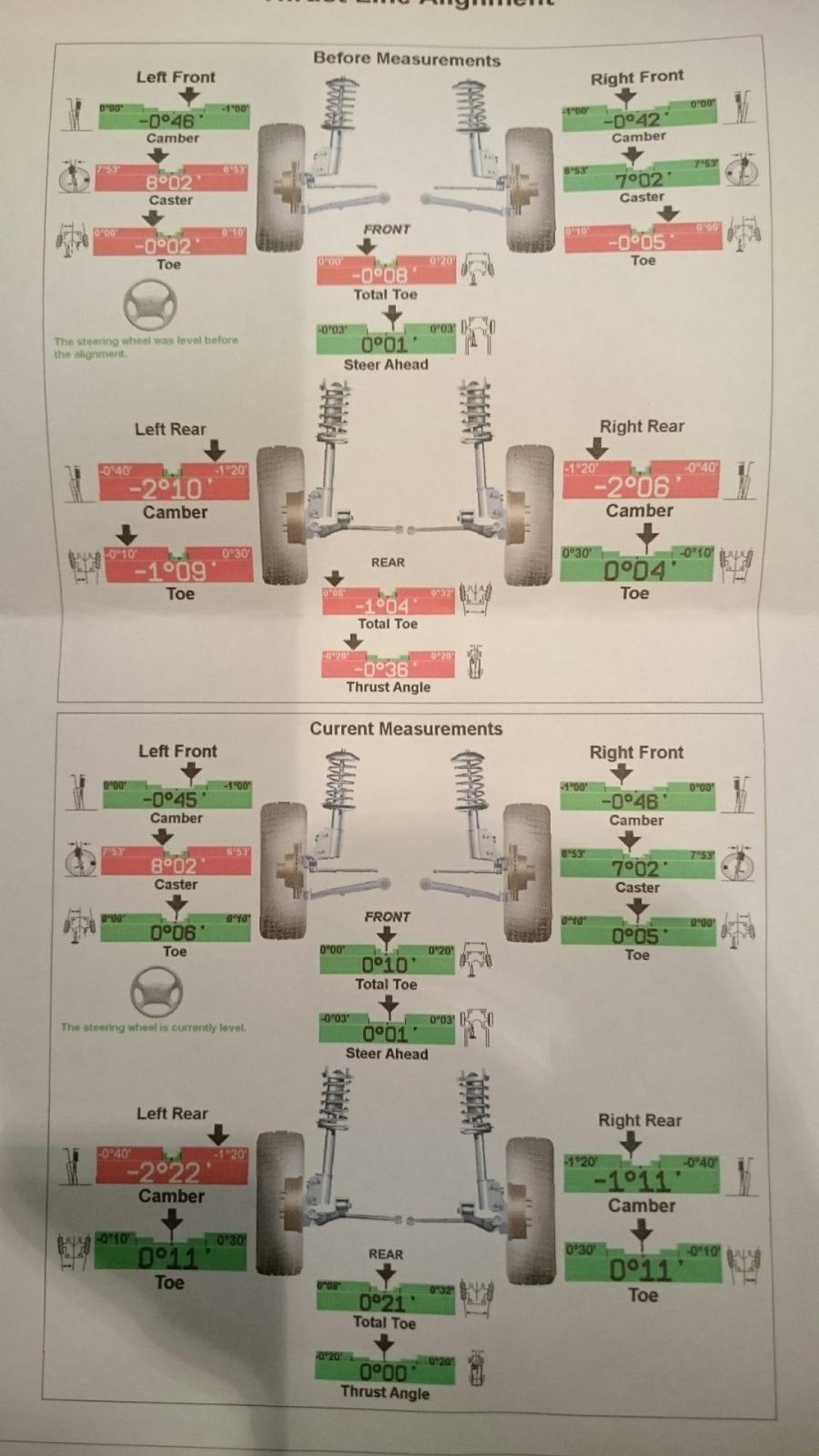

Thanks for your replies.  Do Kwikfit use the hunter system?  After discovering the scrubbed out tyres I took it to them and they did a front and rear alignment (see attached) will this solve the issue do you think?

Thats appauling, yes take it back get it all in the green or your money back.
To be fair to KF they didn't charge me as they couldn't get all the figures in the green.  From what the guy said they couldn't get to the camber adjustment on the N/S.  I live in North Devon, anyone got a clue as to where my nearest hunter equipped dealer would be? or how I find out?
