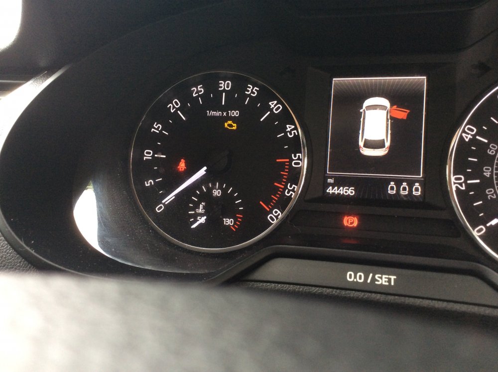

Thanks for the replies -- I'm still puzzled, is there an actual warning light on the dash that comes on as my original quote suggests?
Yep, not in main instrument binnacle though:
octavia-vrs-3-iii-skoda-dpf-warning-disp
Courtesy of @silver1011 from this thread:
I think you get both.
The regular orange warning on the dash, plus the warning in the 'vehicle status' section accessed through the radio.
This light only illuminates if there is a fault though, I forgot to check if it comes on briefly after turning on the ignition.
