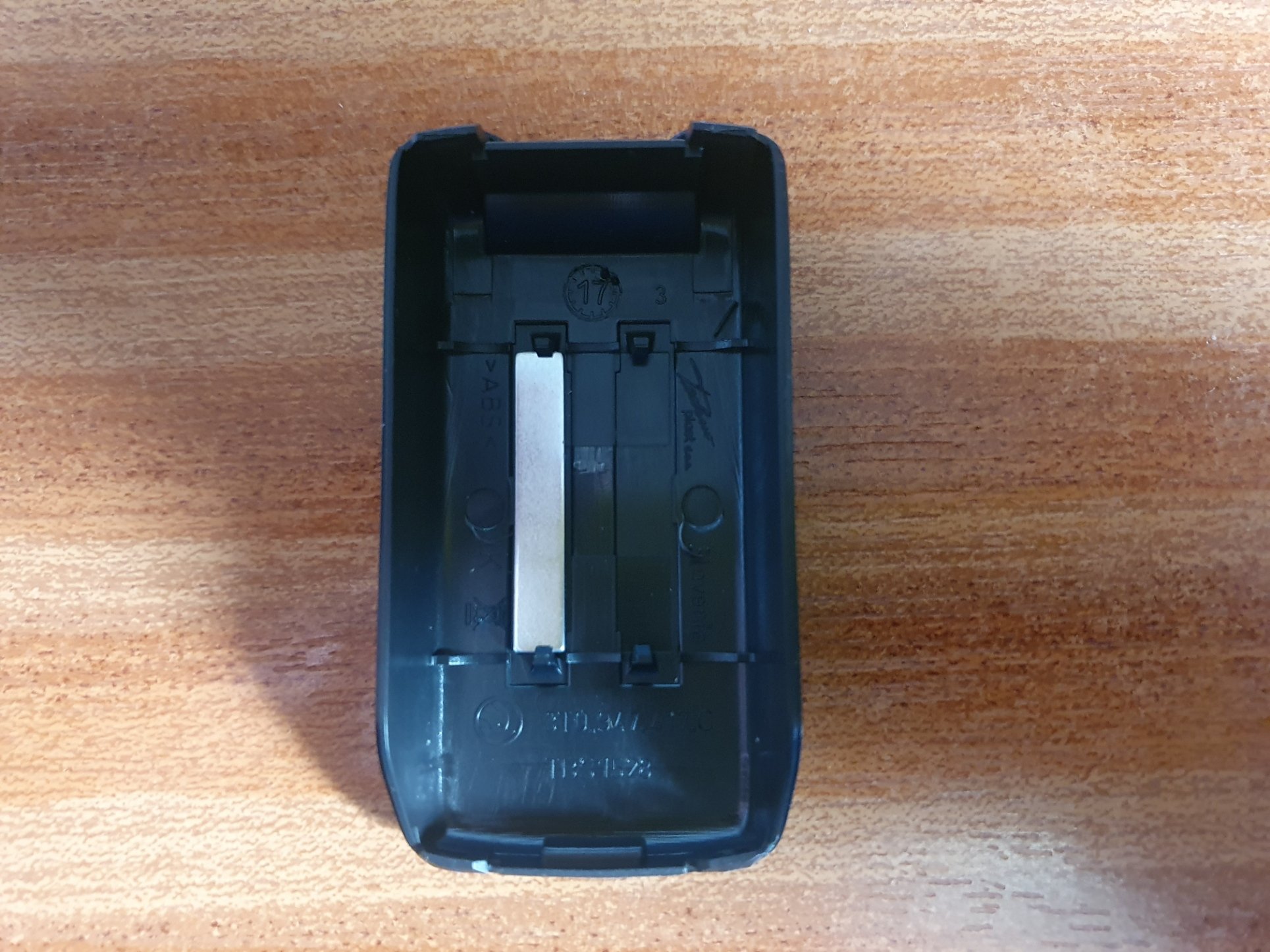

The torch in my boot comes on when in situ but not when removed. Upon opening it up I find in the top part of the casing there is a metal strip left of centre. There is a space alongside it which looks like it should have a strip there also. Probably to connect the batteries in series or parallel or something like that. Should there be two of these strips. Looks like there should be

The metal strip looks like a magnet - certainly acts ;line one - to hold the torch in place in the holder.

Ive opened and repaired about 30 of these, there is only one magnet.
Chances are the batteries are dead and need replacing, id be checking the voltage with a multimeter as if the cells are toast, it wont charge.
