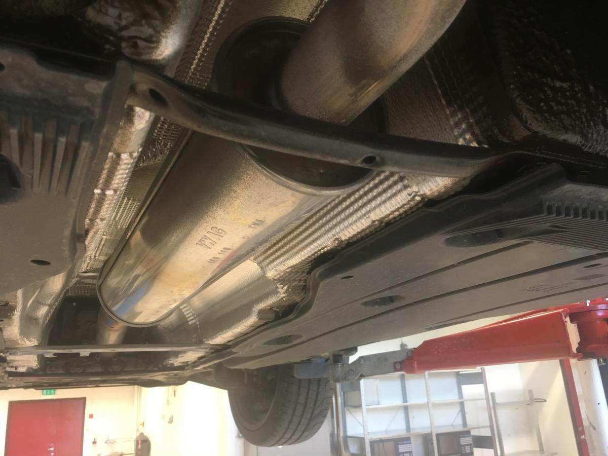

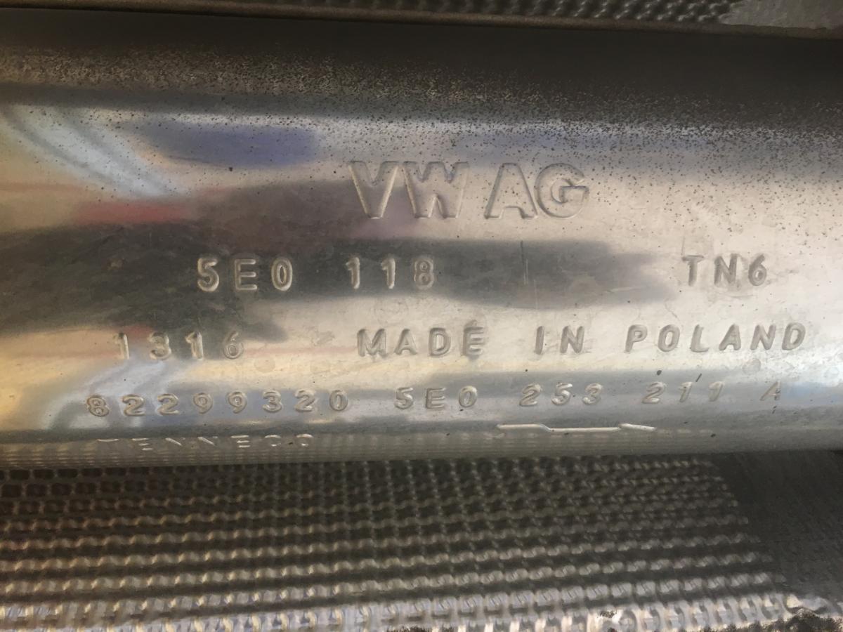

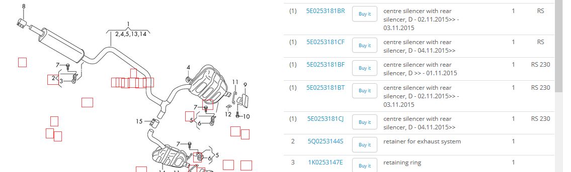

Here are some part numbers for RS230 exhaust middle part.
Did you measure the diameter of the exhaust?

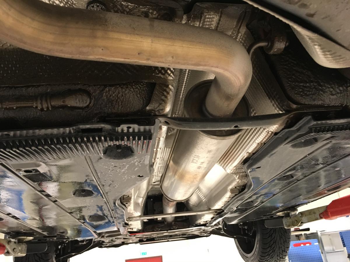

Pipe going into the first silencer/muffler was about 64mm on the outside.
Ok, thanks.
Ok, thanks.
Seemed to be stainless steel.

The centre muffler on 230 is completely different than those of 220. Cylindrical as opposed to Prism shape, slightly smaller too by the looks of it, similar in length though.
Any photos for the two rear mufflers?

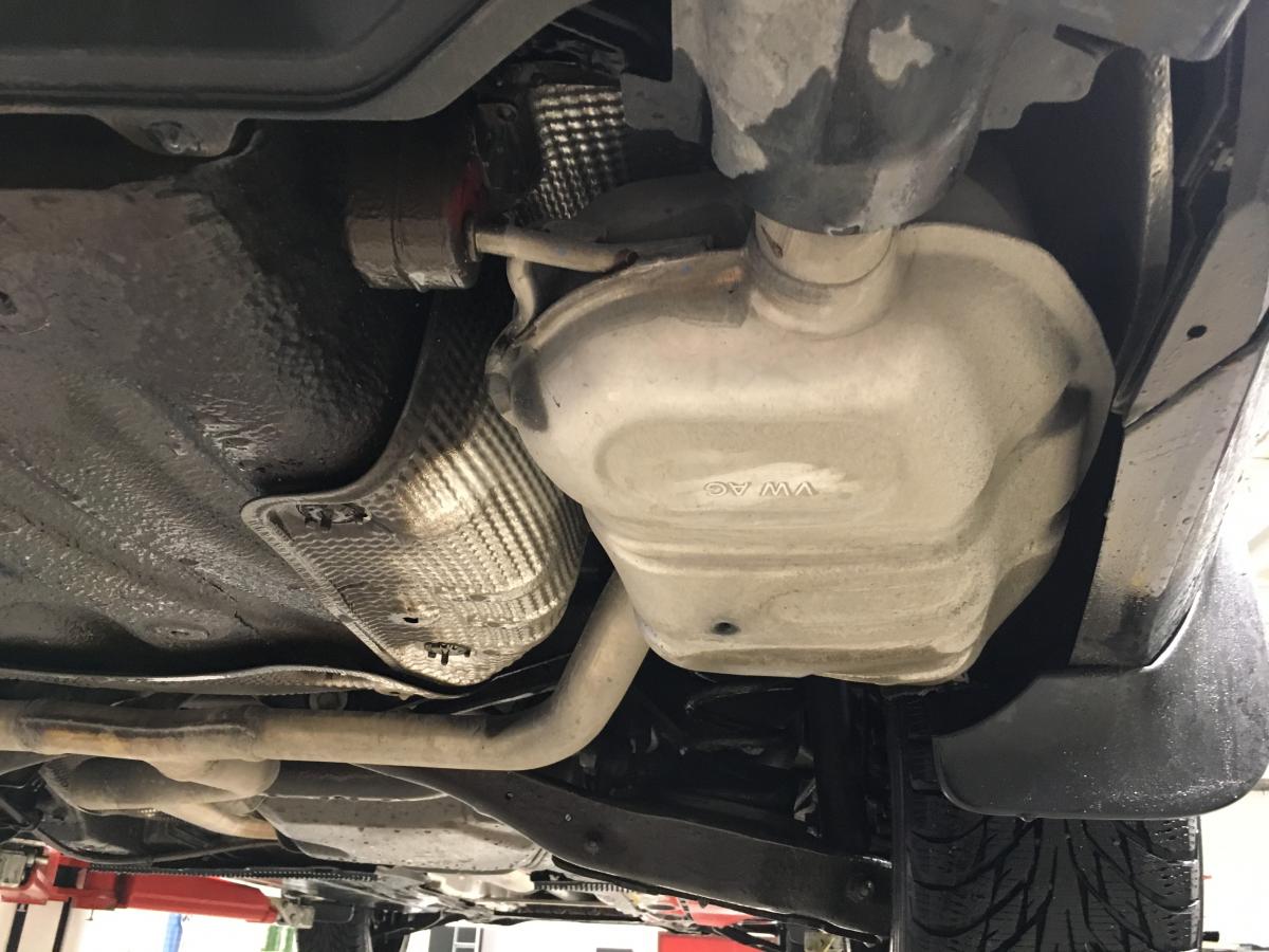

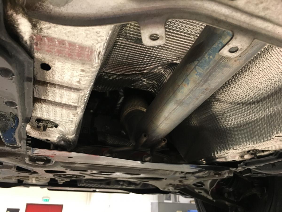

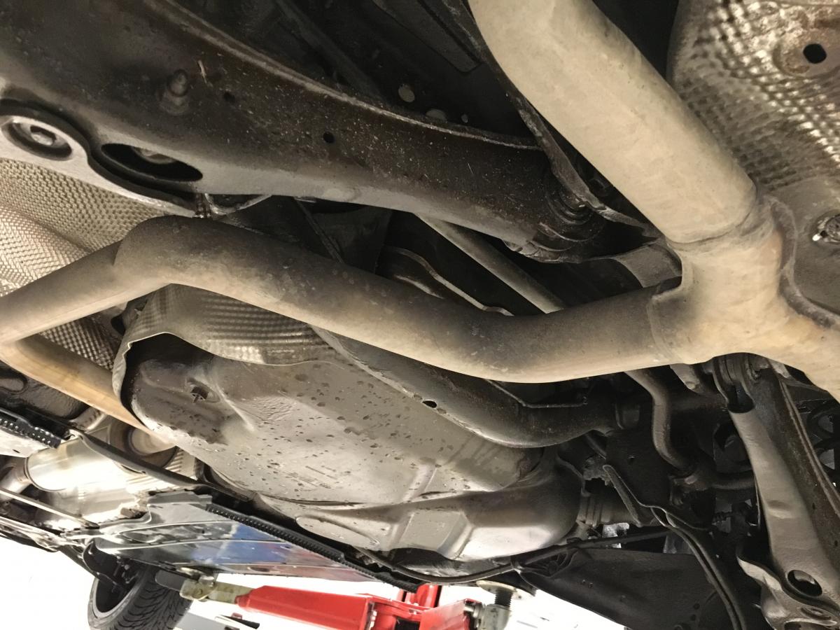

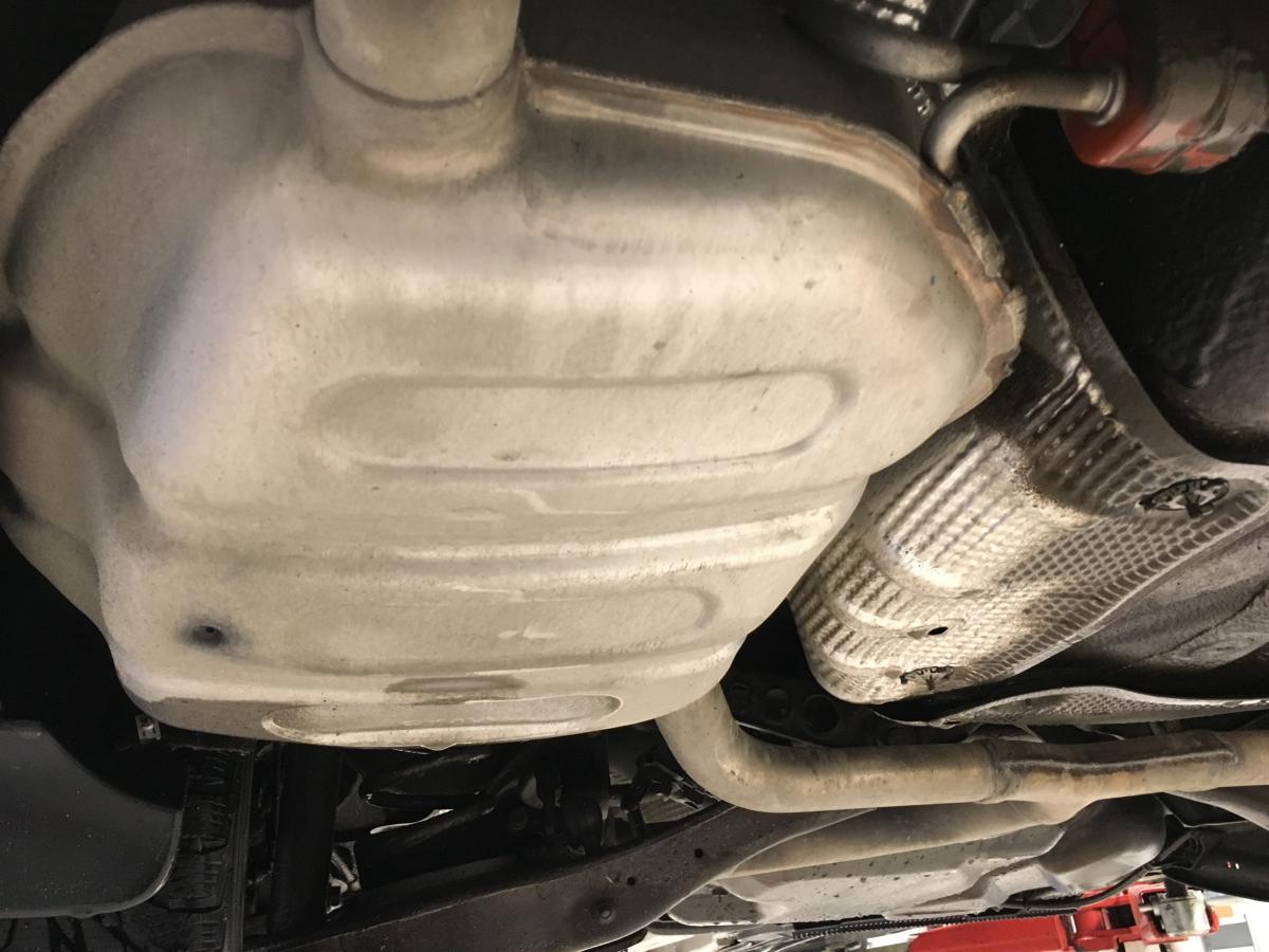

More 230 exhaust pics

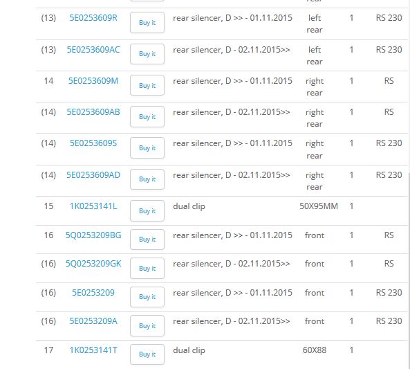

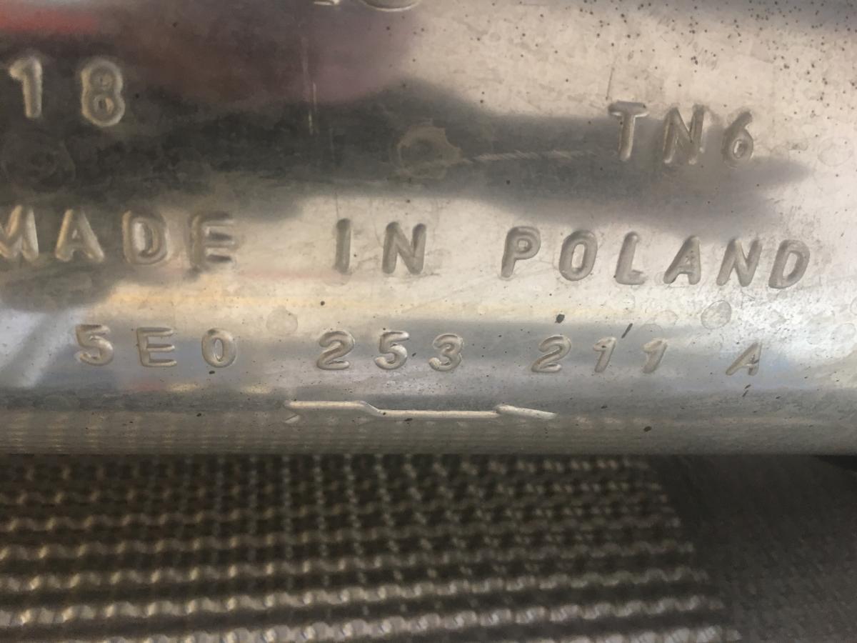

Seem to remember that someone asked for the part no for the 230 exhaust parts. They are in the pictures below.
Yeah I did and found the numbers.
Concensus is its not worth it and very expensive for a very mediocre improvement.
