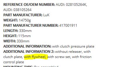

Only seems to be the clutch kit though. No flywheel in the title or picture.
417001911 is a LuK DFC kit - Damped Flywheel Clutch, pre assembled with bolts, clutch and DMF ready to drop on the crank.
