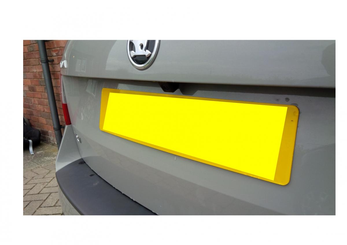

Mines a may '16 and the handle just unclips and is replaced with the handle/camera assembly - no cutting; just push and click. I wouldn't dream of cutting tbh.
As vRSAnt says, there is a cut off point where the older/smaller aperture handle was replaced with the current larger item. Perhaps vaclav can shed some light

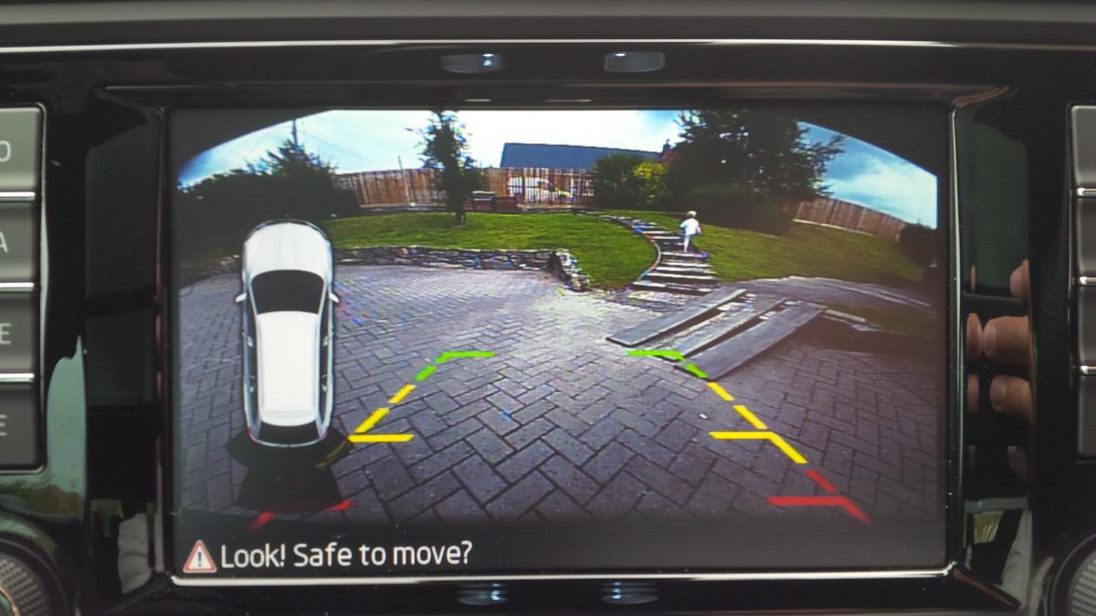

Any chance to post up some photos of the camera picture? :)
Sorry for the delay:
Camera wasn't altogether clean, and pics taken on phone, so quality could be better - I have no issues with it :)
Nice result skodaphile, thanks for the pics.
However, the camera seems a bit misaligned to me (chinese QC?)...
Some kind of evidence is the two black area at the upper corners.
I don't see such problem if I check the feedbacks on Ali.
I would check if it's possible to correct the camera position somehow.
The external rubber covering should come off easily, and if the camera is fixed by screw(s) and not glued you can probably adjust it with some fiddling.
Still a good result for a cheepo camera, the viewing angle is great, like with the original one. :)
Night vision is ok?
Night vision is ok?
Thanks for the suggestion, I'll take a look when it's not :rain: ing    :dull:
I was happy enough to accept the slight black areas, but if I can sort it then great! Night vision is very good (I do have some excellent cree LED reverse lights and I live out in the sticks so it gets VERY dark at times :D) - there is actually adjustment on the screen for brightness/saturation/contrast which is useful.
