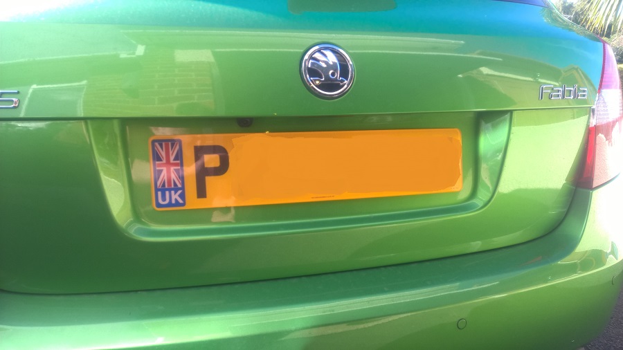

This is the camera I fitted to the number plate of my wife's Fabia.  Was £22 and is great, no problems at night at all (though she a very bright cree reversing bulb).  Only reason I would go for the handle one on my octava is so it is more in the middle which satisfies my OCD better!
Only thing that is annoying is when you get the camera in the light, the led light is tiny and gives off enough, but a very small amount of light.  If you then put an led bulb in the other side, to make them match you have to get the smallest, least powerful one you can and then tape up most of the lens with black insulation tape so the whole is the same size. Otherwise you get a floodlight on one side and almost nothing on the other.
