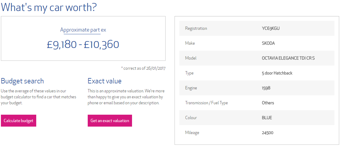

You must be paying too much when buying and selling too soon.
Dealers want profits from selling, and then taking in and selling again.
You can not blame the VW Group for how you buy and sell now can you?
I always check the price on trade in values for the actual car I'm buying so I can negotiate on price to ensure I get a better deal. Hence why I said on part ex/ We Buy Any Car prices as knew what the car I wanted to buy was worth to the dealer and then what it was worth when I part ex so I could the maximum for it. Nothing to do with what I paid for it and then part ex'd at!
I'll give you an example if you're having difficulty understanding this simply concept.
Octavia 1.6 tdi Elegance sale price £11,799
trade in price on the same car £9,180 -£10,360 in other words the dealer has at least £1,439 in profits on the car
