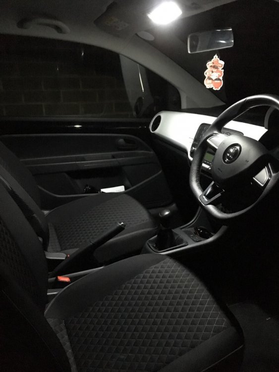

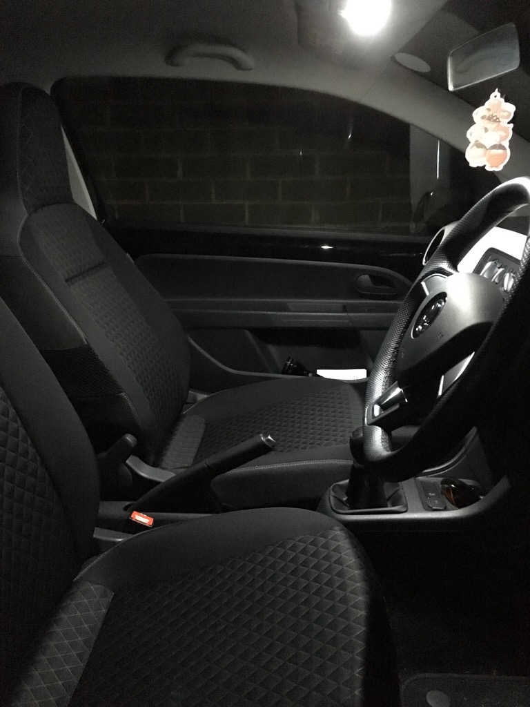

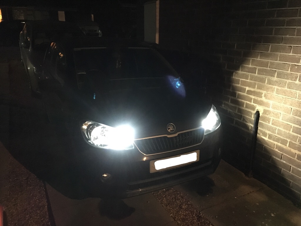

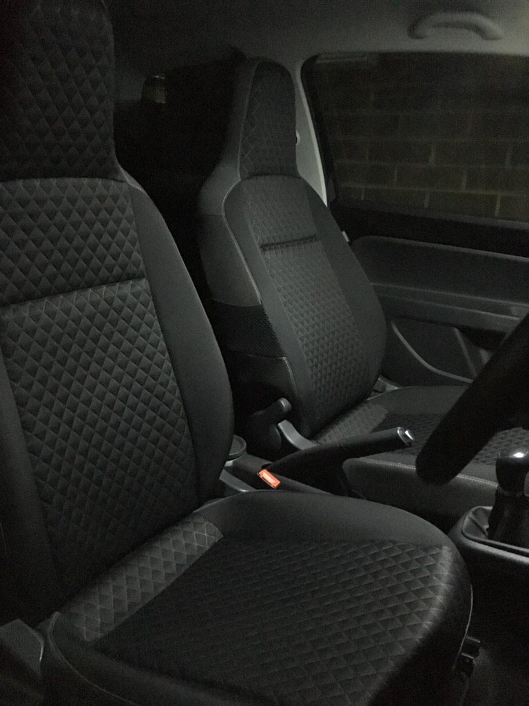

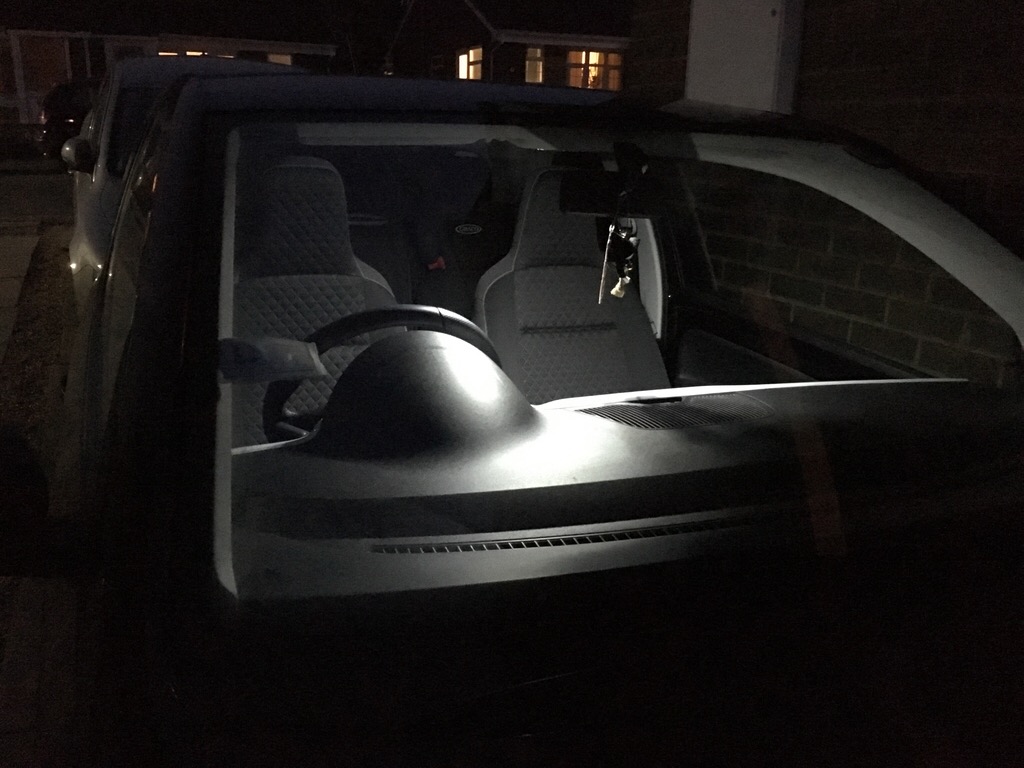

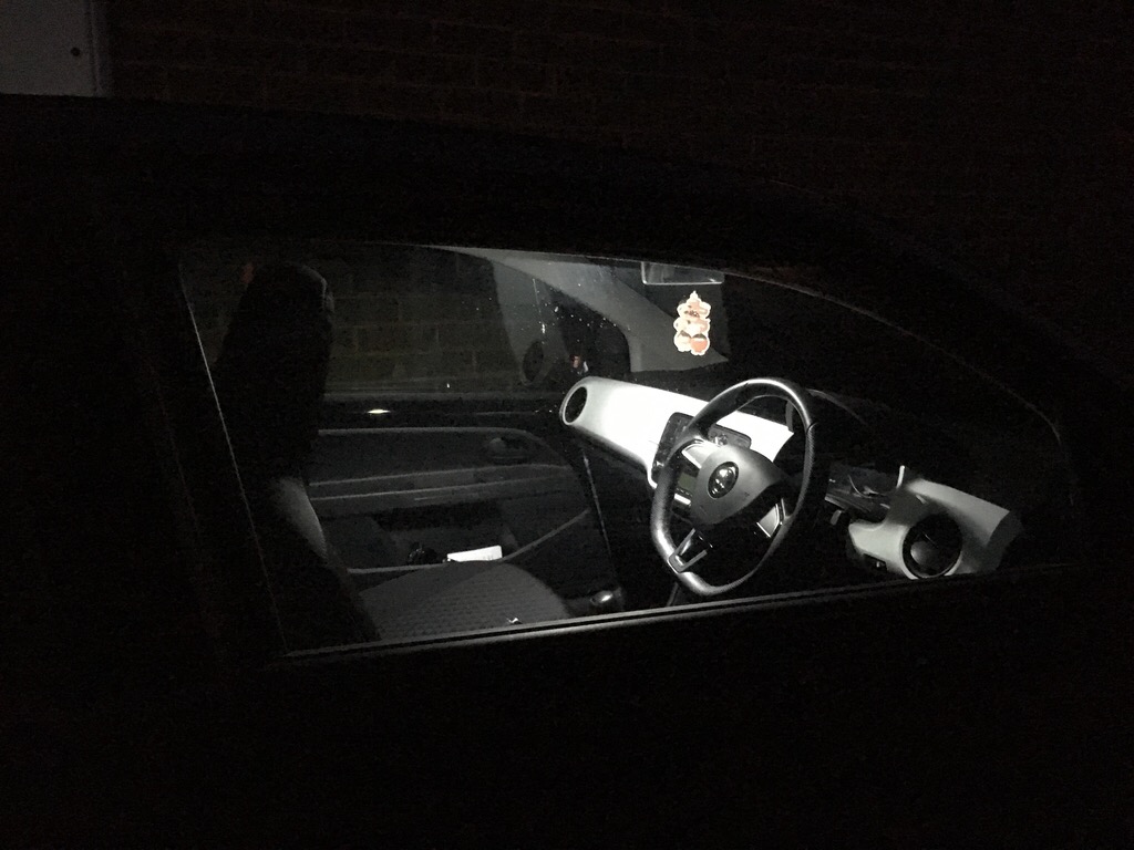

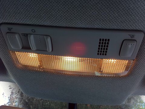

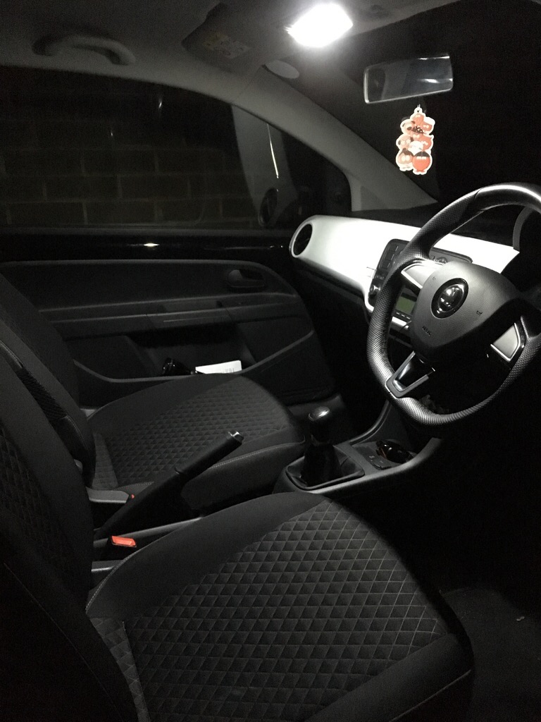

I went out and took some pictures of the upgraded interior light in action this evening. The unit i got is fitted in numerous VAG cars with the one i got having come from an Ibiza FR that had only done around 20k miles and it's like new. I got it from an online breakers via ebay and i seem to remember it cost around £20 or slightly less and that was including delivery.
This is a stock image i found of the light unit along with some pictures of the vastly improved light output from the New unit with its replacement LED bulbs fitted.
There's also a pic of the new LED DRLs....They are the ones from HIDS Direct that quite a few people have had over the past couple of years or so...

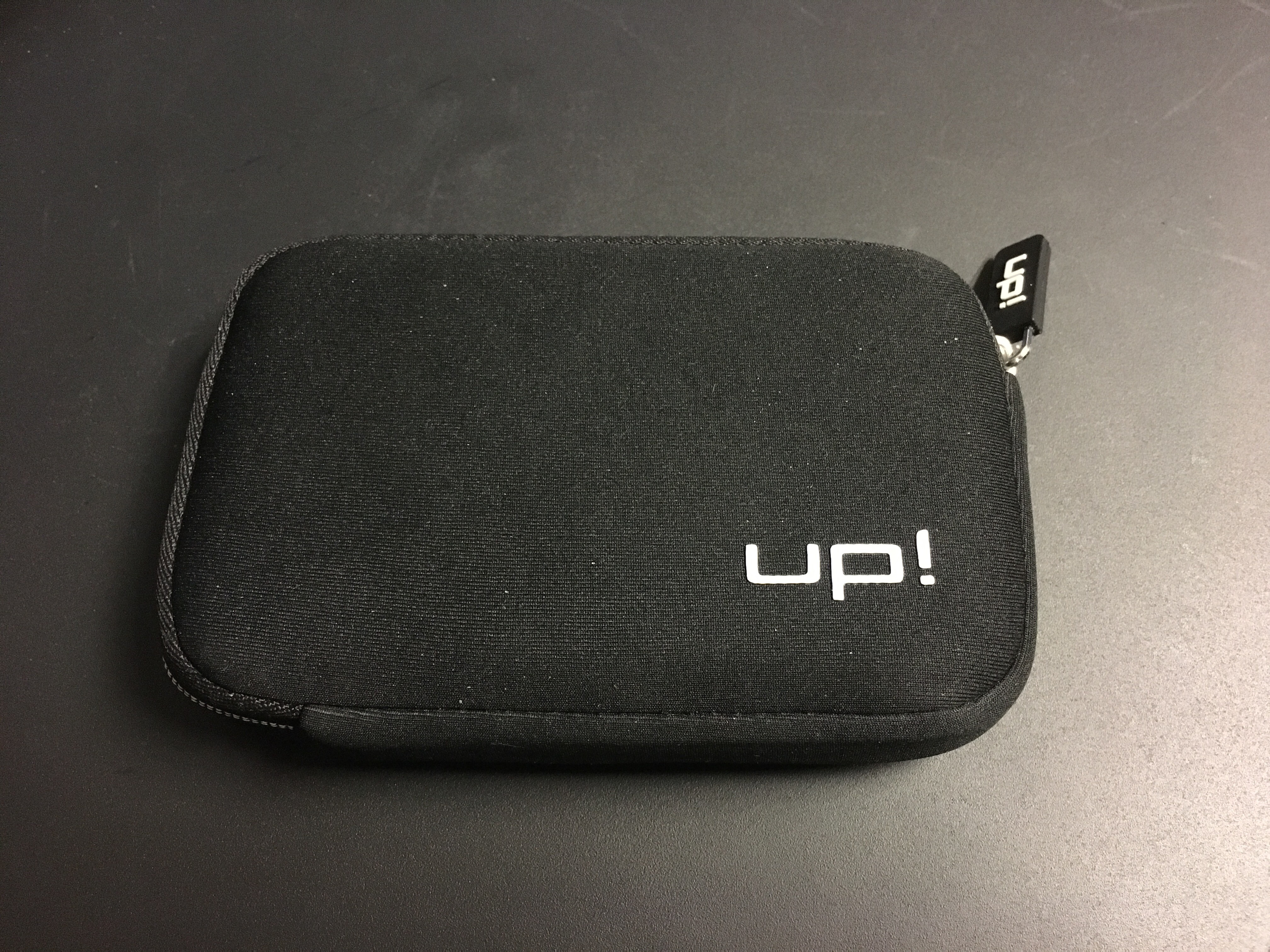

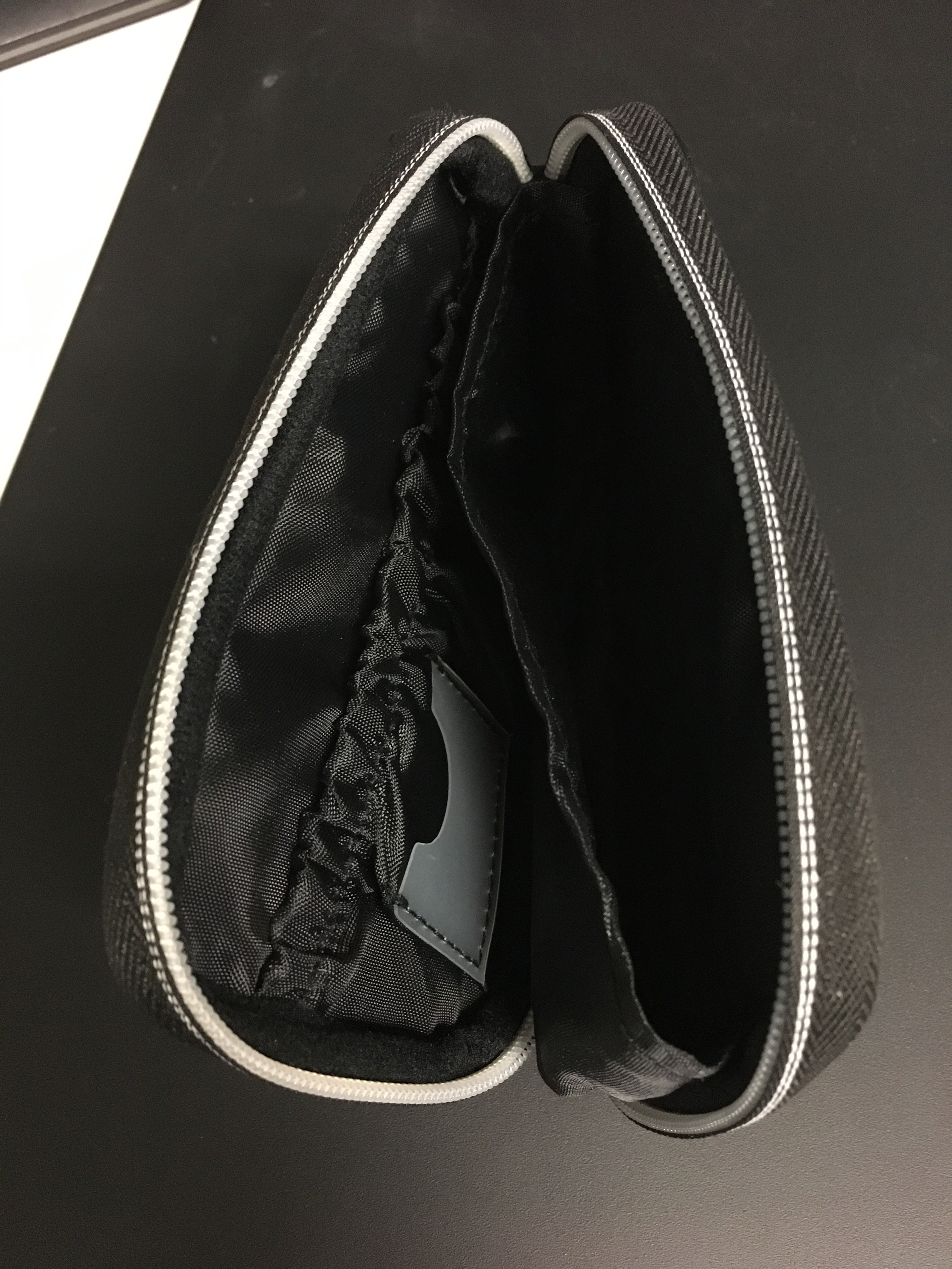

A little something for the PID this time..... Seeing as it looks as though Skoda have decided not to continue with their own Skoda branded case for the PID i got an official VW case for it instead.
The Mrs and myself can put up with the Up! branding on the side and zip and it's obviously a perfect fit as it's designed for the unit.

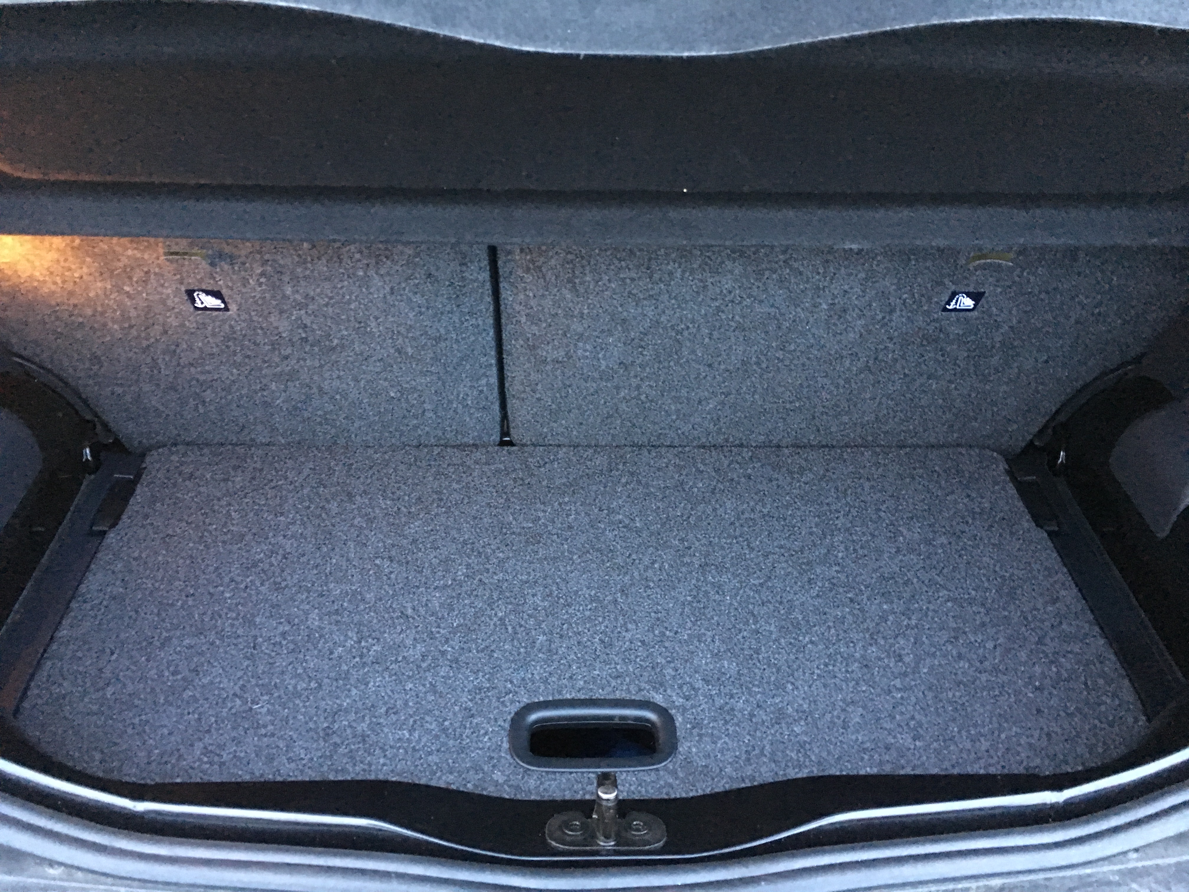

Went to collect the variable boot today and fitted it when I got home. I didn't bother cutting the boot liner to size with it not being visible in normal use and it only raising by an inch or so at each end against the New sides. It also means the boot liner can still be sold on when the car goes.
I also took the boot light out while I was in there to replace the bulb with an LED replacement but the replacement bulbs seem to be just too long to fit in the holder so I've had to revert back to the dimmer stock bulb for now. Anyway the Mrs is really happy with the new boot floor so that's me in the good books.

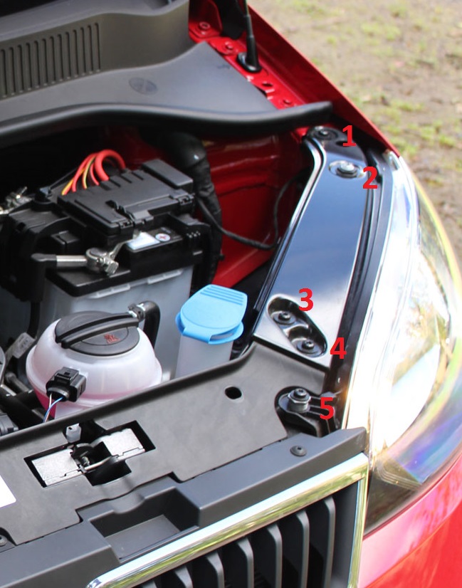

Well tried to replace the front indicator bulbs on Saturday with some Philips SilverVision bulbs I had taken out of the vRS before it went......
How the heck are you guys managing to replace these front indicator bulbs?!?!?!  I managed to get the passenger side one out ok (Although it was very stiff) but really struggled to tighten it back up again. And the driver's side one I couldn't even get the original to untwist!!! So I had to undo the passenger one again and refit the OEM bulb and again struggled to tighten it back up again. (I still don't think it's as tightly fitted as it was originally though).
The only way I can see to easily replace them is to take the whole headlight unit out and back in again...... Which I can't be bothered to do so looks like they are going to be staying OEM. :emoticon-0101-sadsmile:

I unbolted the the 4 torx fittings that hold the black headlight mount strips in place and moved the light unit out slightly to get my hand in when I changed the bulbs :) It's easier than it sounds I promise!
I'll have a look at that and give it a try. :)
@SashaGrace Just had a quick look and wanted to confirm which four bolts you undid to move the headlight assembly forward slightly..... I ask as every pic I can find has 5 bolts so want to check which four you undid.
I undid 1-4 as you have numbered them to remove the black metal strip, even just getting that out of the way gave me enough room to get the bulbs back in. Number 2 bolt has what looks like a plastic nut underneath, just prize it off and keep it to one side. Gives enough room to get your hand round and fit the bulbs :)
Cheers mi dears. I'll give it a go when I'm next off and the car is at home. :)
