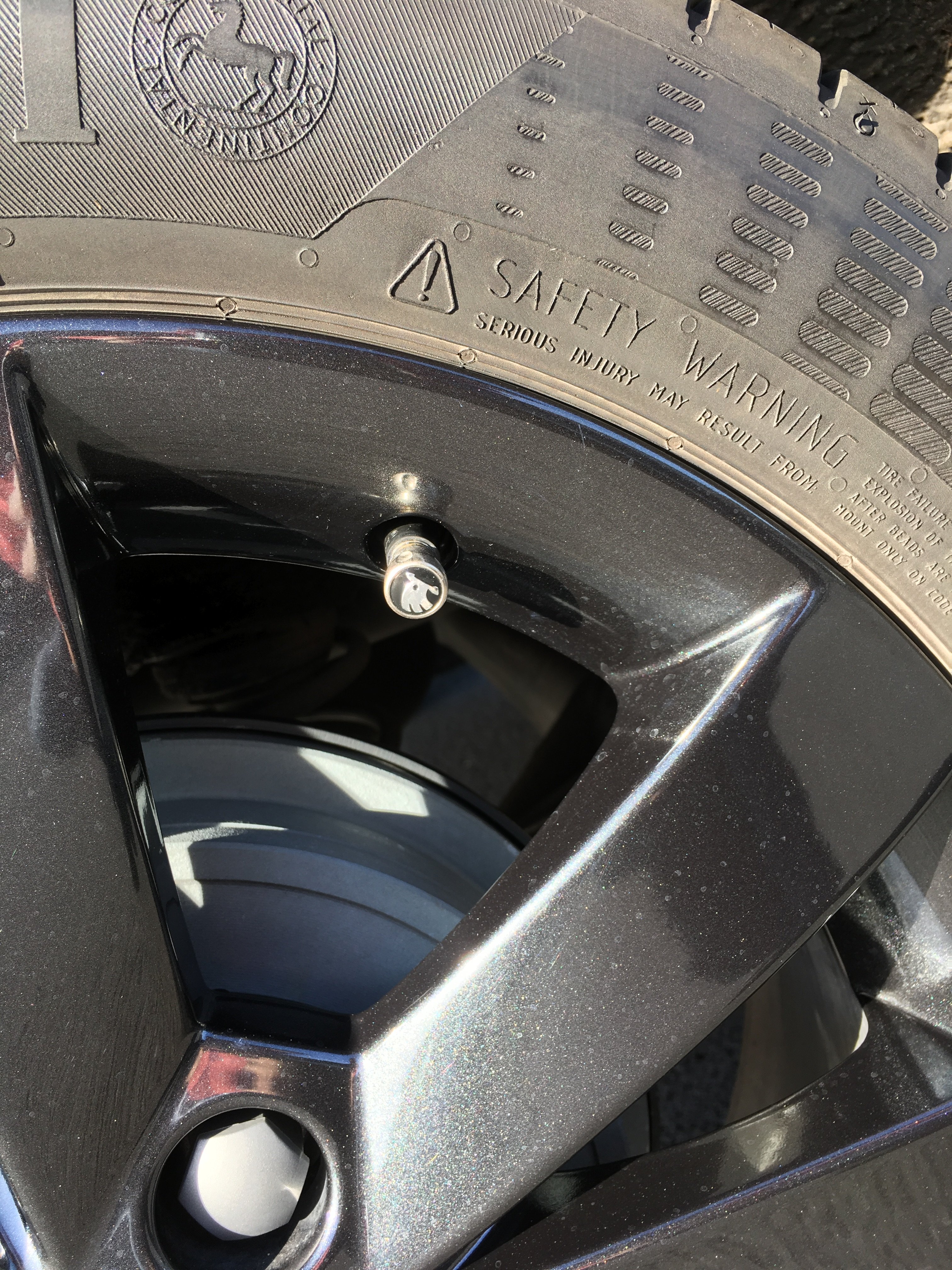

Got the valve caps this week and fitted them today. Sprayed a little white lithium grease into them before fitting them to hopefully stop them becoming rusted in place.

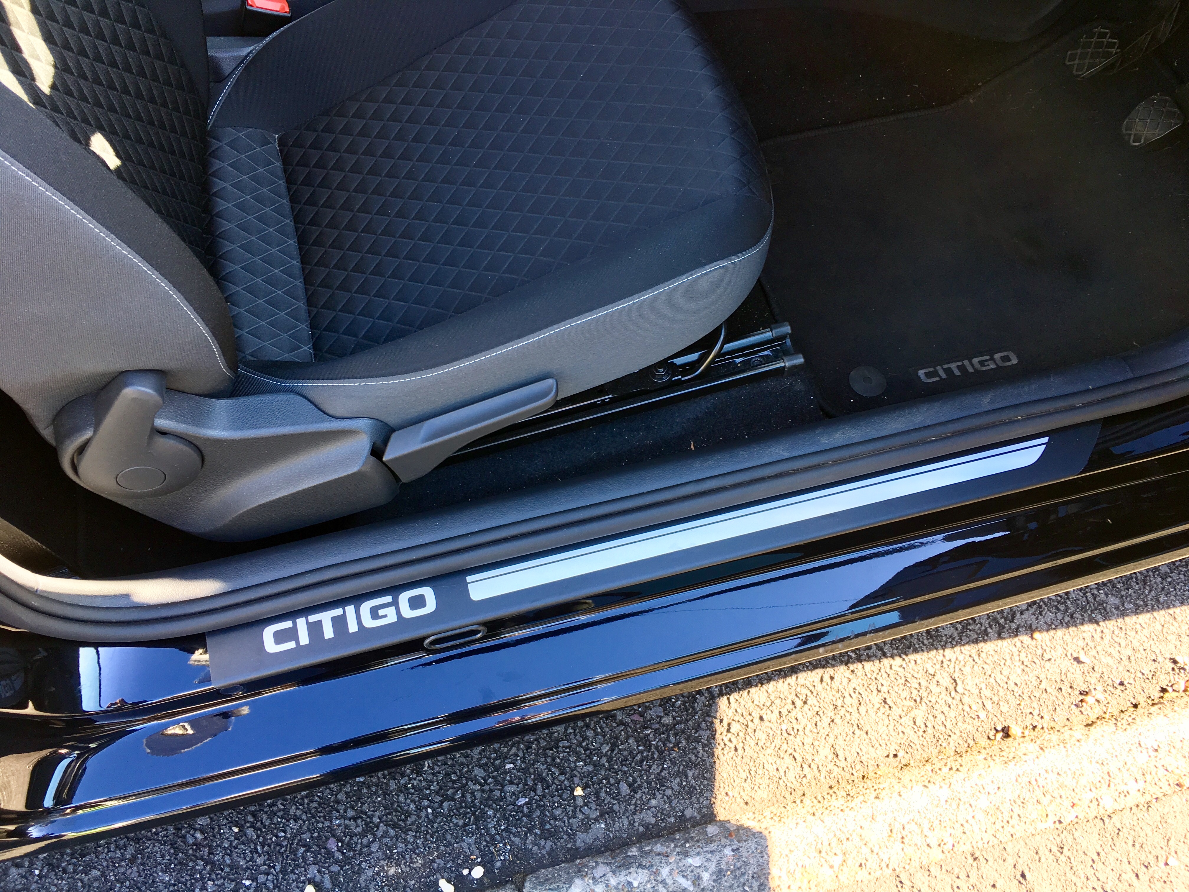

Still not got the sill protectors fitted but hoping to get them done over the next few weeks.

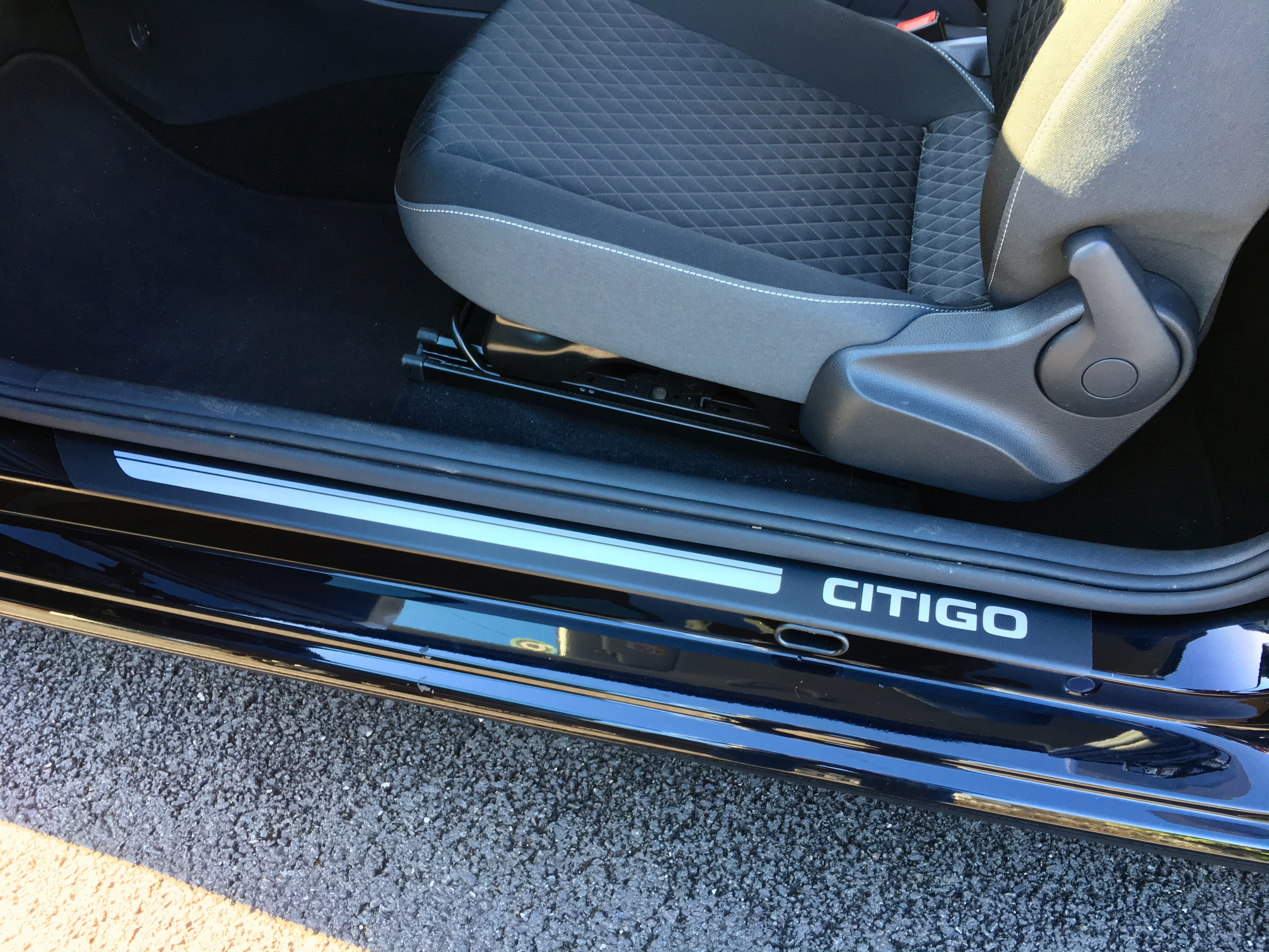

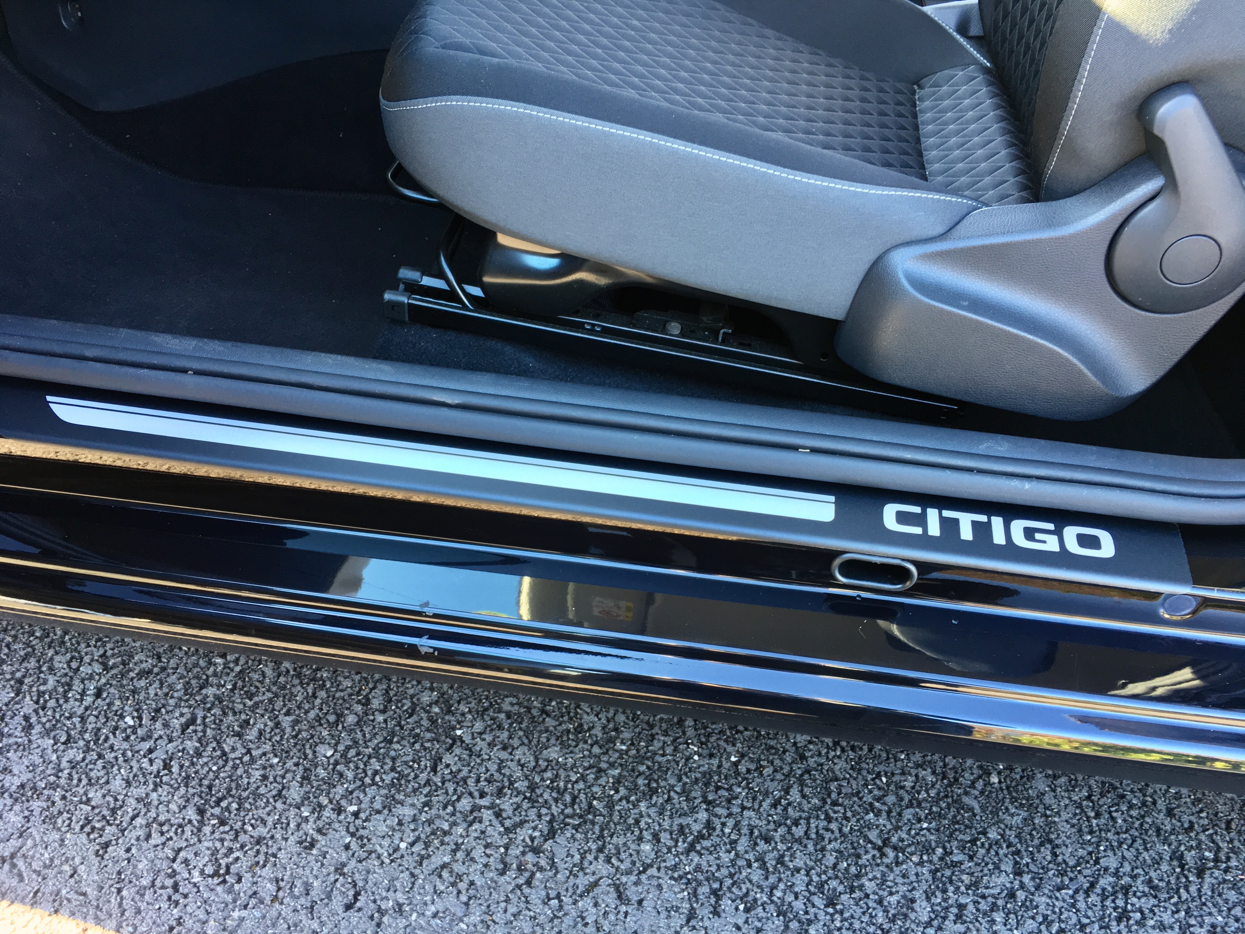

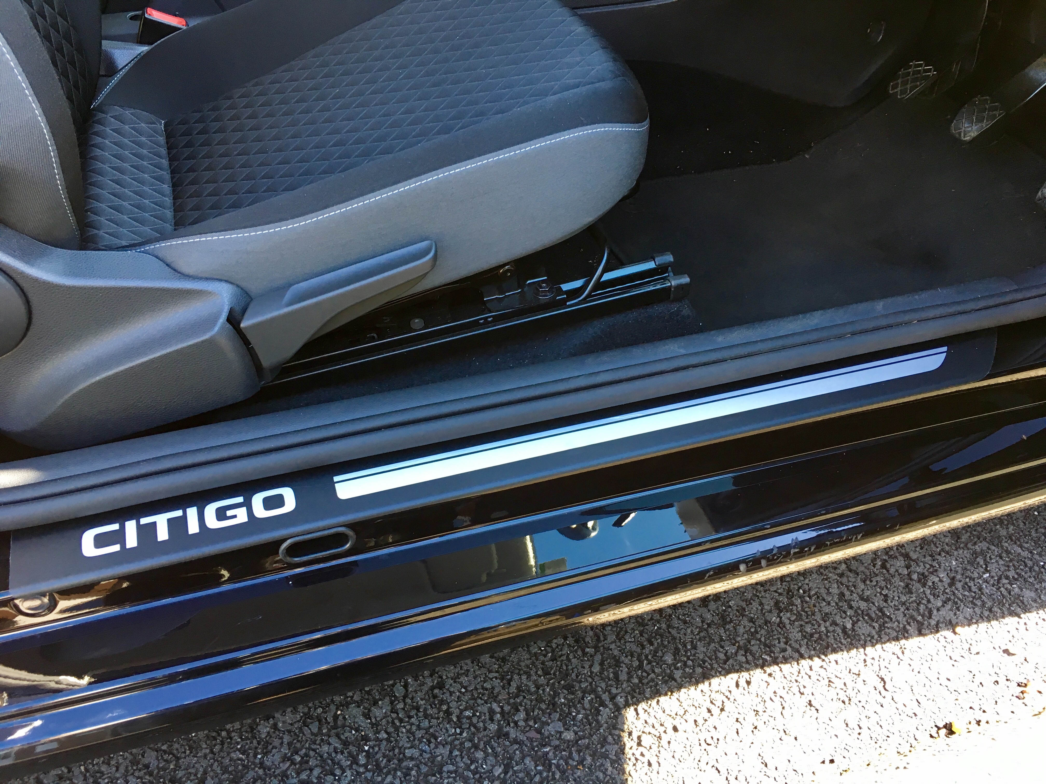

Finally got round to fitting these today after giving the car a wash ready for the Yorkshire meet tomorrow.
Driver's side one was a pain.... Managed to pop the rubber gromit that you have to remove first into the bloody body work of the car!!! But luckily managed to get it out with the use of a telescopic magnet with a piece of 'no more nails' double sided tape on the end and a set of long nose pliers. Anyway that protector was a pain to fit properly but the passenger side one went on like a dream.

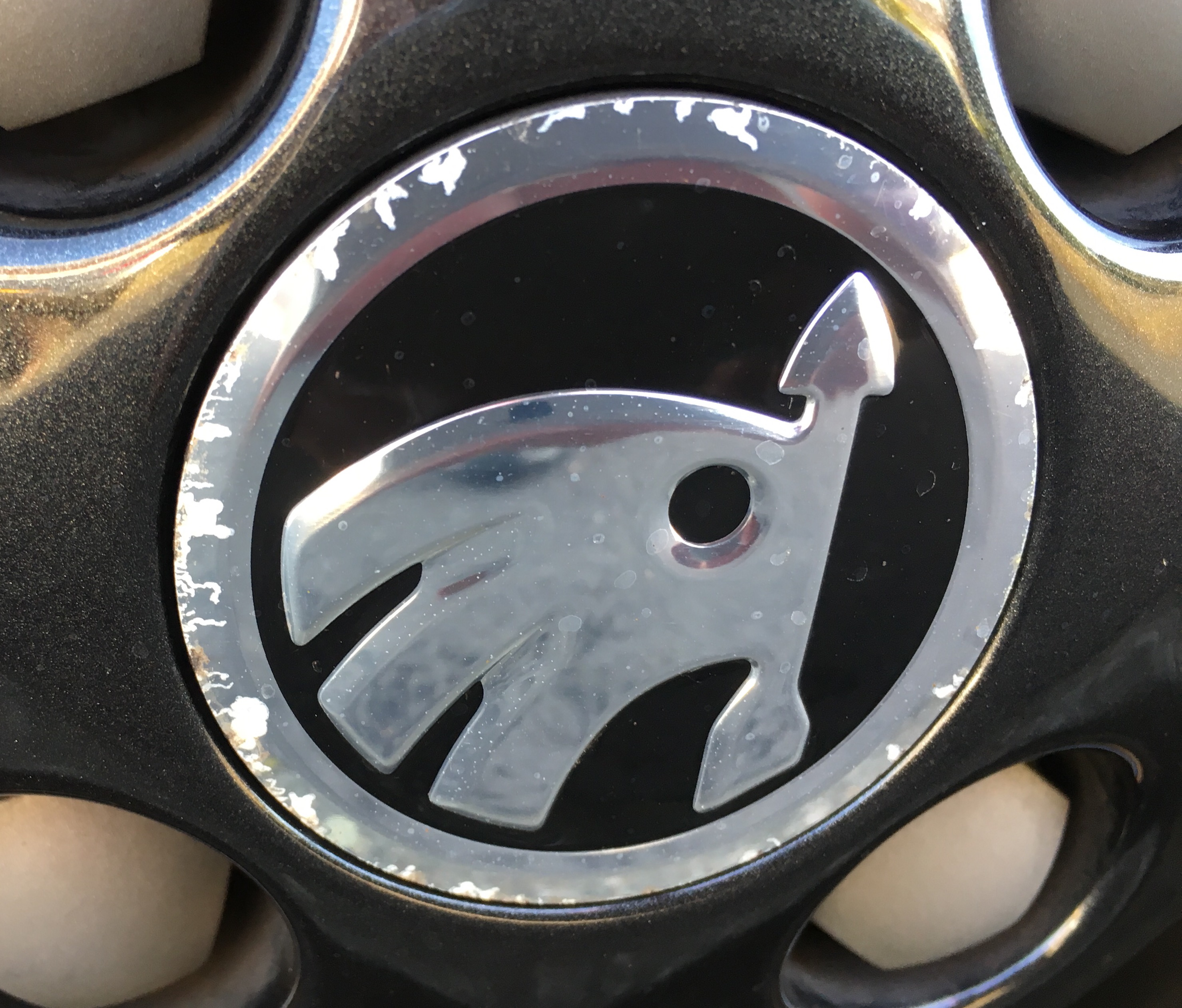

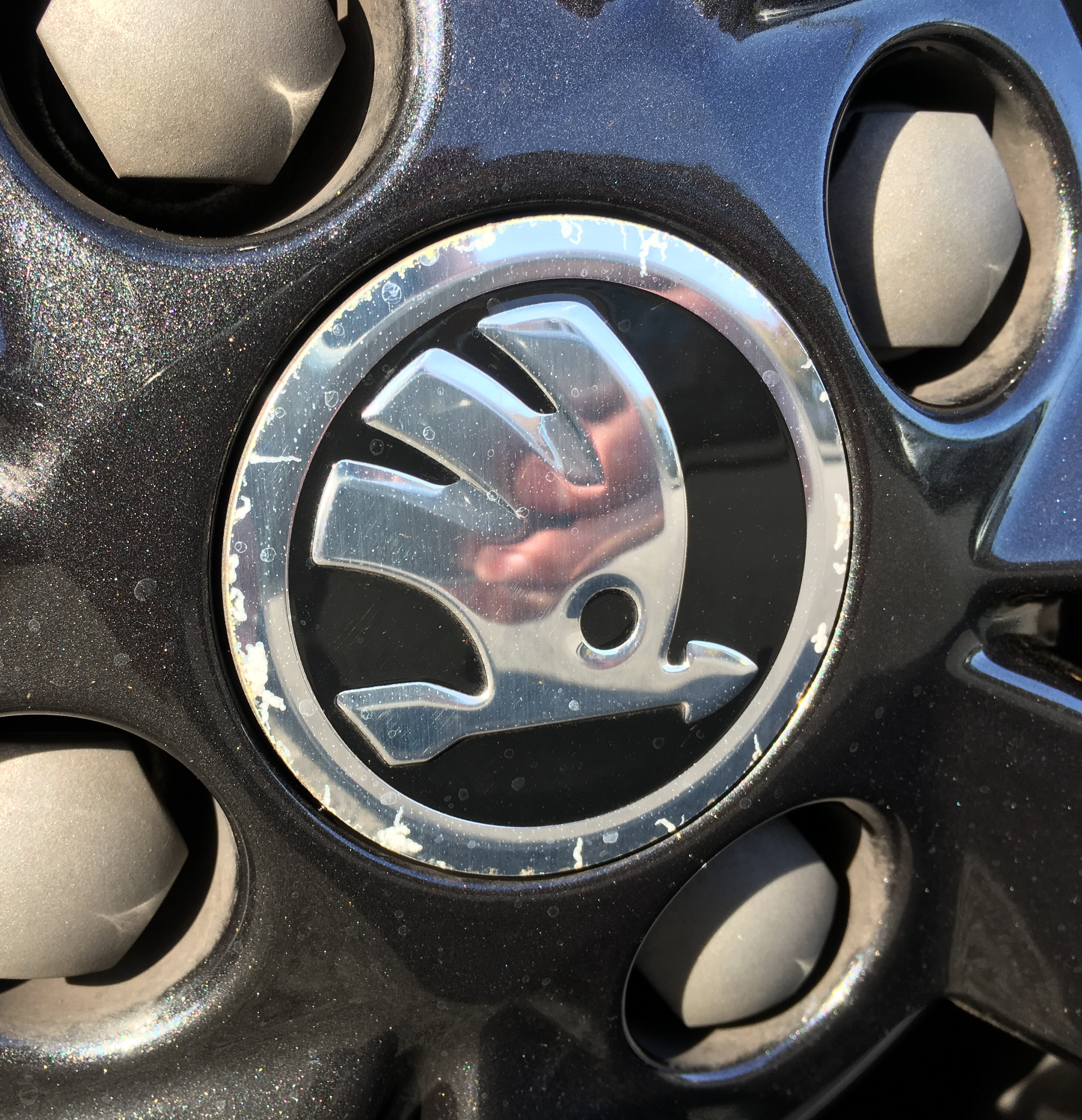

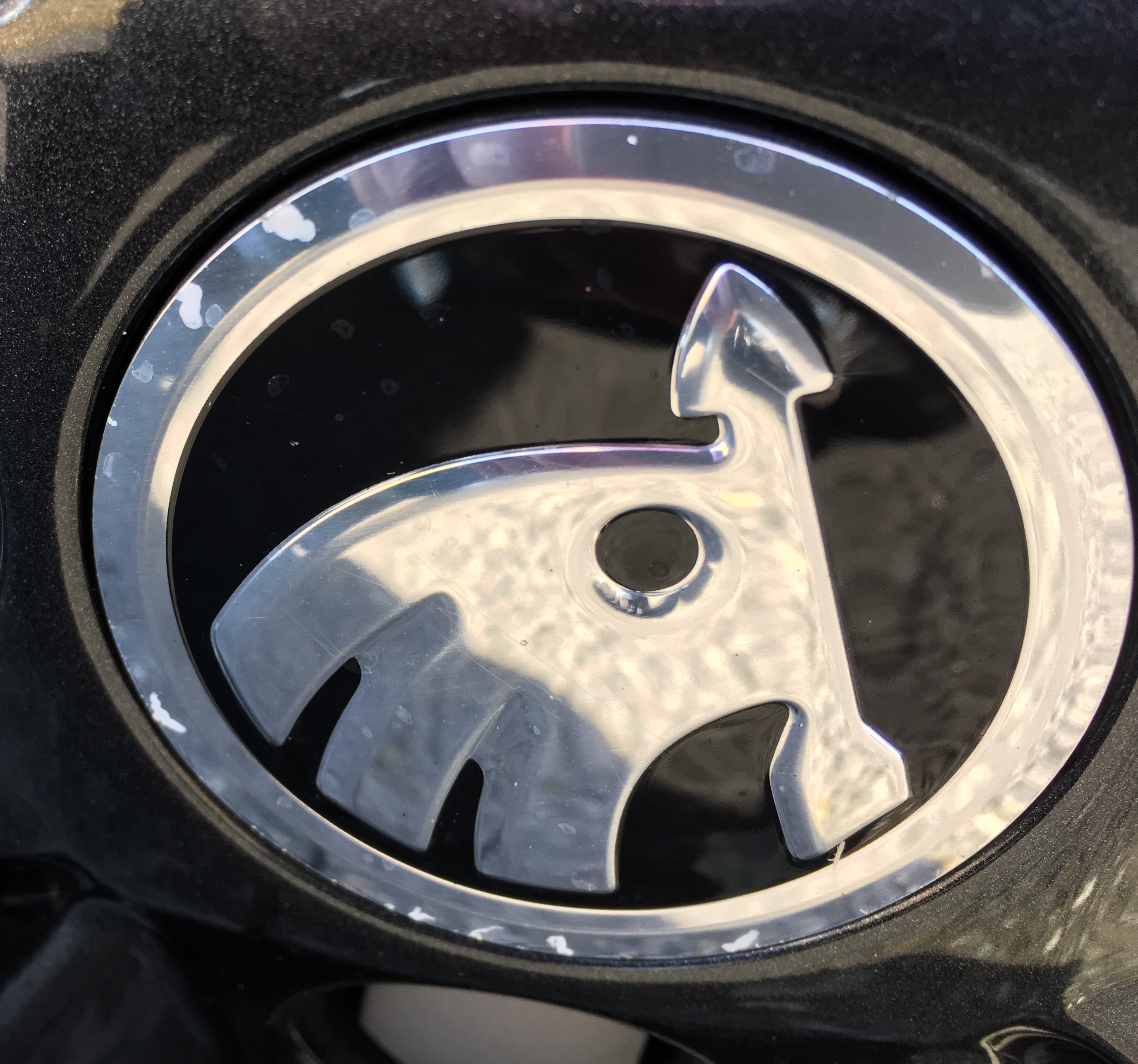

The car had it's first service today along with having a couple of Warranty issues looked into.
The radio reception has never been the best. I know it's a known issue with the radio not being the greatest but I've had a couple of VW Up! cars as courtesy cars in the past that both seem to have had better reception.  Also all four centre caps were showing signs of corrosion and marking after only six months so this was also mentioned when it was booked in last week. The dealer did ask what I used on the wheels to which I replied "the AutoGlym stuff Skoda sold us with the car" at which point they said they'd swap them out. :)
Anyway upon collection all four centre caps have been replaced and they have also looked at the radio and have said they have reterminated an earthing point, (which they say is a common issue?????), and to see if this improves the radio at all. If not they say they will investigate further.

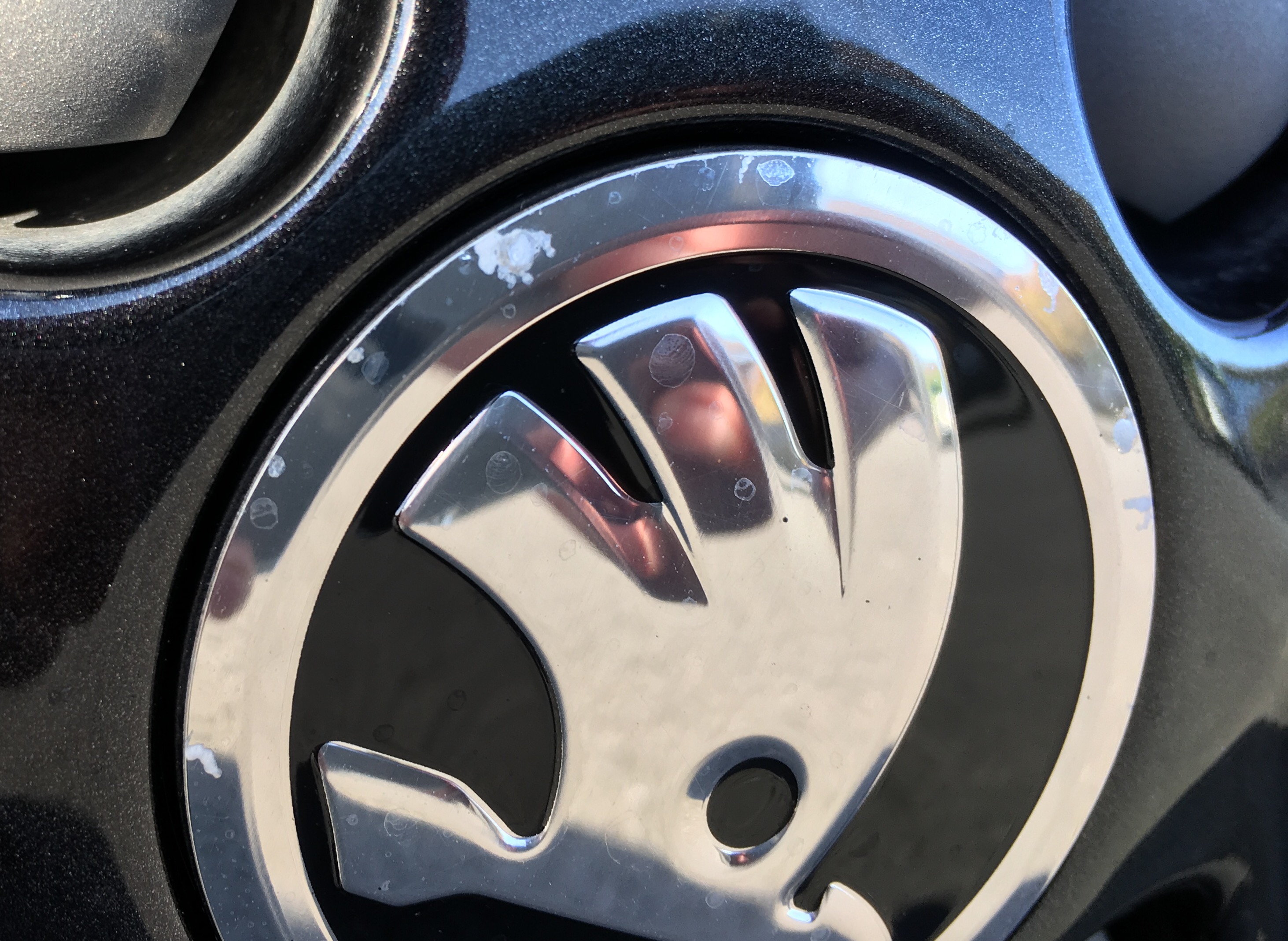

Here are some pics of the original centre caps which had been like this since around February/March time I think.
Our Citigo is nearly 3 years old, albeit with less than 6,000 miles on the clock. White-worm is only just starting to show on a couple of the centre caps. I use a very caustic wheel cleaner (AutoSmart Smart Wheels) but heavily diluted and rinsed thoroughly after use.
The powder coat/paint has cracked/split on the back-facing edge of some of the wheel spokes though. Corrosion/bubbling will no doubt ensue but hopefully I can soldier on another couple of years before considering a refurb.
For future out-of-warranty purposes, genuine Skoda centre caps are available on ebay from sellers in Slovakia for around £15 for a set of four.
Edited by ronime
Well after using the car a few times since last Tuesday the radio reception does indeed seem to have improved to what it should be like. (Not brilliant but as well as these units perform). So it looks like it was the dodgy earth termination that was causing the issue.
With regard to the centre caps..... I do wonder if they are made in numerous factories and it is only the ones made at certain locations that are of a poorer quality??? I say this because it seems so very random and not on the majority of vehicles that people have this issue and that when it does happen it seems to be all the centre caps on a car that are affected rather than just the odd one.
The ones on our Citigo were like this when the car had only been on the road 6 months (albeit it was 10 months from its build date), yet the ones I fitted to my Superb when upgrading from the older green badges to the new black and silver badges are still in great condition and they have been on the car around 2.5 to 3 years and are cleaned with the same products as the ones on the Citigo.

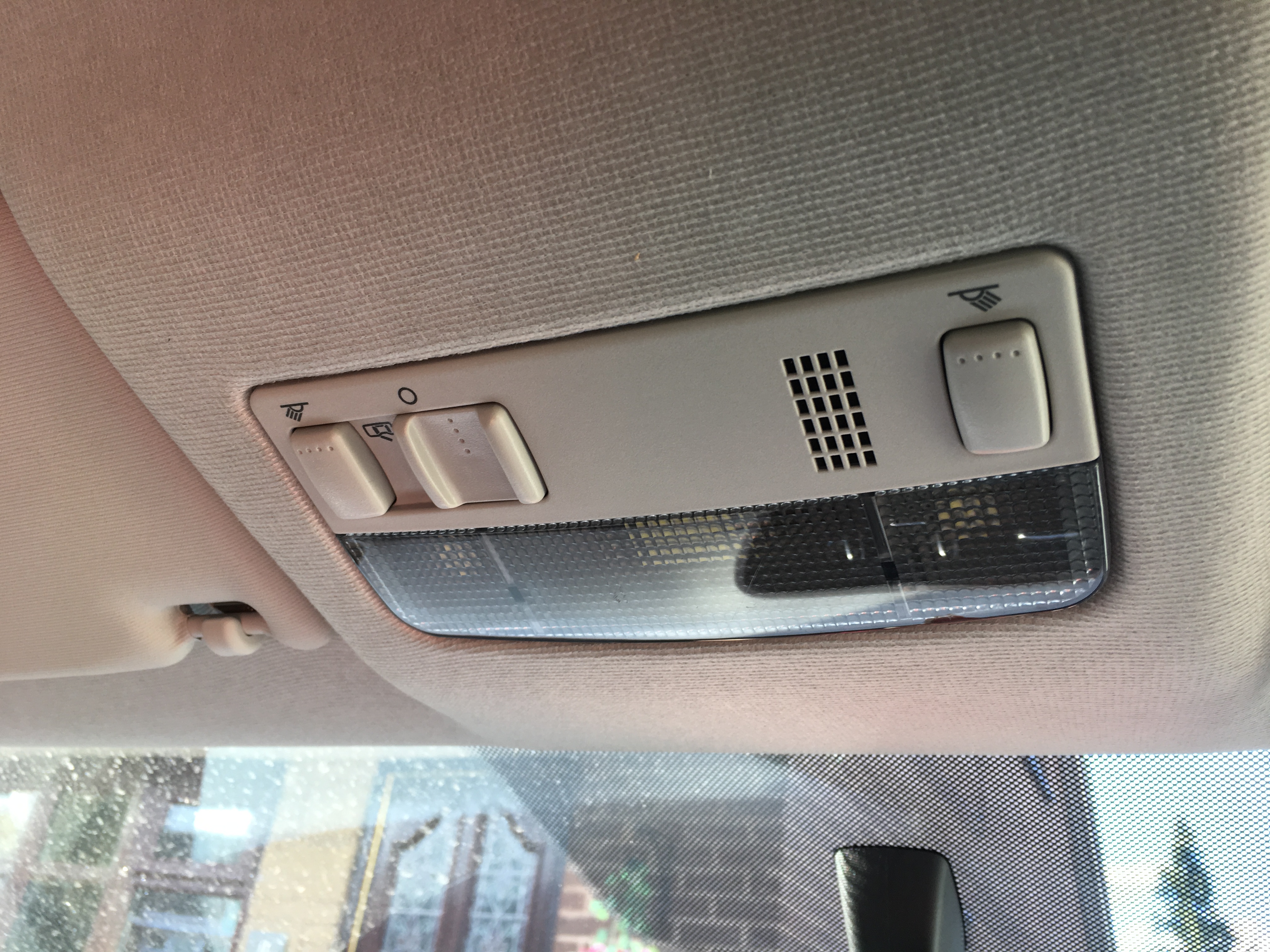

On 04/11/2016 at 21:32, WaveyDavey said:
Replaced the interior light yesterday with one of the three bulb type with map lights. It came out of an Ibiza that had only done 20k miles and was in like new condition. Cost £20 delivered.
Replaced the three bulbs with LEDs and you can now see what you're doing when the light is on. :)
Nice quick 5 minute job from start to finish.
One would presume it's a few screws and clips under the perspex panel?? Looking at doing this myself in the coming weeks.
I can't quite remember exactly how it goes but it's not too complicated. Does the Sport have the black roof lining? My MC does and as such it is a royal PITA to get a black light unit. Fabia VRS is the best bet for one but I haven't found one that isn't vastly overpriced yet.
The light unit is held in place by a couple or torx screws. You just prise off the clear lens and you can then see the screws. Once the screws are removed you drop the unit away from the roof lining then unclip the power lead and then connect the lead to the replacement and pop it back into the hole in the roof lining before putting the screws back in. The colour edition has the light interior so my unit was slightly easier to find than the darker units found in the mk1 Fabia vRS. Mine was from eBay and came from an Ibiza that had only done around 10k miles so was like new and was a lot less than the price of a new unit.
This style light unit is fitted in Fabia's, Ibiza's & Polo's and I think also Octy's, Golf's, Leon's, amongst others???
Here's a link to the guide I used....... http://www.team-bhp.com/forum/diy-do-yourself/149237-vw-polo-diy-upgrading-cabin-light-headlight-switch-installing-footwell-lights.html
Thanks WaveyDavey!
Did the swap this morning and it was very straight forward.
