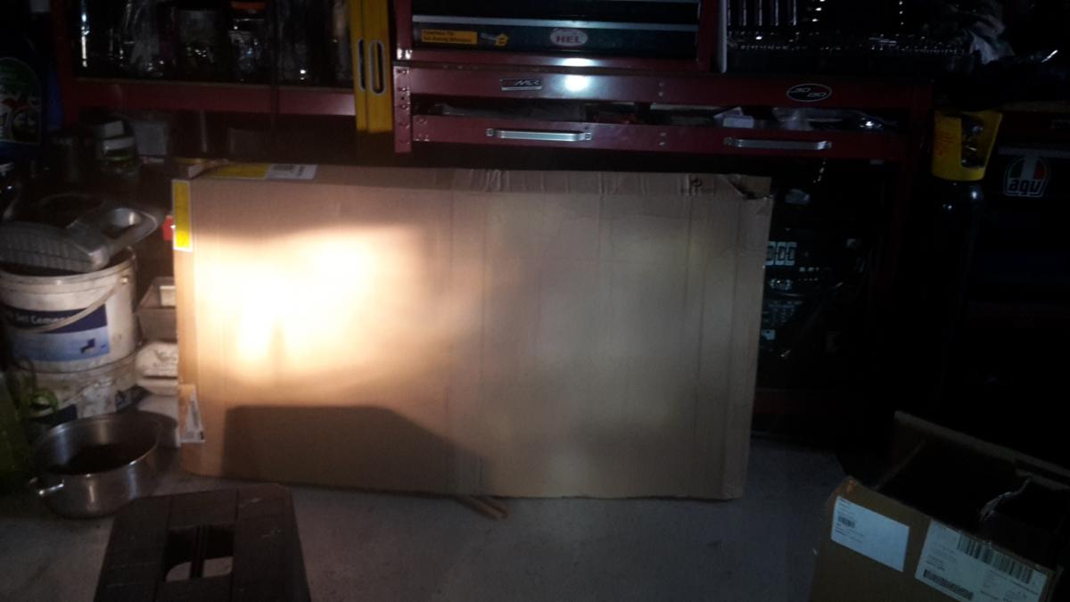

Not in my VRS but tried some H4's in my kit car and they were truly awfull!
Lovely bright white light when you were looking at the car from in front,but the light output on the road was shocking :(
Pic of the LED output on right compared to standard H4!

If you look on the toolbox you can see the LED side looks brighter than the standard bulb,but light output on the cardboard is a different story :(
That looks like a beam pattern issue (and might also be the cause of the luminous intensity differences {a true spotlight beam is always brighter than a true foglight one given the same bulb and reflector design}).

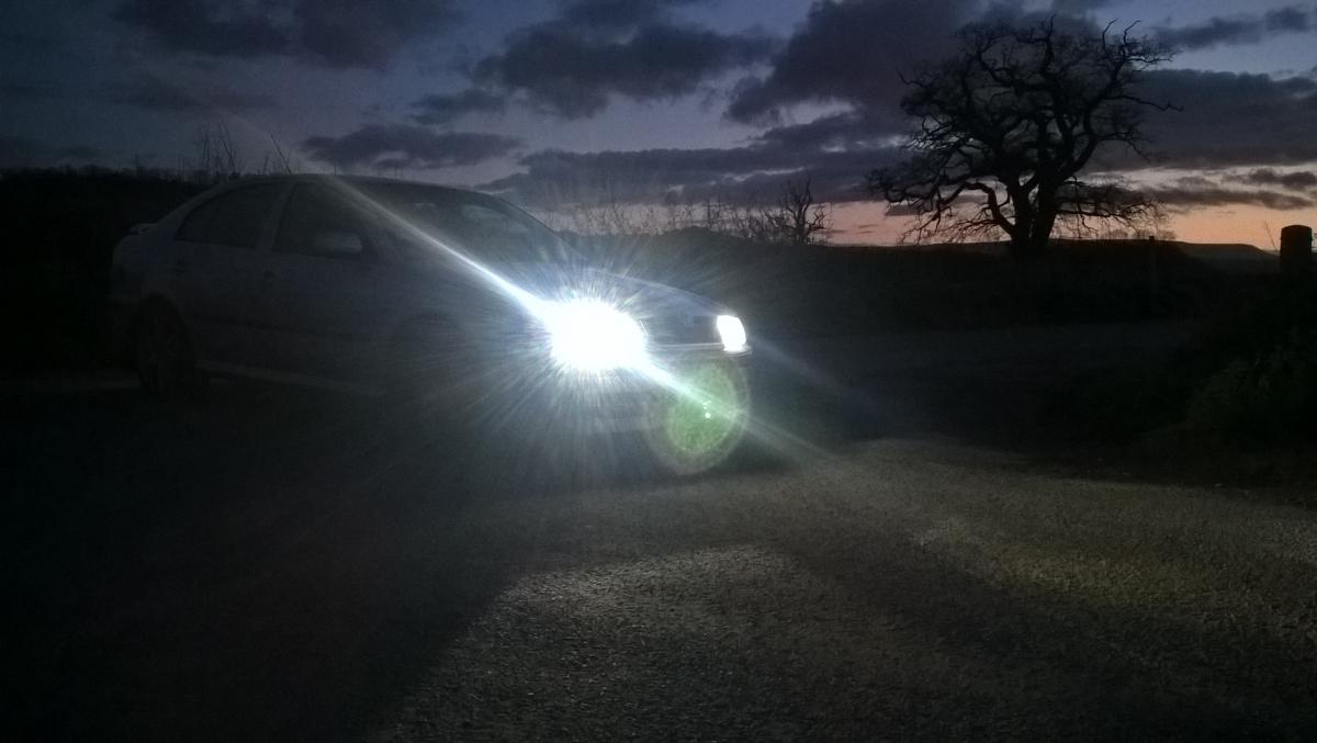

I have them on my Octy, got them from www.fourby.co.uk and they are fantastic!
(The yellow tinge at the edges is the front fog lights)

that's fantastic???   looks awful to me in terms of light spread, scatter and glare!!
It mirrors what I've seen in Civic headlights recently using the latest Phillips LED bulbs and confirms that, in my opinion, at present they aren't worth having.

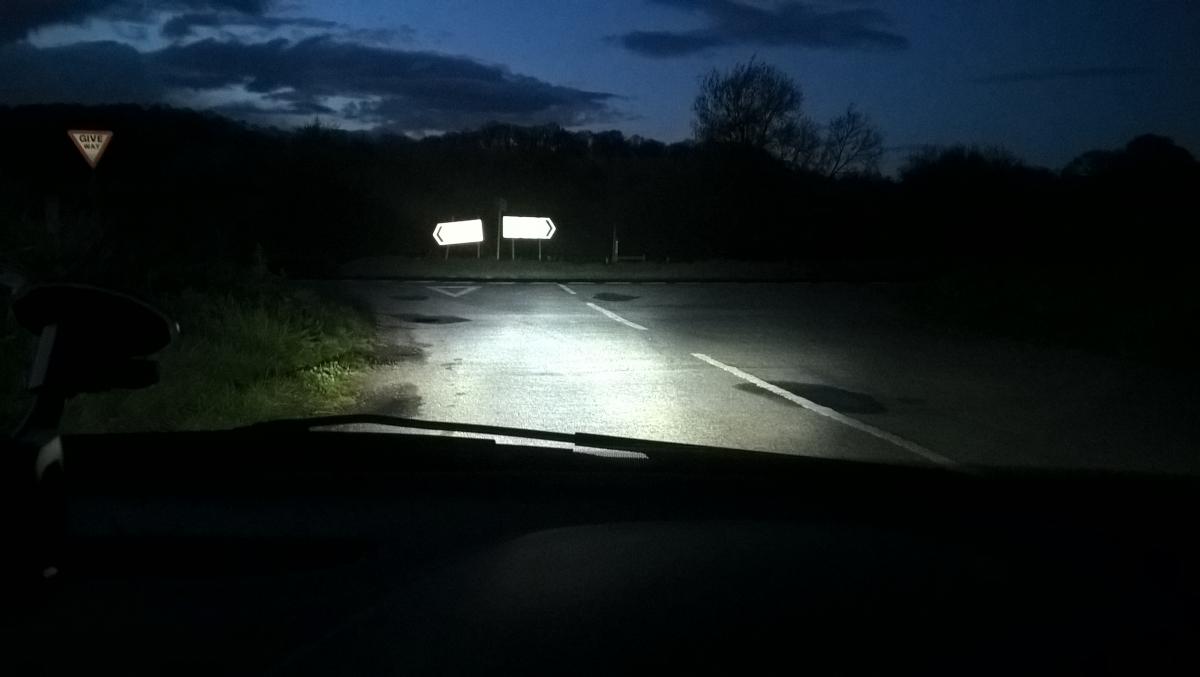

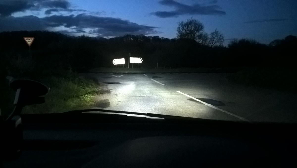

Compared to the Nightbreakers that were in there, they are miles ahead. Not been flashed by anyone, light spread is good, as is the range. The photo's aren't taken in the best location
They don't look to be matching my QX dip on range (they seem to run out about the verge the signposts are on?) and I'll get 3x that.
