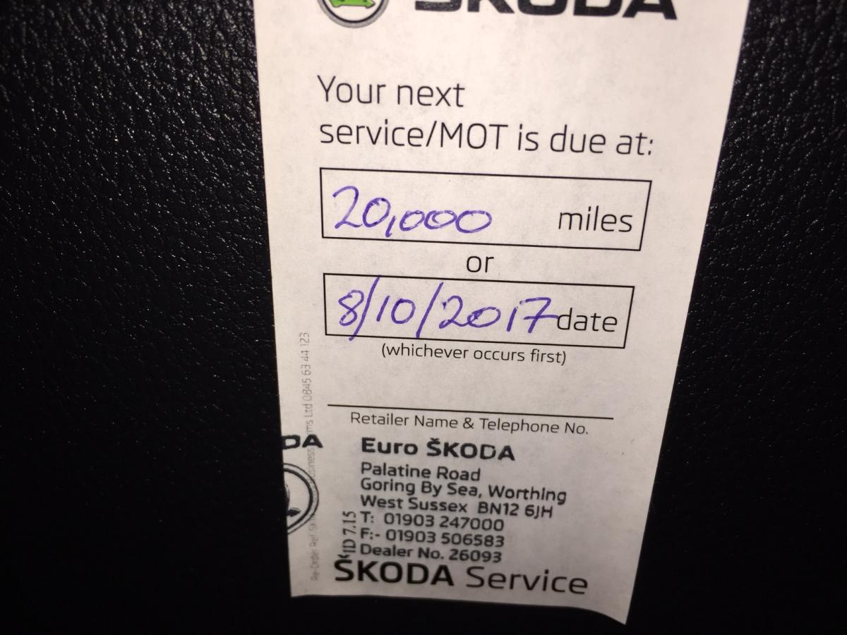

Had my Superb just over a year first service is due 18/10/2017, that is according to the attached sticker located on the side of the drivers side dash board, only visible when you open the door.
