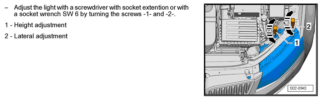

Don't suppose you know which one does vertical and which does horizontal?
Usually the vertical is centre top and the horizontal inside corner on the lamp.
If you look down on top of the headlight the inner adjuster does up/down. You really need to use a proper headlight beam setter especially for the Xenons for accuracy. Mine were poor and abit low set them to 1.25% and they are much improved and never been flashed so they don't dazzle. Didn't use vcds as only a small adjustment made and they were already set up, afs all working fine no errors.
Here's a picture from the service manual.
