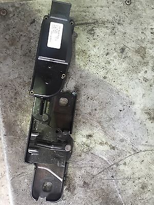

I had the boot closure motor fail on my twin door, once the boot latches the motor pulls the boot shut by a toothed bar, the teeth had worn out on mine so the motor was just spinning and not getting a grip on the bar, theres a spring that pulls the machanism back when the boot is opened, As a quick fix I found removing the spring and pushing the mechanism in to the closed position made it possible to for the boot to catch in the fully closed position althought as its permanently in the closed position it does take a bit more of a slam when shutting. I did this as I was getting the boot open warning and need to sort it until I was able to get a replacement which as it was a couple of years ago I could only find through a car breaker search website although I beleive they maybe on certain auction website! Hope that helps.
