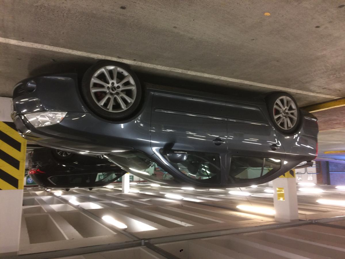

I went with the Vogtland 50mm setup. Very happy with it now
I wouldn't go too low on standard shocks, maybe 30mm max. Eibach Pro Kit is designed for standard shocks. Got them on my van and they have been great. Got the H&R -50mm Cup Kit on which lowered the VRS around 20mm but it has probably settled a bit more now. The H&R springs do seem to touch as you can see the marks on the coils but never had any noise. It's good to drive on these but if I was doing it again I would prob go for Eibach.
