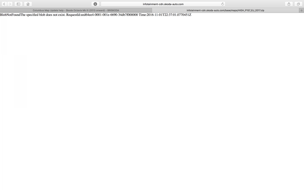

Can I ask what maps you downloaded? I'm due a update to my Columbus, I entered my VIN number onto the Skoda update portal and it offers me the 2017 maps but when clicking download I get a error message displayed on the website.
Any ideas people?

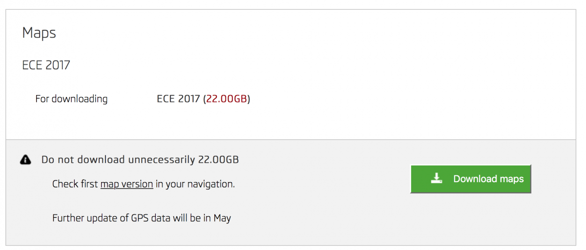

It's just a warning, if you have less than 2017 agree to download
I'm clicking download maps and then I get the next webpage showing the error with the text.
Is the 2017 maps uploaded anywhere else that I could grab them from?
