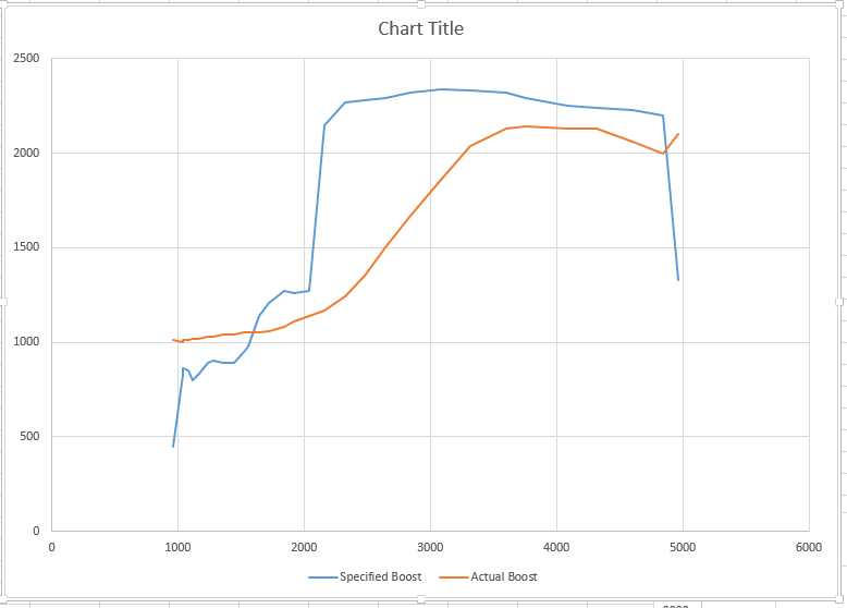

OK, so updates, but no fix.  Car was mapped yesterday, and it ran a stock 202bhp just fine.  On the new map, it will only peak at 220bhp, with 370Nm torque.   After doing some logging, it appears there is a significant boost leak.  I've asked if they'll send on the log files but the 2500-3000rpm stutter is at fault.  The stutter is a massive loss of boost pressure followed by a quick climb with a slight overboost and subsequent substantial underboost of between 200 and 300 psi.   The BHP curve mirrors this.
They suspect the DV, but it's just been changed.  They have recommend the D revision over the G, and by the way the car is driving, it certainly feels like it could be split, or there is a split pipe somewhere.  I think I can hear air escaping too, but it's hard to tell.  He mentioned that it could also be N75, albeit less likely.  From the specified stats and what he's seeing elsewhere, he's confident that it's doing what it should be (telling the turbo to hold xy boost) but the pressure is escaping somewhere...
We also don't think it's intake runner related, not directly related anyway.  We zip tied the flap arm open and did more runs and the problems persisted.

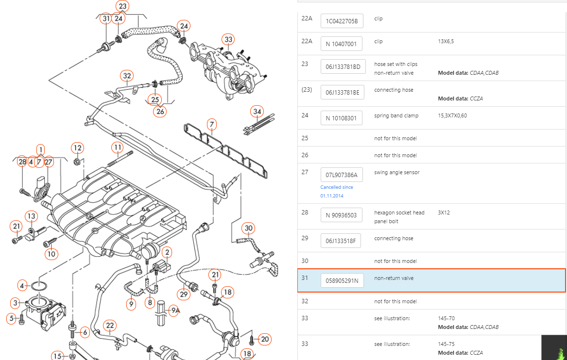

So, I need to check/replace the following:
  • DV (again, but rather than replace it, I might give the GFB DV+ a go)
  • Check valve (item 31 in attached picture)
    • This is my current priority.  It hooks into the DV, so I'm wondering if my recent PCV failure could have caused this to fail and leak? £15, worth a shot. Would possibly also account for the oil smell I get sometimes if it's leaking oily vapours from the PCV?
  • N75
I'll try to think about this a bit.  Strange that it is running stock boost levels ok, no signs of seepage or escape but you still have this stutter. No boost escape evident on logs in standard map?  Is it now (the stutter) more noticeable driving with the remap?
Mine seems to have the G diverter valve, some people seem to prefer them over the D.  G is (improved) diaphragm and D is piston from what I understand. D may have a longer service life but yours is brand new...
 I doubt that is the problem having changed it without improving the situation. But it is a bit of a difficult one this problem solving on your car,....
Edited by TheClient
The way I understand it perhaps the system is able to withhold the pressure for the stock map, but the extra boost needed for the map has made the leak more apparent.  The stutter is worse now, yes.  I'm of the opinion that whilst the G is prone to splitting due to it being a diaphragm, it does not leak from new like the D is prone to.  I could have simply replaced the old with a faulty new part, you never know.   I'll climb under and inspect it and check for any split pipes around the turbo, DV, and N75 BCS.

Thanks mate.  I can only guess that by the power loss/stuttering I'm getting I'd be loosing boost from a main pipe, not a smaller vac line.  I can't see anything from the top of the car, so I think this weekend's job is going to be getting under and inspecting the DV again and all the surrounding pipes.  Urgh, this car...
No progress as yet as haven't had time to climb under the car.  I've ordered GFB DV+ so no more split DV diaphragm woes.  I can't see any cracked/split pipes up top, but will inspect the IC pipes and vac lines around the turbo when I fit the DV+ mod.
When doing measuring on boost, should the n75 boost control shall 2.0% constantly?  I thought that was the actuation of the solonoid? If so, would a constant value of 2% indicate a failed/failing N75 BCS?
Not a super detailed curve and not the complete range, but this is what I got in a 2nd gear sprint.  It's smoother as even with the 'turbo!' feautre, there aren't lots of stats to go from.  What the f00k  is going on with my car...
Edited by planehazza
I see from my logging that the BCS isn't sat at 2% all the time, so it's definitely responding to commands.  I don't know enough about it to say whether it's working correctly, but seeing as I'm fitting a DV+ and the BCS is only £25, I'll fit a new one whilst I'm checking all the pipes etc.  Are the clamps reusable?
