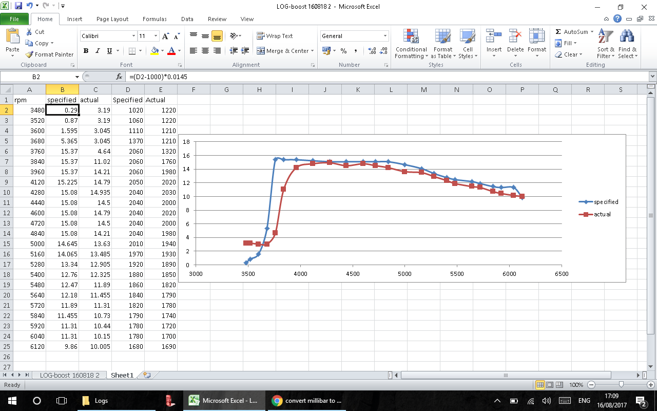

That is a big boost delivery vs ask gap. It wasn't like that when you looked at it a while back with standard maps, if my recollection serves me correctly. The remap has obviously pushed the required boost up, widening the gap, but looking at that boost delivered, it doesn't look like it would be even meeting stock levels of boost.
Looks dire between 2k-3k. No wonder it feels terrrible.

Yeah it's quite a gap.  I suspect that, as you say, the map is requiring higher boost so the difference is more noticeable.  I have a new N75 and the check valve ready to go in, and I'm picking up my DV+ today also.  The N75 looks impossible to reach so I think I'll just ask my trusted garage to fit it for me.  At least tonight when I fit the DV+ (if the rain ever stops) I can visually check the pipes. I'm let to believe that banjo bolt between the turbo and N75 is prone to unscrewing so I'll inspect that if I can see it.  Will I need to remove anything to inspect the waste gate arm and actuator from under the car? I seriously hope it's not that.

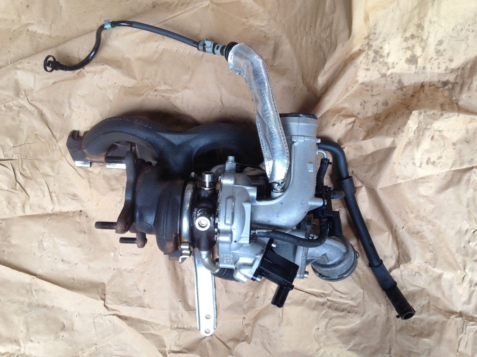

Looking at other posts the actuator air line may need to be pressurised rather than vacuum, to test movement and then see if it holds position without movement. If the Wastegate is closed by default I suppose it is unlikely to be causing underboost unless wastegate sticking or pretension spring not holding.

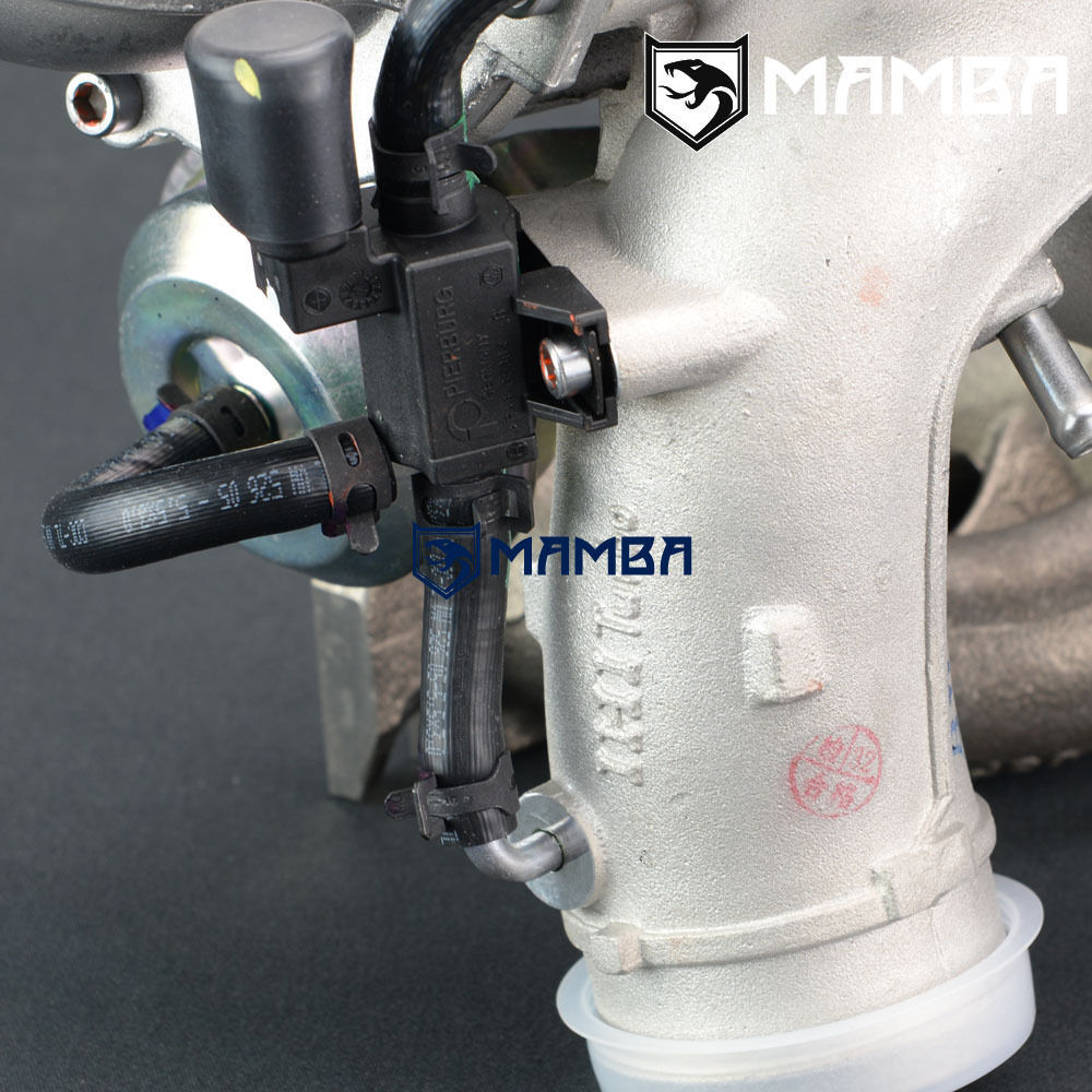

PS. again from memory, there are only 3 vacuum lines to the N75 and an electrical wiring clip. One of the vacuum lines goes to the actuator.
Edit: Photo added. Shows some visibility of the N75 and lines. You may find better with searches.

This is better.  The photo is orientated upside down to how it is actually mounted in the car though.

Thanks. I'm happy with the location and how to remove it, it's just going to be a bitch of a job to do... Ha.

Yes ok. It wasn't so much to tell you what it looks like or even where it is, it was more about actual connection detail and where any mounting hardware is. I just find it easier to have prepped before hand and have an idea where everything is because, as you say access is so bad and it is dark and difficult to see.
Like you say it may be better to let the Garage toil with it as even if you get the old one out, the new one back in installed maybe even tougher..
I don't think it will take that long to cool, the fittings you will be dealing with are on the compressor side, 30 min may do it but sense check all surrounding parts before starting any work.

Actually, you can see the check valve in the first picture you linked mate.  Where the black pipe at the top of the image meets the foil heat protection is where the check valve is.  You can't get them on their own according to TPS, so I've got the valve and heat shielded pipe.
Looking at the same image it may be easier to disconnect the bottom N75 pipe from the turbo, and remove the N75 with all the pipes attached.  This way I can much more clearly inspect them for splits.

Next job over the weekend is to replace the N75 valve and that check valve and go from there.  The sooner I get a pressure/smoke test done the better...
The N75 fit  looks simple enough on the bench! It does look a bit of a pig in the car.  Whatever way you go, you are going to have to remove the three lines at either the N75 or remote ends. It is a question of what works best.  I reckon the least accessible is going to be the actuator end connection, so I'd leave that on the actuator end if you can, remove at the n75 end instead.
The other two i'd probably remove at the far ends if you can and leave on the N75 you are removing (then swap over on the new n75). One of the remaining connections is just above the diverter valve, looks accessible and the final one just down from the air inlet pipe junction may pull down especially if you have a hand pushing it from above as well.
That is how it looks to me but of course often you have to adapt when doing the job.
There is scant room in there for pliers hands etc. Good luck!
Yeah I see what you mean.  A two second job off the car, but a pig's ear on it.  Need to book a trip back down to Shark to A) chase up that STS device again, and b ) get the car leak/smoke tested.

well here's some data from some 3k 3rd gear pulls. Seems to be matching spevcified better now...
